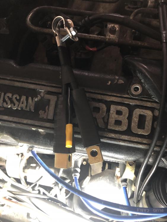

1) attached is pic for the battery connector i used.  i measure ohms on cables with out having this installed and i get 0 ohms almost on all connections (on screw below batter tray, on intake manifold screw, as well as the starter screw).
after installing the connector i do see ohm reading of about 1~5 ohms depending where you touch.    Battery leads have been cleaned very well w sand paper.

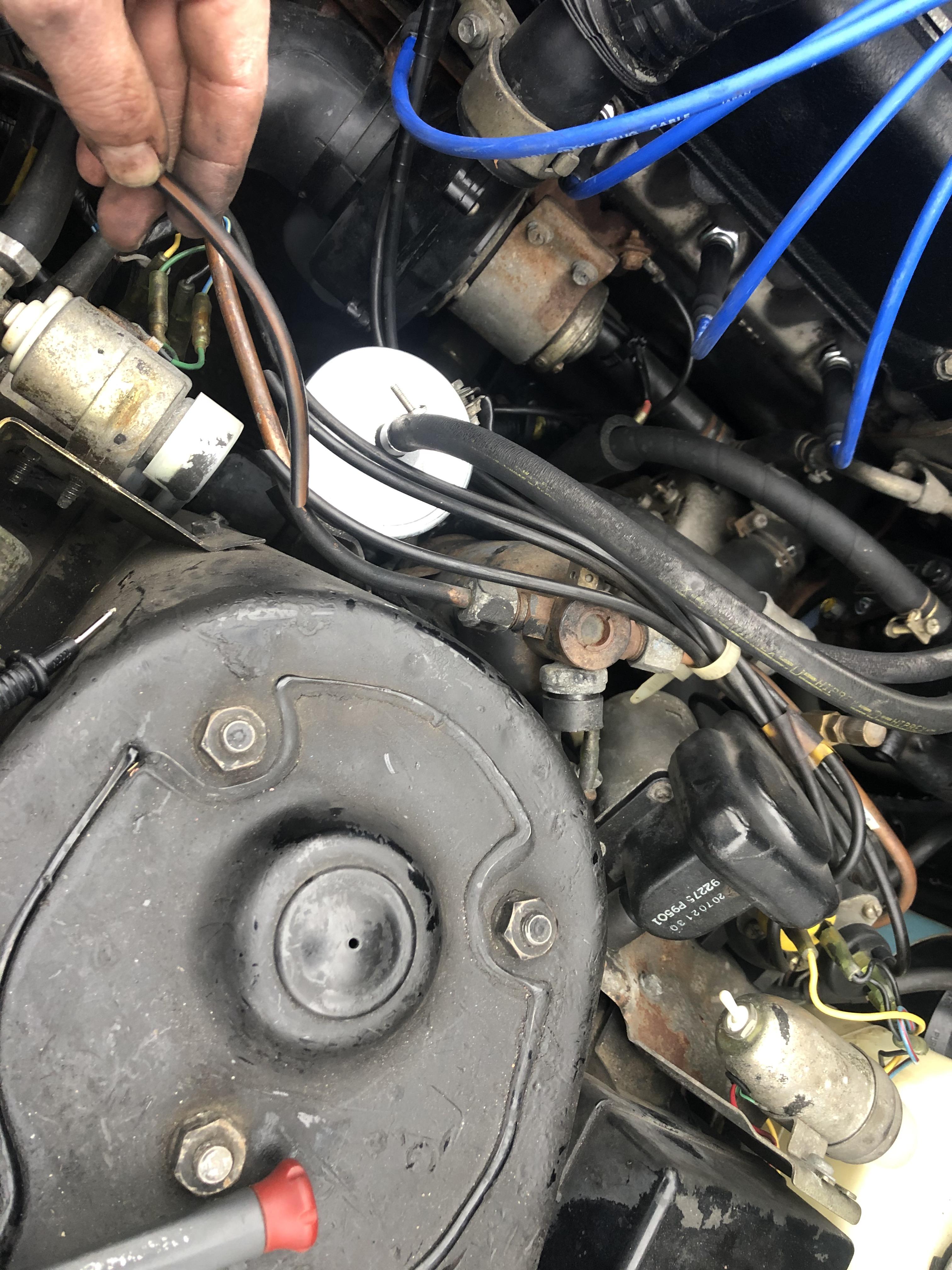

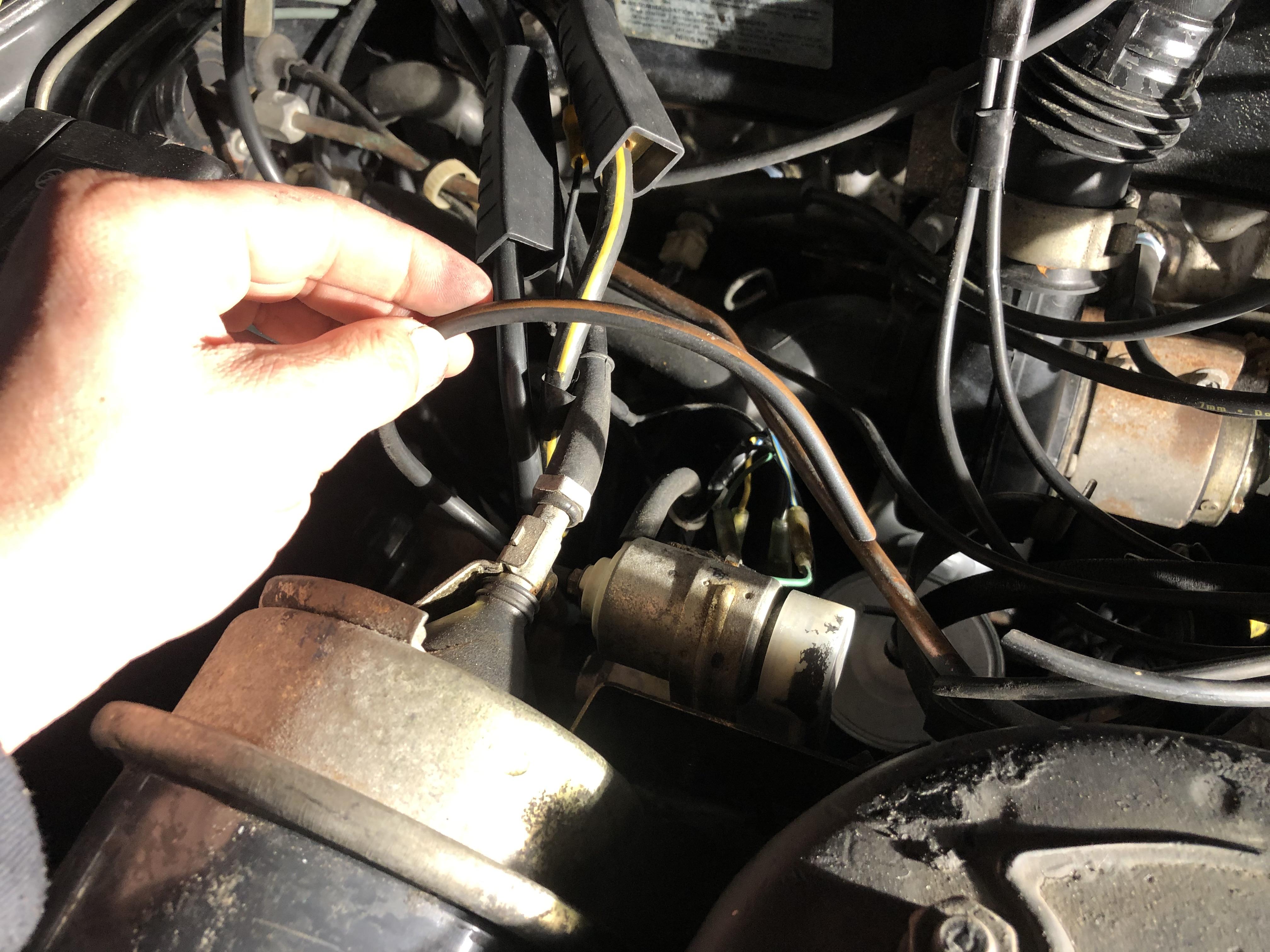

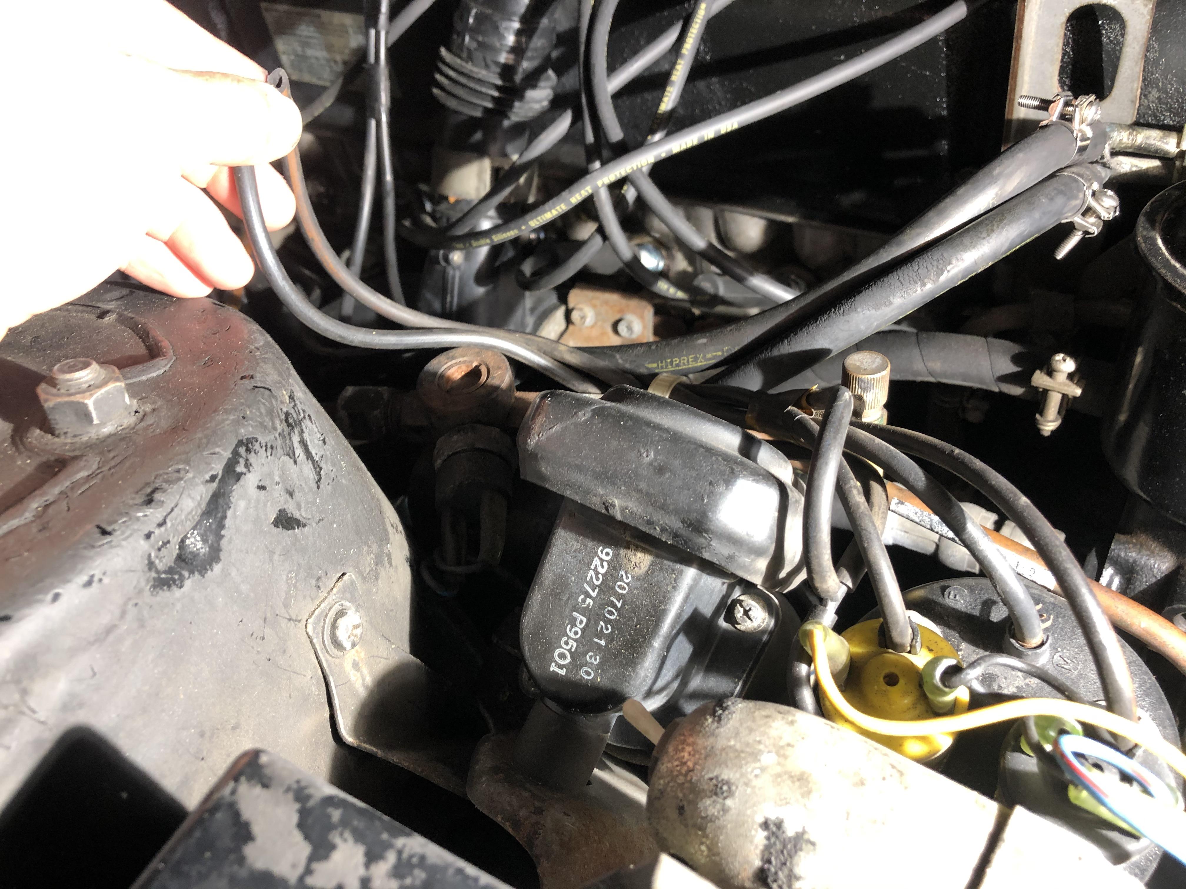

4) Cut wires (black , Black/Brown).  its obvious they were cut w a sharp object as they are very clean cut

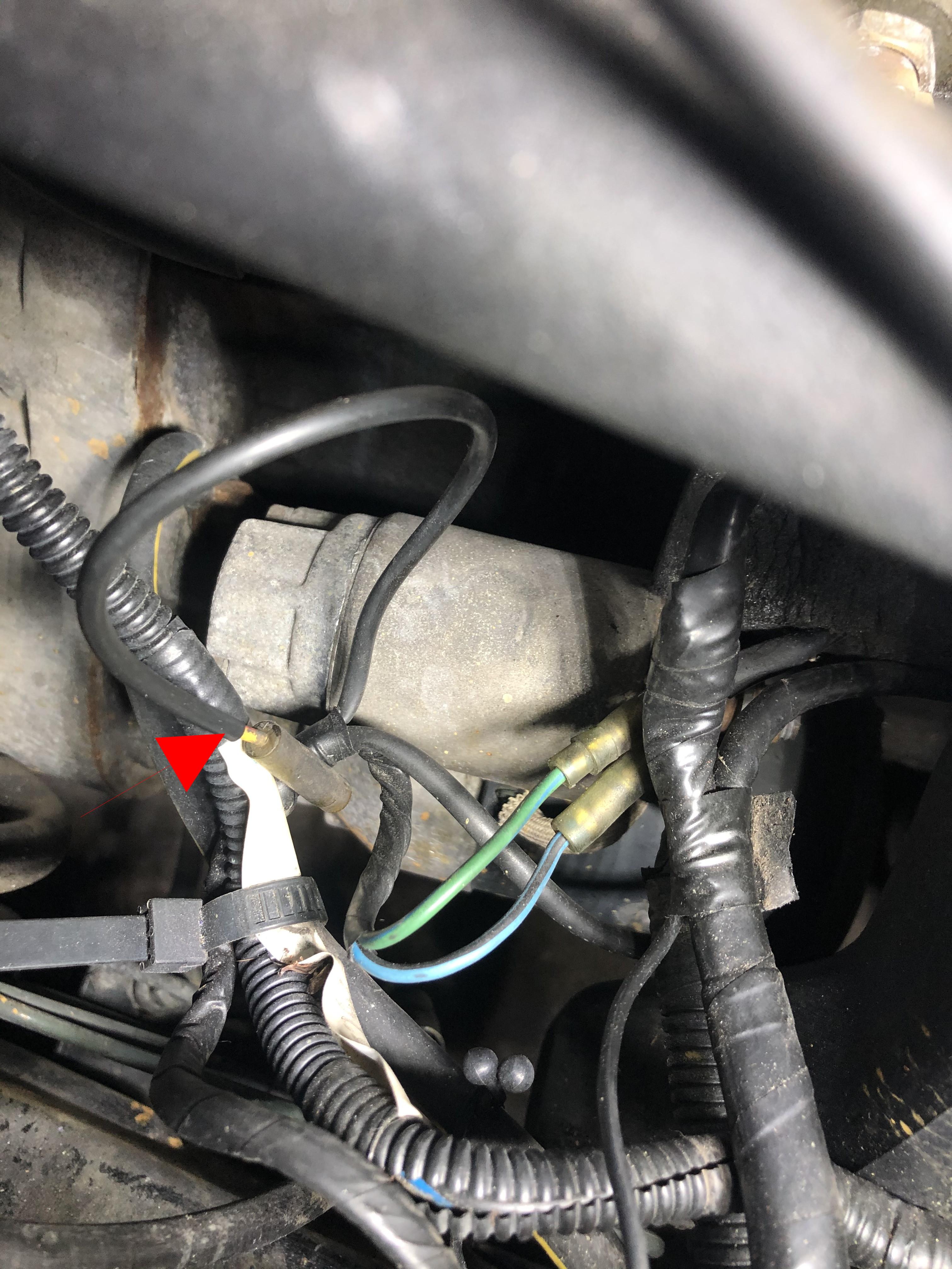

5) what are these 2 sensors?

Zed, do u have answer for 3 , 4 or 5?
