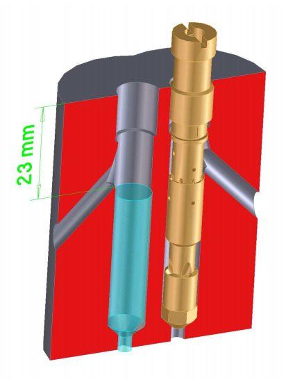

Check fuel levels.
- Remove one main jet assembly in each carb.
- Measure distance from top of fuel to the bridge where the main jet screws in.
At 23mm, the fuel will pour into the carb throat.... not good.
At 25mm down, the fuel will slosh into carb throat on bumps and such
29mm down is recommended.
31 to 27mm is a range for tuning.
1 minute ago, 240260280 said:
Check fuel levels.
