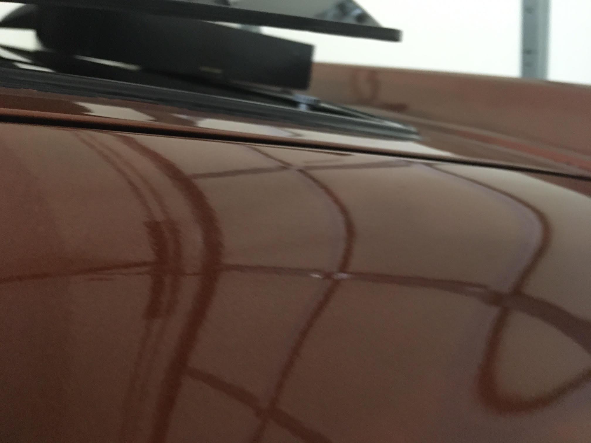

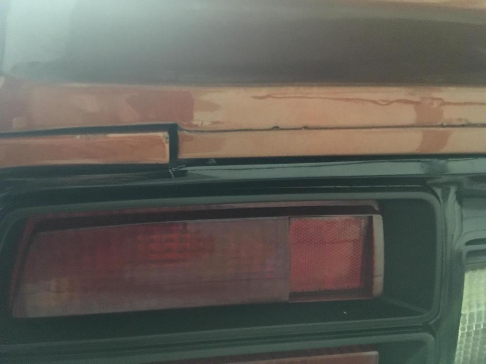

The latch is connected to a patch panel so that might be the root cause - the panel installed improperly.  That said, with the hatch closed, the middle of the hatch seems to slightly bow out when compared to the body lines.  I also just tried to close it with the windows down and to no avail - it will just sit open on the seals.
