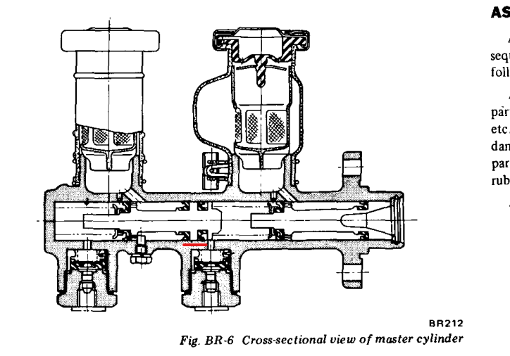

There are four seals in the MC.  Two to pressurize the front and back systems, one to keep them separated, and one to hold all of the fluid in the cylinder.  Seems like your separator seal is not separating.  Not sure of the actual dynamics but that seems reasonable, to me.  Looking at the drawing it seems that fluid is pumping back and forth to various places with each pedal press.  In your case it might be that the port to the front reservoir is clogged and fluid is getting forced past the separator seal (had to take a guess).
Short would be - your MC is bad.  Best guess.  I found that some of the hydraulic parts I bought at the parts store had machining grit in the bores.  Best to take them apart and clean them before installing.
