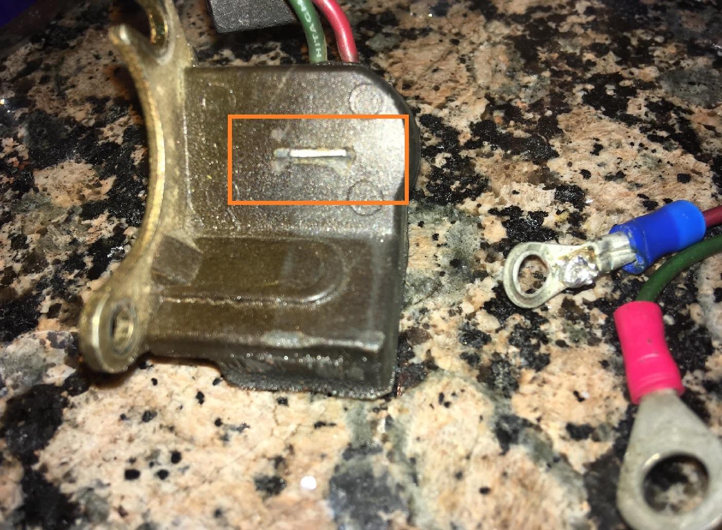

Reluctor wheel grinding against the pickup face is never a good thing, but before you convince yourself that the pickup is dead, you need to ditch the "continuity" reading on your meter and use Ohms.
The spec from the FSM is 720 Ohms. I don't know if that's high enough of a resistance that the "continuity" scale on your meter might not pick that up. In other words, the pickup coil could be just fine but resistance of the coil may be high enough that your meter won't consider it a connection (and won't beep on continuity).
I was wrong, it seems that it's the magnet peeking through and not the coil being ground down:
That exposure is normal, but the wear on it is not.  It's the pole of the magnet, the piece that the coil is wound around, I think.  Don't forget that the grinding of the wheel on that piece will cause heat too.
But, overall, if you got no continuity, you got no sine wave, and the ignition module won't produce no spark.  It ain't gonna work.
Might as well take the distributor out and disassemble it to see where the wear is.  In a prior thread that I can't find somebody had a worn shaft and we talked about Redi-Sleeves and other ways to fix it.

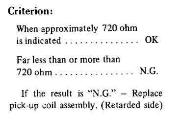

Update: My friend has a distributor I can have but said when he measured the pickup coil with a multimeter it ready around 760 ohms instead of 720.  Would that still work?
Should work fine.  I think that Nissan just didn't set a clear tolerance on that 720 number.  Approximately and far is too vague.  Edit - actually they were vague for the ZX's also.  The ZX uses a different type of coil so the spec is different.

Gotcha.  I wasn't sure how 'approximately 720 ohm' Datsun was felt comfy with ,haha.
