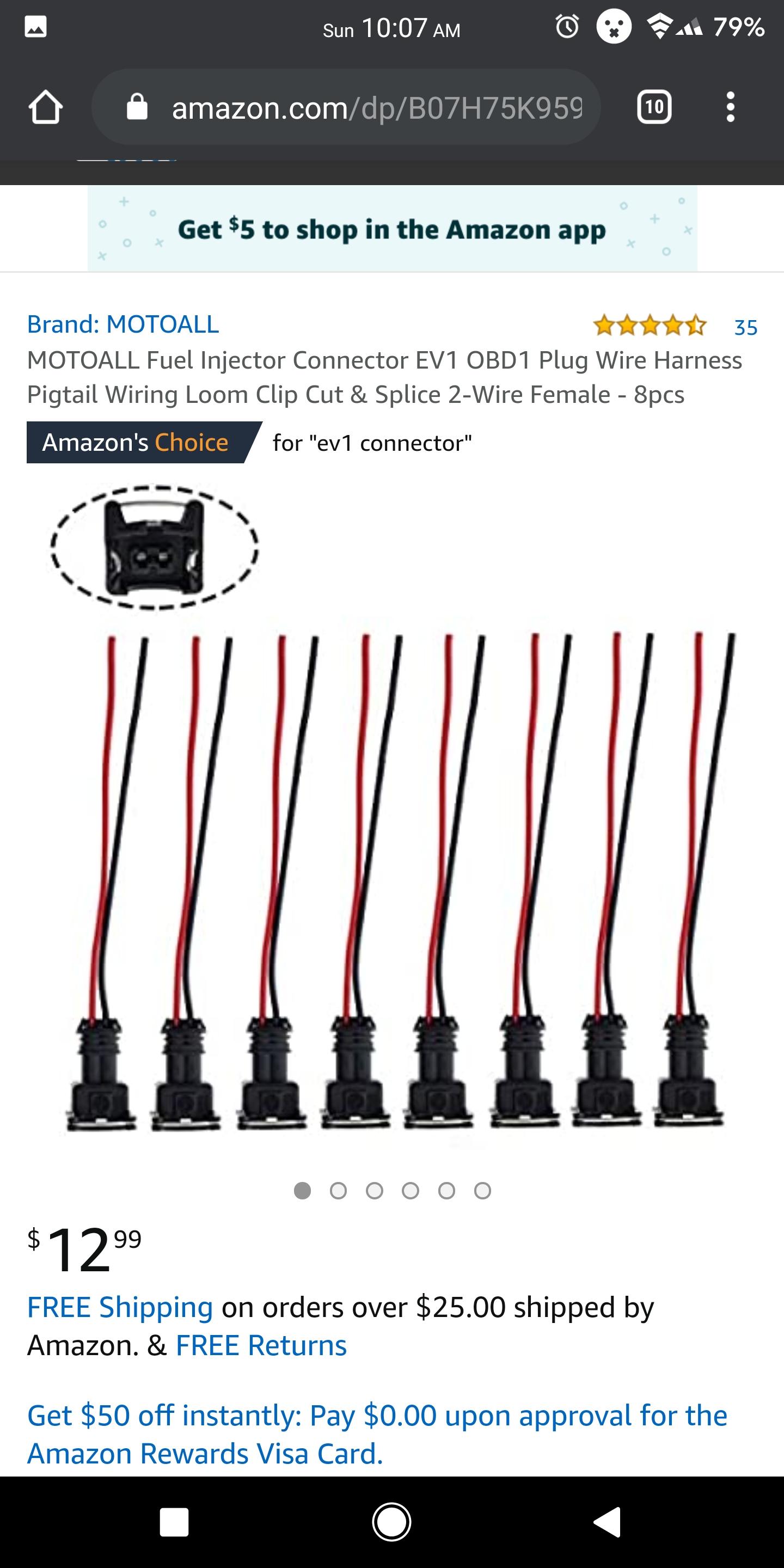

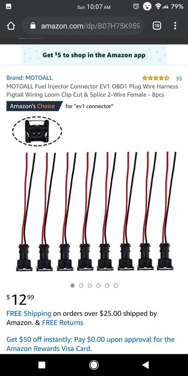

Are these the correct injector harness?

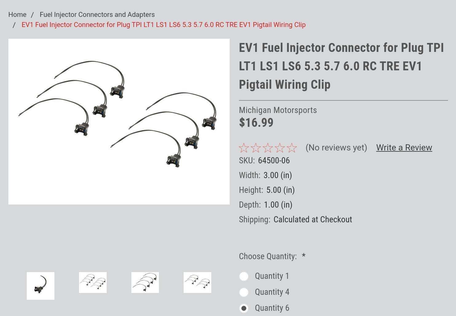

Yes. They will fit the original 280Z EV1 injector.
I used something similar to these
https://www.michiganmotorsports.com/fuel-injector-connectors-and-adapters/ev1-fuel-injector-connector-for-plug-tpi-lt1-ls1-ls6-5-3-5-7-6-0-rc-tre-ev1-pigtail-wiring-clip/
They are shorter and give a little more room to click them onto the injector.
So shorter ones are better to go with?
Sent from my Pixel 2 XL using Tapatalk
It just makes it easier to fit them to a couple of injectors, but it doesn't effect the function of thr connector. Any EV1 connector will fit.
If originality is not an issue then I would stay away from the original EV1 connector. They had a difficult spring release mechanism and are a pita toget off the injector. The ones you have in your link and the ones I posted are the quick release "squeeze" type connector and must easier to remove.
Ok cool.. I'll go with the ones in your link. My engine is skipping assuming from the previous owner splicing the harness.

Hey@EuroDat
On those ev1 connectors, both the wires are black. Does it matter which wire I connect to the other that's on the harness? Like is one a pos and neg?
On these injectors it doen't make any difference.
