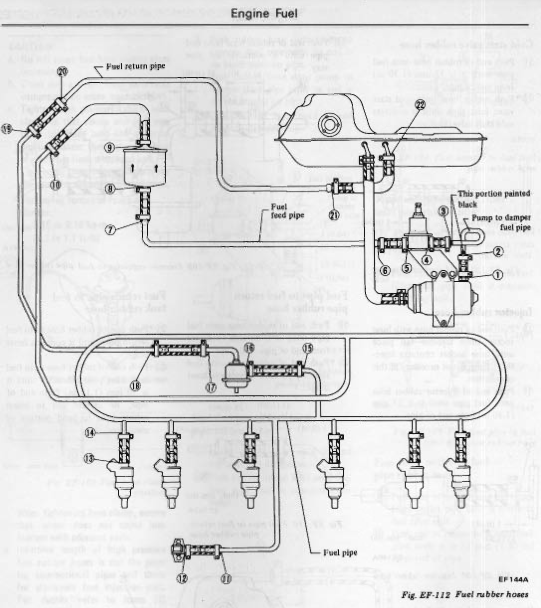

Everything that you have done looks right. Very thorough.  The one thing that is missing is an actual fuel pressure number.  You can have squirting at 2 psi, which might not be enough to keep the engine running.
It is also possible to connect the hoses to the rail backward.  This will give pressure between the rail and the filter/pump but no fuel flow through the rail.  I would confirm that the hoses are connected correctly and measure fuel pressure.  If the rail is connected backward you'll get maximum pressure from the pump, about 90 psi. if it's aftermarket, but no fuel to the injectors.
On the 78 model the easy way to get power to the pump is to disconnect the oil pump sensor and turn the key to Run.  The pump will get power.  It's a flaw in the system design but convenient for testing.

Could the injectors and their hoses still have old bad fuel in them?  Looks like you cleaned the tank and have had the pump running.  But if you look at how the rail is set up the injectors and their hoses are dead zones as the new fuel passes by them.  Don't know how long you've been trying but it might be that you just need to get some good fresh gasoline down to the injectors.
