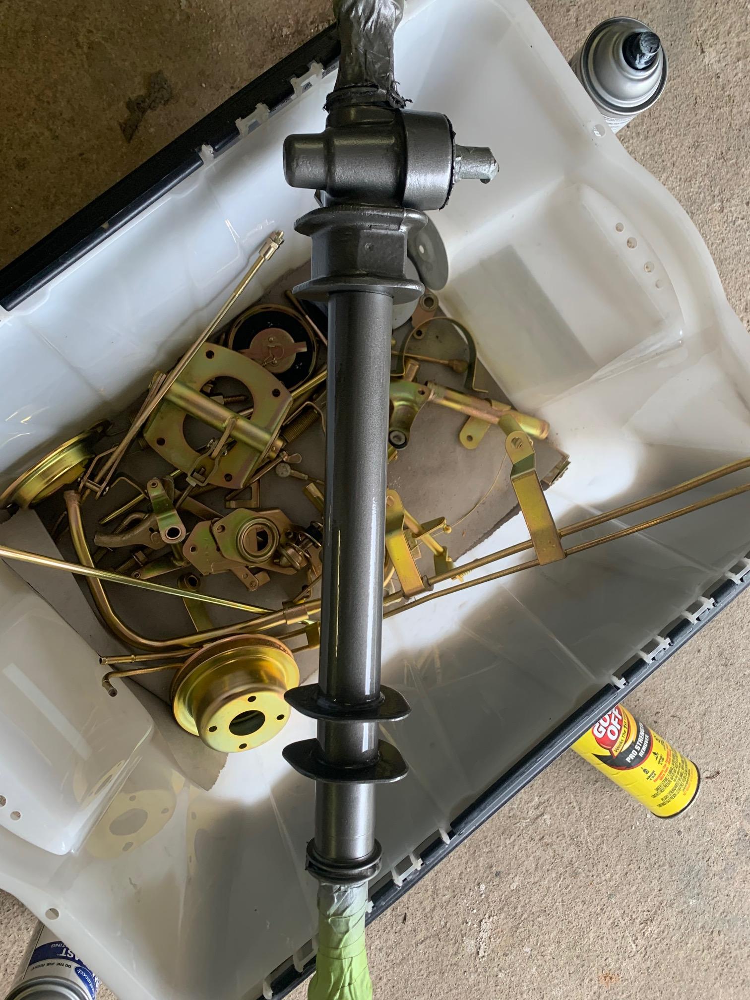

Was going to go black for all the shafts but I really liked Motorman's cast iron color from his thread so I copied that the best I could. Left the driveshaft chassis black
