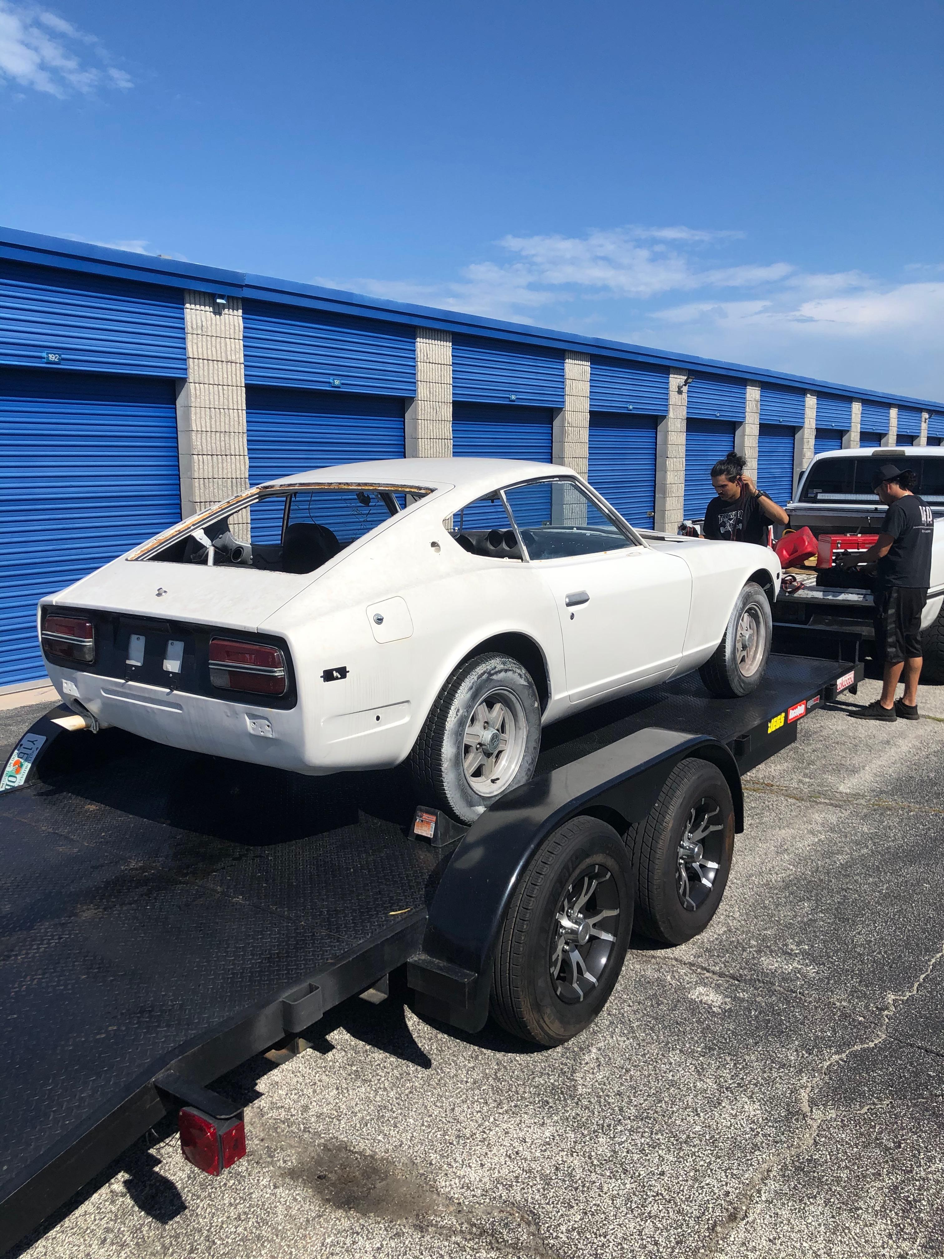

May 26, 20205 yr Author comment_600200 Well, I sent the white one off to paint and engine swap. I'm also swapping in a five-speed tranny. It'll be a glass and engine out paint. I'm going with silver (901) as was the original color. I'm spending a bit more than I wanted to, so please don't tell my wife. Edited May 26, 20205 yr by wadelester Link to comment https://www.classiczcars.com/forums/topic/63926-1971-240z-driver-build-advice-requested-please/?&page=2#findComment-600200 Share on other sites More sharing options...
