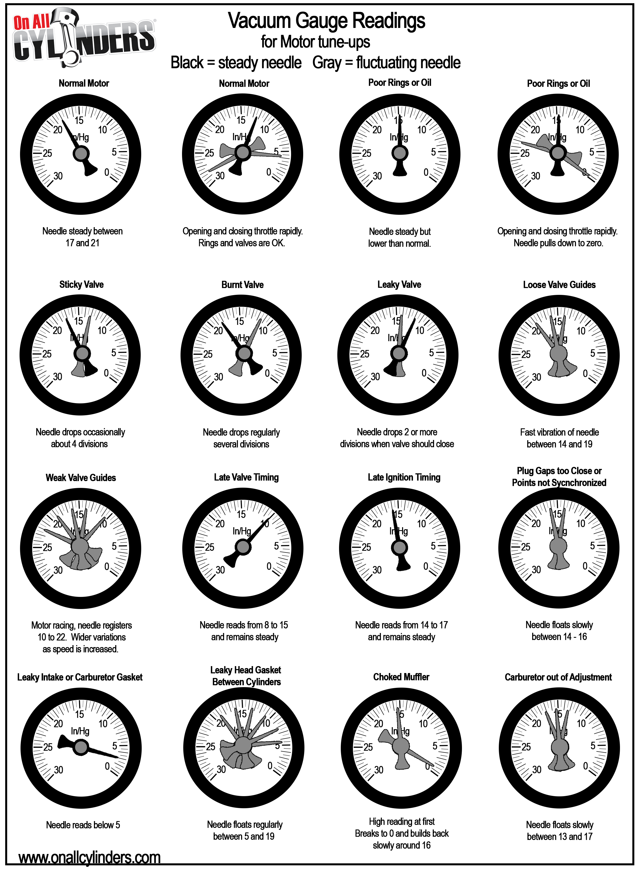

Vacuum test! Very telling... Fast flutter  at 12.5-14.  Looks to be loose valve guides and not enough vacuum?
When I quick throttle it jumps from 0 to 21.  Gotta get one of these.  They are pretty cheap. Any recs, will the $25 one on amazon suffice?

OTC is nice, harbor freight is cheap, sure either is fine. you have to let the engine warm up some, same with compression testing, warm engine will give better results. Typical to be 16-22. Altitude effects it as well, higher alt, lower vacuum. I don't think you have a smoking gun yet. Try smoking the engine for a leak test. I prefer this to the spraying flammable fluids around it. Block off the throttle body with a foam cup, get a stogie and blow smoke into a pipe connected to the intake manifold (brake booster fitting works well). look for smoke. Sneaky things like PVC or EGR and create lean runs. missing or damaged fuel injectors rubbers, cracked hoses around intake. Smoke will find them the best. For EGR you may have to remove the valve and just make sure its clean and that the diaphragm is operational.
Bump initial lead to 15 degrees BTDC. Check vacuum again with HOT engine. Report back.  Bet you see 18 inches of mercury on the gauge.

I’m back... I advanced the timing and got way better vacuum (19). It’s pretty advanced though, could that be future problems, or sounds good though....  I did a smoke test and no leaks!  I enrichened the AFM like 12 teeth. Seemed like a lot, but I passed smog, and the car is running pretty good on the low end but loss of power on the high end. I was reading around about the temp sensor mod and how some were saying that a 78 ECU could run lean with age... considering doing the mod to try it out.
