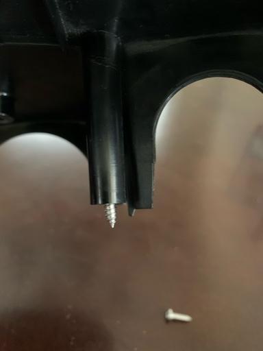

ahhhhhhhhhhhhhh how strange i literally just did this a couple hours ago. There is a m3 bolt near the steering wheel, and an m4 bolt at the underside of the key tumbler. I think i used some small #6 screws for the 4 other ones that go into the plastic. I did not torque them down all the way, i was scared it was going to ruin the plastic on the other side.
For the m3/m4 i had to use a washer to get it to hold to the plastic. I should have done it months ago, it looks great.
I used some zip ties to hold the wires to the steering wheel column.
it seemed to be a bit more coarse than a machine screw would be. I stand corrected, based on https://www.boltdepot.com/fastener-information/machine-screws/machine-screw-diameter.aspx
I was using a #8 screw.
overall height is 0.6"
diameter is 0.165"
length is ~0.5"
Edited by heyitsrama
Ok I went with #8x5/8” pan head Phillips and it comes out enough at the end to fully engage without any worries and is snug when tightening Case closed
