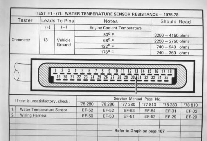

What is the reading on Pin 13?  We need numbers.
And what color are your injectors?
When the engine was cold (50-60f) Pin 13 showed 3.445 Kohm
As far as color Whitish plastic, greenish sleeve

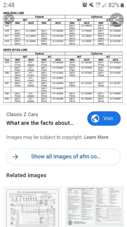

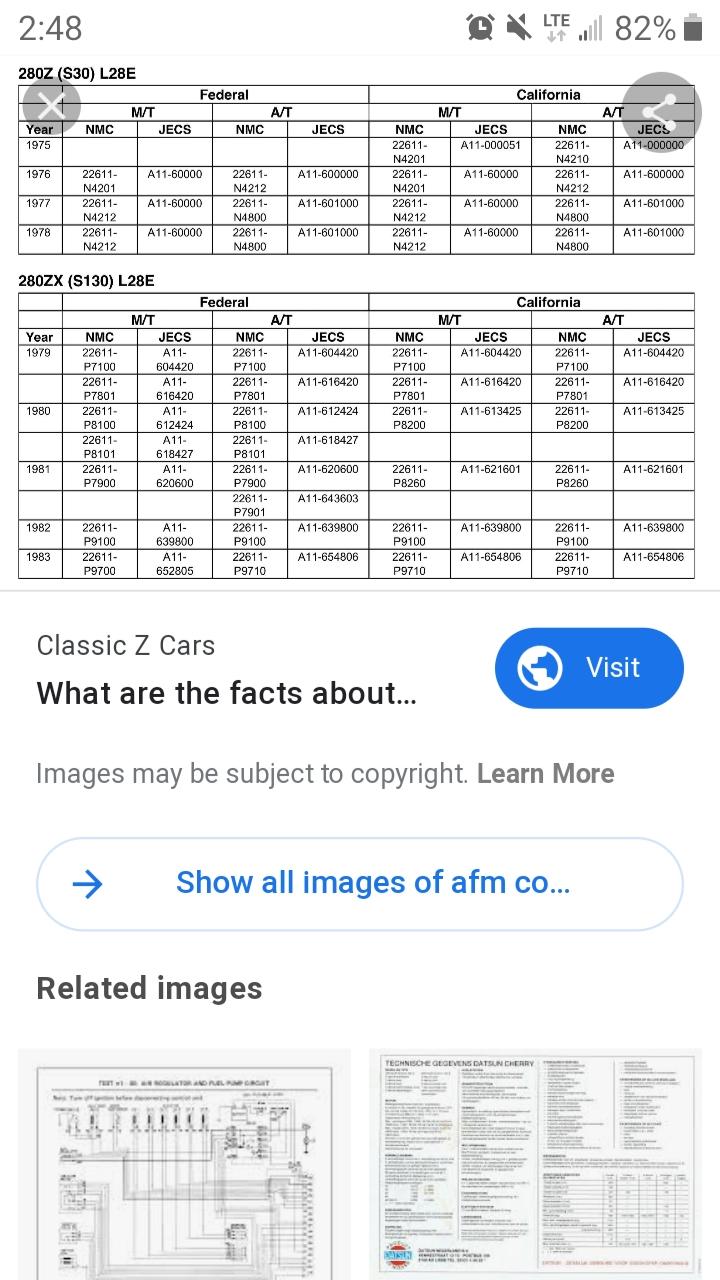

1 hour ago, Cyrillink said:
@Zed Head and @Dave WM
So i narrowed it down to not getting enough air into the system. My AFM  Idle screw wide open and my IDLE screw is wide open.
Should i use the little screw on the side of the Throttle body? I cant find any information on it and what it should be at also the butterfly is completely sealed when i am not hitting gas. Just curious, really want to finish her up.
I went back a few posts and see the part about how the car ran well when there was a gap between the AFM and the throttle body.  If I read it right.  The fact that the idle adjustment screw doesn't raise idle speed implies that your AFM vane is stuck.  Take the black cover off and see if the counterweight moves when you use the throttle.  It should.
And you should set the AFM idle screw back to where you started with it.  It's not an idle speed screw, it's an air-fuel ratio adjustment screw.
