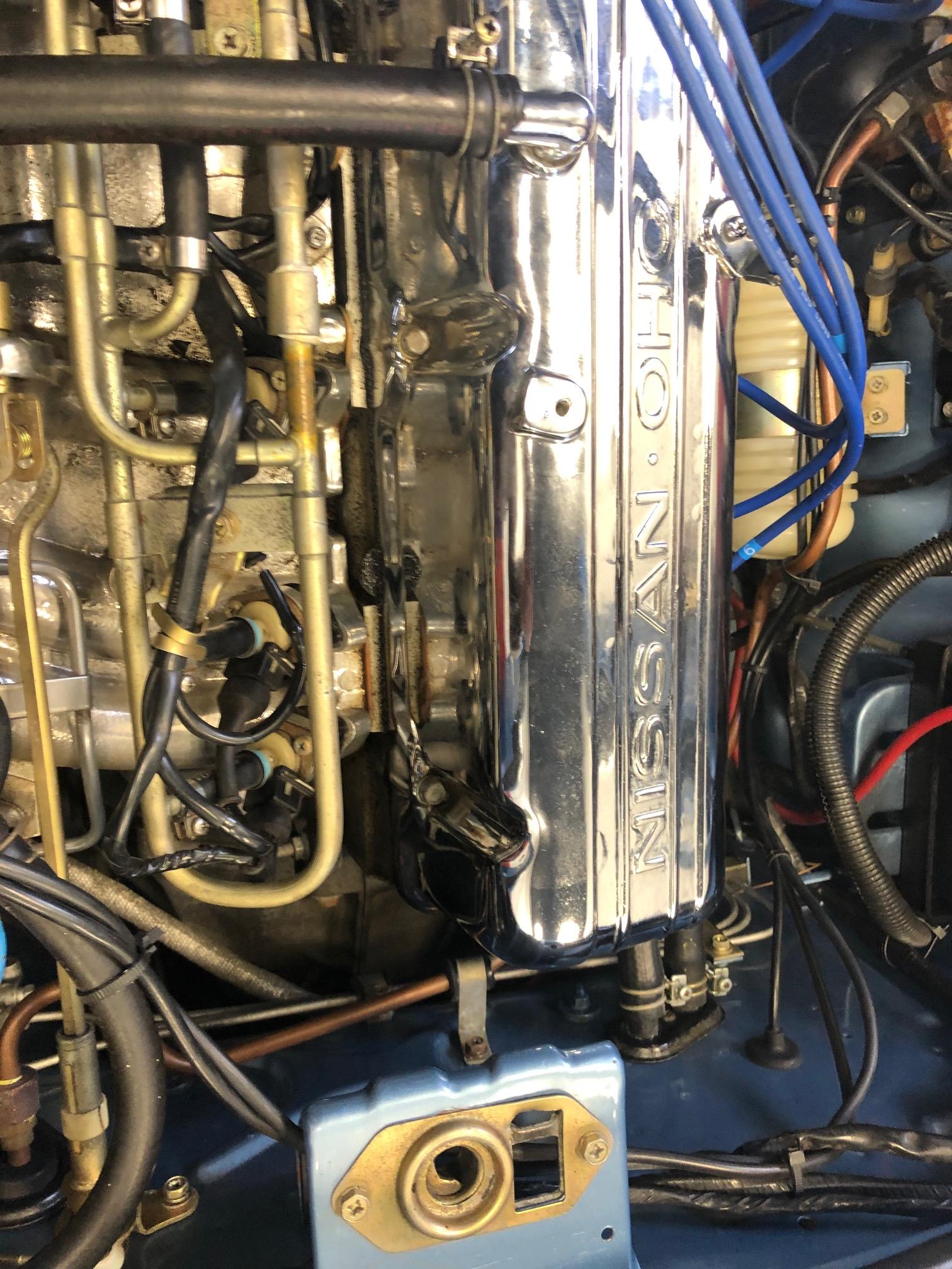

Not to throw you off the troubleshooting track that's been laid out, but is there a chance that the guy who worked on it before you removed the injector connectors and cross connected them, or in other words, put the wrong connector(s) on the injectors?
Sent from my Coolpad 3310A using Tapatalk
Interesting Idea, let me double check the correct wire pattern
Checked the injector harness looks to be plugged in correct
The injectors all open at the same time.  You can switch plugs at will.

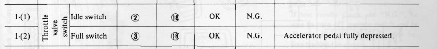

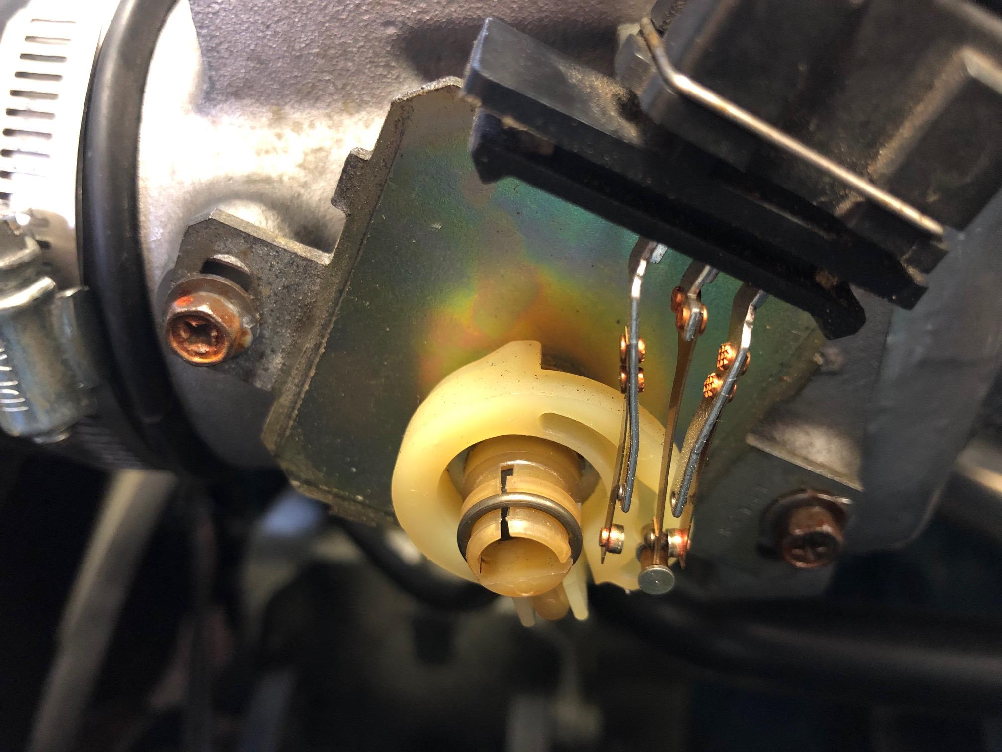

The throttle valve switch is a possibility.  Stuck at wide open.
Another piece in the meal.

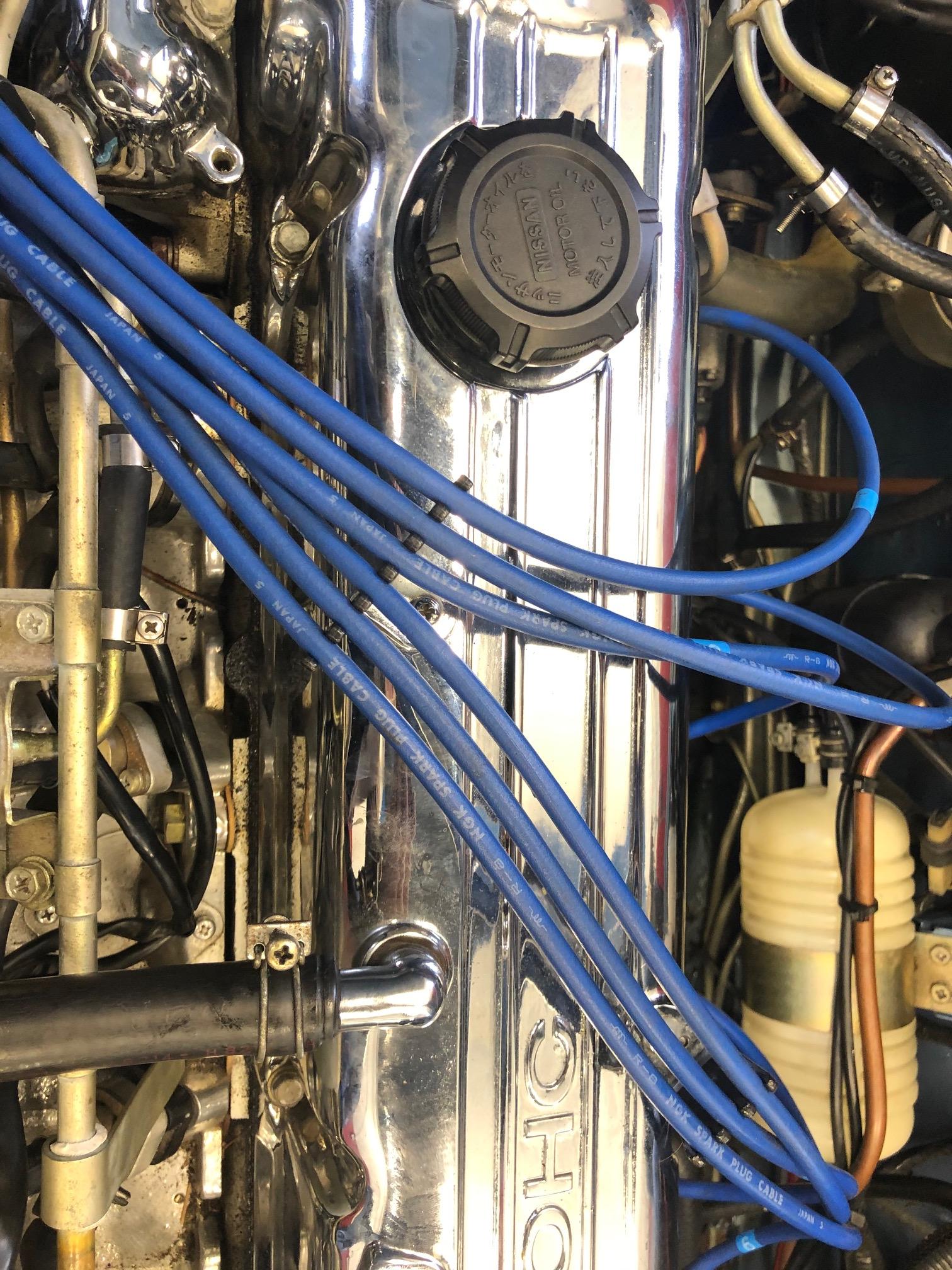

also, did you ever try removing the oil cap while it was running? normally it should stumble and perhaps die while idling. This will help find if the mixture is set incorrectly as well since unmetered air into the system in a correct working system tends to lean out and die. Again this assume all the EFI is in place and properly hooked up.
