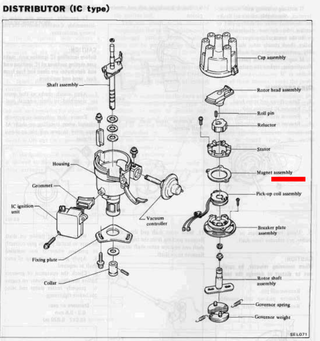

The ZX distributors are known for breaking the magnet under the stator ring, and for bad bushings that allow too much play in the shaft.
