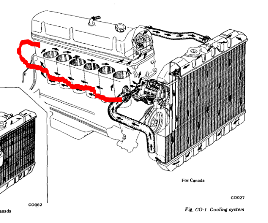

Is the engine "nose up" or nose down on your engine stand.  The pump will fill the engine with coolant up to the thermostat if it's nose up.  If it's nose down there could be an air pocket at the back of the cylinder head.  With a heater core installed that air pocket would end up there, instead of in the head.  Maybe you can "burp" it from the heater core supply port.

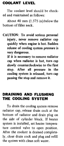

Have to say though that the FSM is way behind in 1976.  My coolant level sits at the top of the filler neck after some heat cycles, with the reservoir working right.

Actually, just remembered...if the heater core lines are looped, aka bypass mode, the coolant can make a loop through that path without entering the radiator.  At low RPM there might be enough flow through at path so that the thermostat sees very little.  Is your coolant port blocked or looped?
I was careful to remove slowly so as to bleed off any pressure build up, Did have some overflow, but not explosive like superheat water converting to steam. Before it would literally blow out maybe a gallon of water and this is when the rad was not even hot. On my last fill up I just kept adding water while it was running (after it blew out a bunch) eventually topping if off. I thought I had been doing it this way all along, but seem like this last time it worked.
looped
5 minutes ago, Dave WM said:
I can block them to see if that matters (will just clamp the hose).
It's been show to cause overheating.  It bypasses the radiator and the front half of the head.
