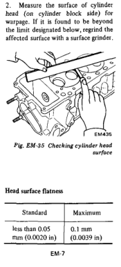

I got curious about the need to shave or skim the head if it was out of spec. for flatness.  My head was at the limit, bowed up in the middle, so I put it back on with no head gasket and tightened it back down to see how much it would take to make it flat again.  It didn't take much to close the gap.  I'm pretty sure that the How to Rebuild book uses a wider range also, I seem to recall .007", not the .004" that Nissan uses.
The resurfacing has always bothered me because it leaves the valve train spec'ed to a different surface than the bottom of the head after skimming.  The valve train is still warped.  But if you tighten it back to flat using bolts then the valve train should straighten out also.
Just a thought.
if I had to machine it flat I would have them do both sides. I have a head saver shim kit ready to go.
IIRC read that shimming (as in your case .001 shims on far ends to pull the bow down in the middle) followed up with a heat cycle was something that was mentioned. Need a oven to heat it up, again cant recall the exact temps 250f maybe? hold it there for hours then let cool off. Something about even SKILLFUL use of a gas torch with a flame spreader to gently heat the entire head. Seem like the oven would be better for long term setting (hours then a cool down).
Agree with not liking the idea of skimming and shimming etc...
Fingers crossed I don't have to cross that bridge.
I think that the process is described Honsowetz's or Monroe's book, or both.
I've thought that  torque plate would be best for machining.  It would take some ingenuity, maybe counterboring or even threading the bolt holes.  But then you could flatten it via bolt torque to the top surface and skim just the odd high spots on the mating surface.  When it's bolted on to the block it will be the same as on the torque plate.
