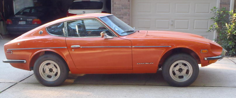

2 hours ago, BDJeff said:
OK, here's how I set the suspension when I tighten the lower control arm bolt.  Minus the two people sitting in the seats.  You can see the gap between the jack stand and the sub-frame.
That is a lot of angle on the front arm, like the struts are not moving or the springs are to heavy.  Did you remove all 4 when you changed the struts? Like ZH said maybe mixed the front and rear springs? Also are the Tokico's set on #1 dampening?

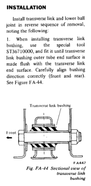

This bushing has a long side and a short side.  Maybe installing backward can cause things to bind up.  If so, you can just swap arms, no need to swap bushings.
Yes, another good suggestion but I checked this about a half dozen times before I re-assembled the rest of the suspension.  The long part is towards the rear on my car.

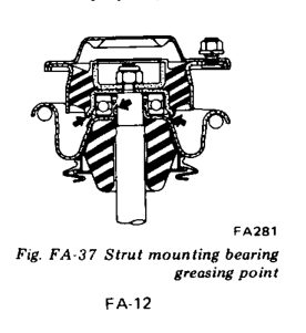

So this weekend I'm going to disassemble the top of the strut assembly and see if I can compare the old strut with the new (correct, I double checked the P/N) strut.  Also will check the assembly of the upper bearing.  For some reason I thought the strut mounting insulator and strut mounting bearing may not be seated correctly.  And these are the same springs that came out, I never worked on the rear suspension

If you can remove the spring and run the strut through its travel you'll know if it's binding or not.  It does seem like your spring is incorrectly seated though.  The bearing sits in a pocket, if it wasn't seated properly it would move the spring seat downward relative to the body mounting point.  Good luck.
OK, so this is making me crazy.  I fully expected to take it apart and find something amiss but it appears all is well.  The spring ends are in their registers, the bearing is seated in the upper bushing and matches the load point at the top of the spring mount.  And the struts are the same length.  The only difference is the old strut sags back into itself but the new strut pushes out the whole length but the extended length is limited by the strut length.  And the strut capture nut is fully screwed down so that's not off either.
