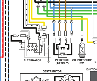

Was the red Charge light on?  It should have been.  If it was not on then you might have just lost connection with the L wire at the T-plug.  I've had that happen at the alternator and at the starter solenoid.  Take it off clean it up, give it a little extra crimp with a pair of pliers.
And, by "no charging", do you mean it showed some voltage but less than 12?  If it showed zero volts then you have a different problem.
The charge light was not on no.
By no charge I mean the gauge was showing me 12V. When I got to work and turned off my headlights the fan started blowing a lot more.
The L wire on the T plug, which wire would that be?
Cheers
I think it's white/black one.  Bottom of the T.  But the bad connection could also be at the regulator.   Could also be in the regulator.
The alternator supplies the ground for the light and energizes the windings so that charging can happen.  If it happens again you could check for voltage at various points on the circuit.  Follow it from the lamp or back from the alternator.
All I'm really saying is that the light should have been on.  The fact that it wasn't is a clue.
