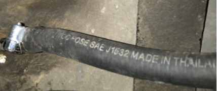

Are those hoses high pressure EFI rated?  You should check.  They might be splitting internally.  Even the return line could be failing.
You can still run the pump and report pressure before you do anything.  Ideally you get all of your measurements at the same point in time.  You have your pump voltage and weird fuel flow above, but no pressure readings.
SAEJ1532 is transmission fluid hose.  I would do that flow test in the engine bay, get your numbers written down so you can study them, then maybe tear your system down and get the right hoses on it.

My mistake, they don't need to be high pressure.  They should be fuel rated though.  I don't know if automatic transmission fluid hose will swell in the presence of gasoline.
The one on the other side of the fuel pump needs to be high pressure EFI hose though.  I've found that when people start using the wrong hose in one place they tend to do it in many places.

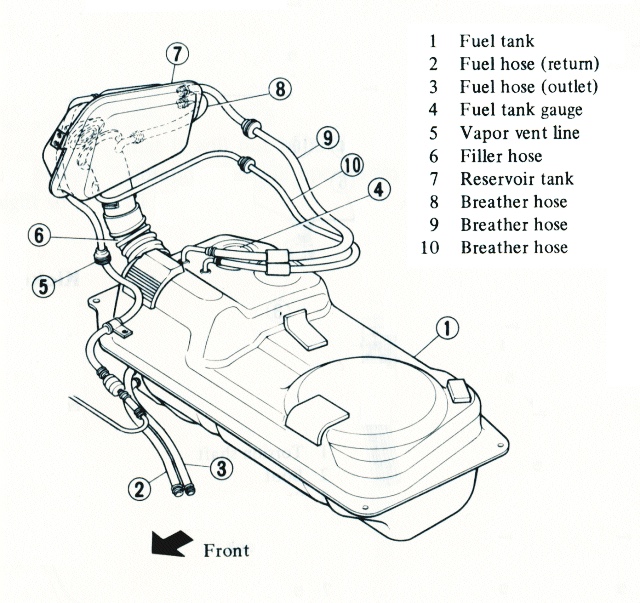

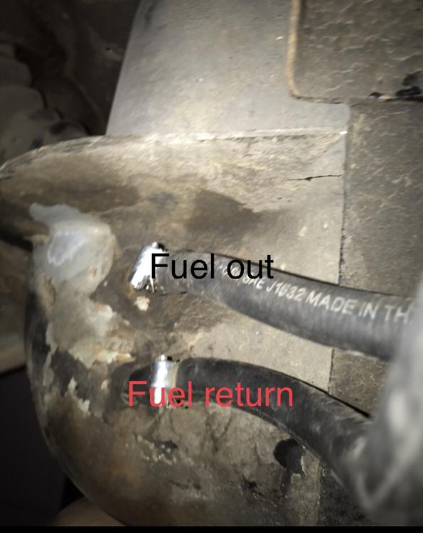

Need some clarification on which is the fuel out and fuel return.
The pics I find it’s very hard to tell what hose is what. Also my hose location is on the passenger side other pics show it in the middle.
Found a decent pic. So top is the fuel out by the look of it.

Replaced hoses with fuel ones from the tank to pump and return.
