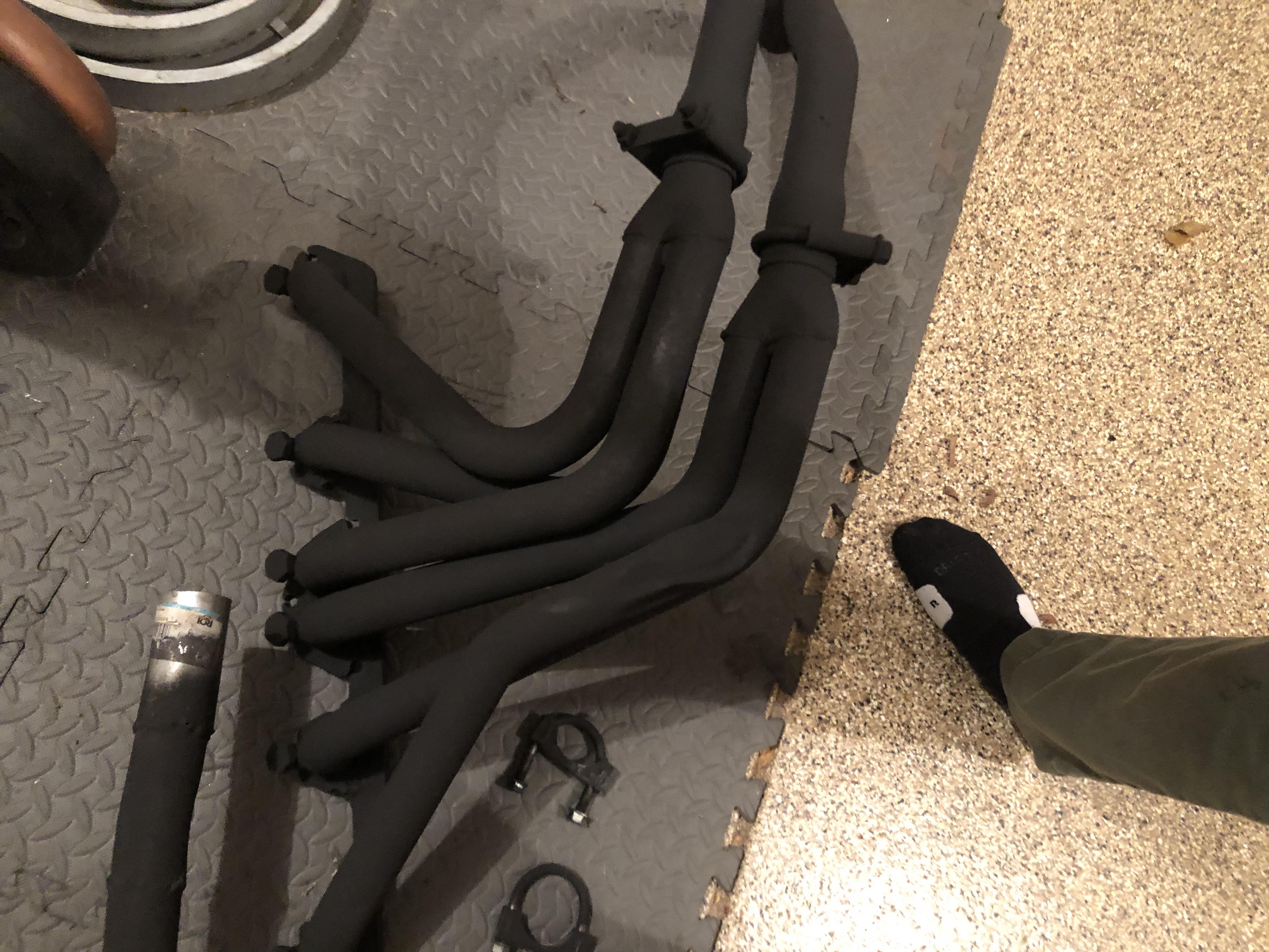

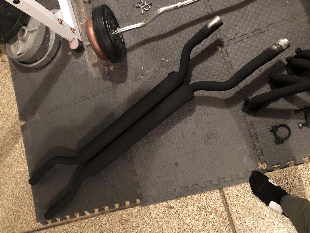

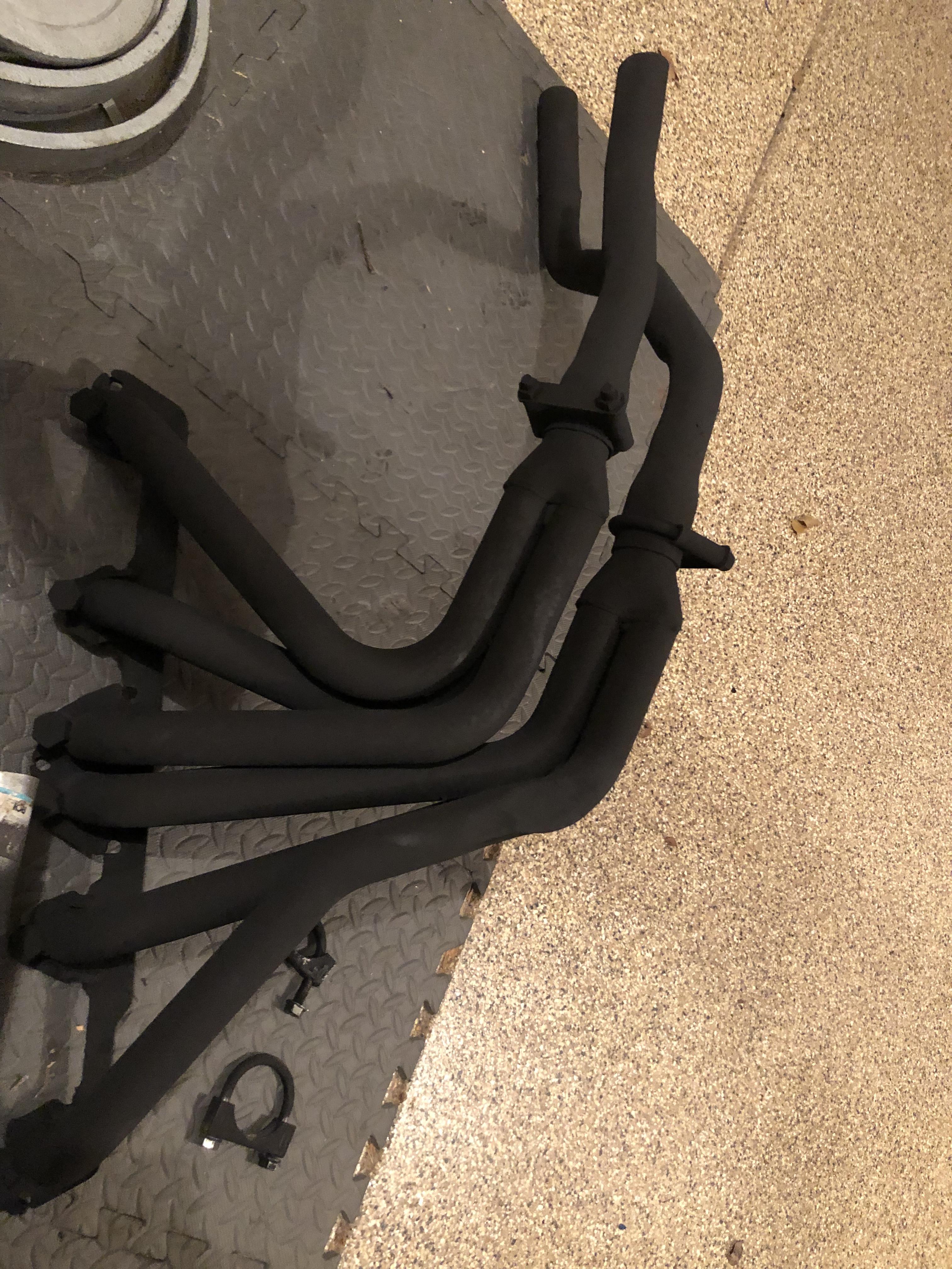

Got these off craigslist for $50 including the midsection of pipe with it. Was just wondering what kind these are and if they look to be any good. I think the midsection is home made, just by finding a newer sticker on the piping. Think they’ll be decent?
They look like emissions-correct 240Z headers.  Those ports with the bolts in them are for the air pump air.  MSA looks like a probable source.  Check their website.
http://www.thezstore.com/page/TZS/PROD/15-6002
That makes much more sense, they were pulled off an e88 head 260z and are in pretty good condition so I am going to throw them on my n42 head 280z. They are square port but it shouldn’t matter that much, I’ll just get a 260z gasket. I don’t see any problems with this fitment do you? Since they sell the same header for the e88 as they do the n42.
I stopped looking for them on the MSA site after I saw the collector was a bit further back than all the MSA ones but I can see the design is quite similar
