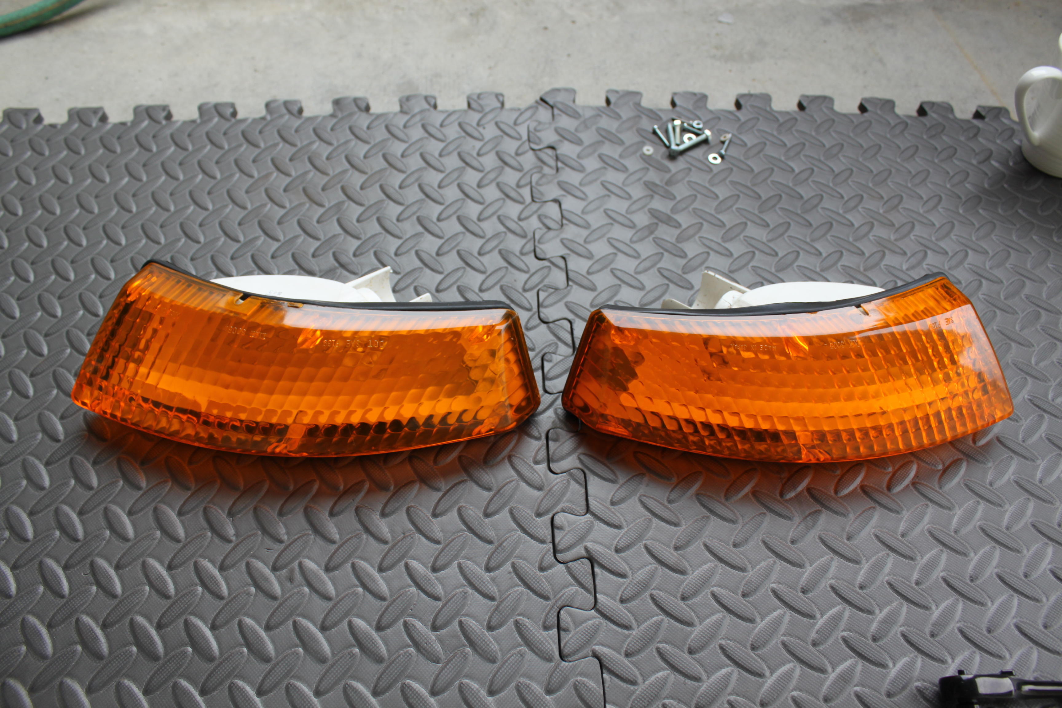

+1 on the Meguiar's product. I used # 17 followed by #10 on my tail light and front turn signal lenses, with good results.
What did you use to apply the product?  I.E. Just by hand?
I did it by hand using microfibre cloths to polish with, and did a couple of applications of each product. It does a good job with haze and micro scratches, deeper scratches become a little less evident.  Here's a picture of the result.
Nice, I have a set of turn signals that also need some love.

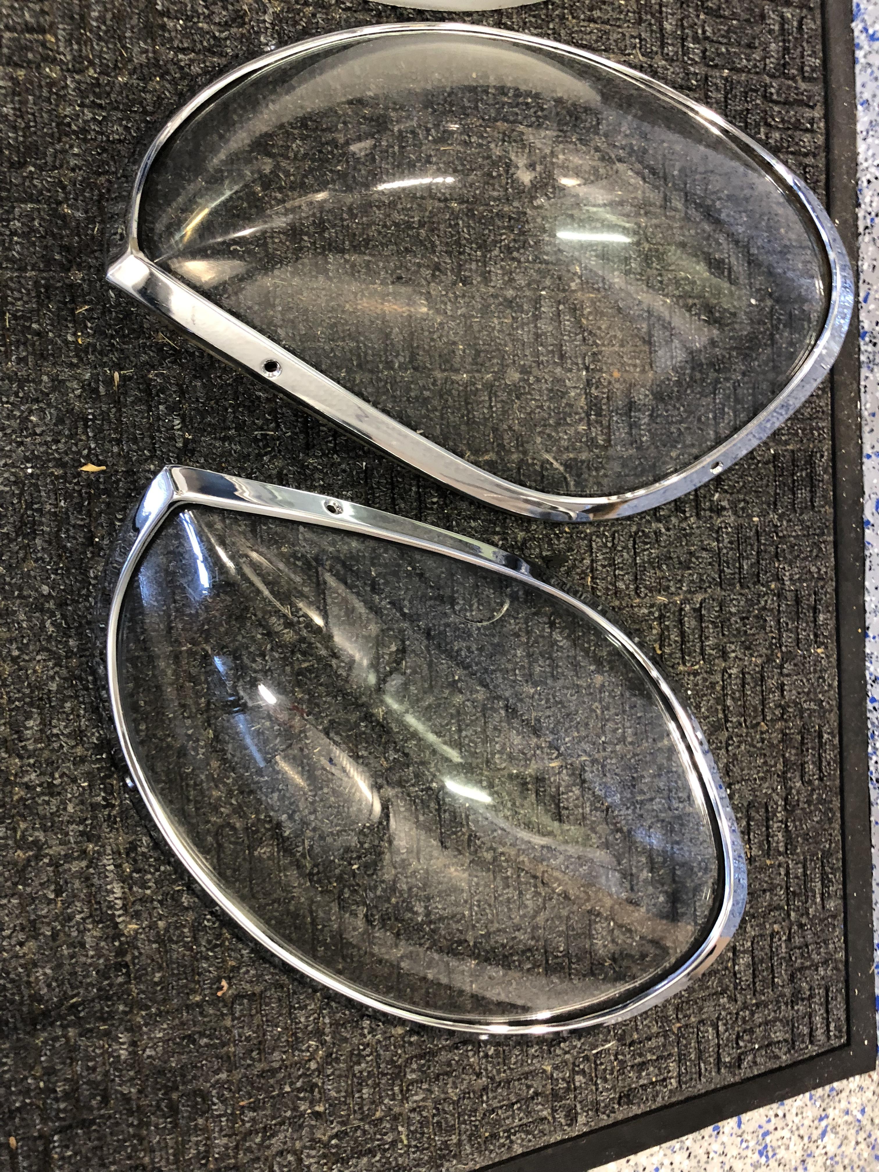

The Meguiars worked really well.  I applied it with my small air driven buffer.  Thanks for the tip!
