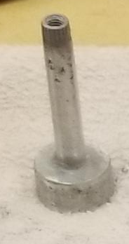

The large pits are actually outside the seal. I was working on building up the plate on the plunger and polishing it but then had to redo some of it. So I went with what I had. It is actually much smoother than it was originally. I would still be curious to know if the reman boosters can pass the spec
