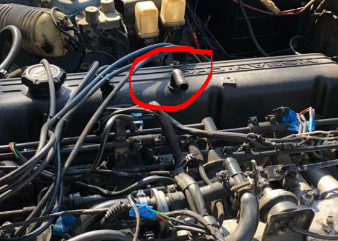

Maybe it's a phone - computer incompatibility but there's only sound on your "vid".  Somebody else did the same thing the other day.
And that thing you're holding in your hand is the vacuum advance control solenoid, I think.  The electrical doesn't matter as much as the open vacuum line.  That would be a small vacuum leak.
And your valve cover is connected to your crankcase which is connected to the intake manifold via the PCV system.  It's a giant vacuum leak.
