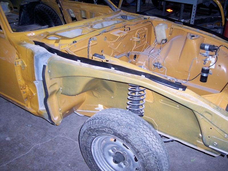

Absolutely - been there, done that.  Check your local auto parts store for self-sticking closed cell foam weatherstrip.  It usually comes in a variety of widths and thicknesses, I think I used a 5/8" thick  product.  In addition to the splash shield (shown), use the same product on the baffle on the inside of the fender where it seals against the A-pillar.  Closed cell is important as it will not hold moisture.  Be sure to remove all the old stuff before applying.  Also - you can see the same material used for the pads.
Edited by jfa.series1
Home Depot frost king rubber foam self stick weather seal.  About $7 for a 10’ long roll. The size I got is 7/16 thick 3/4 wide
