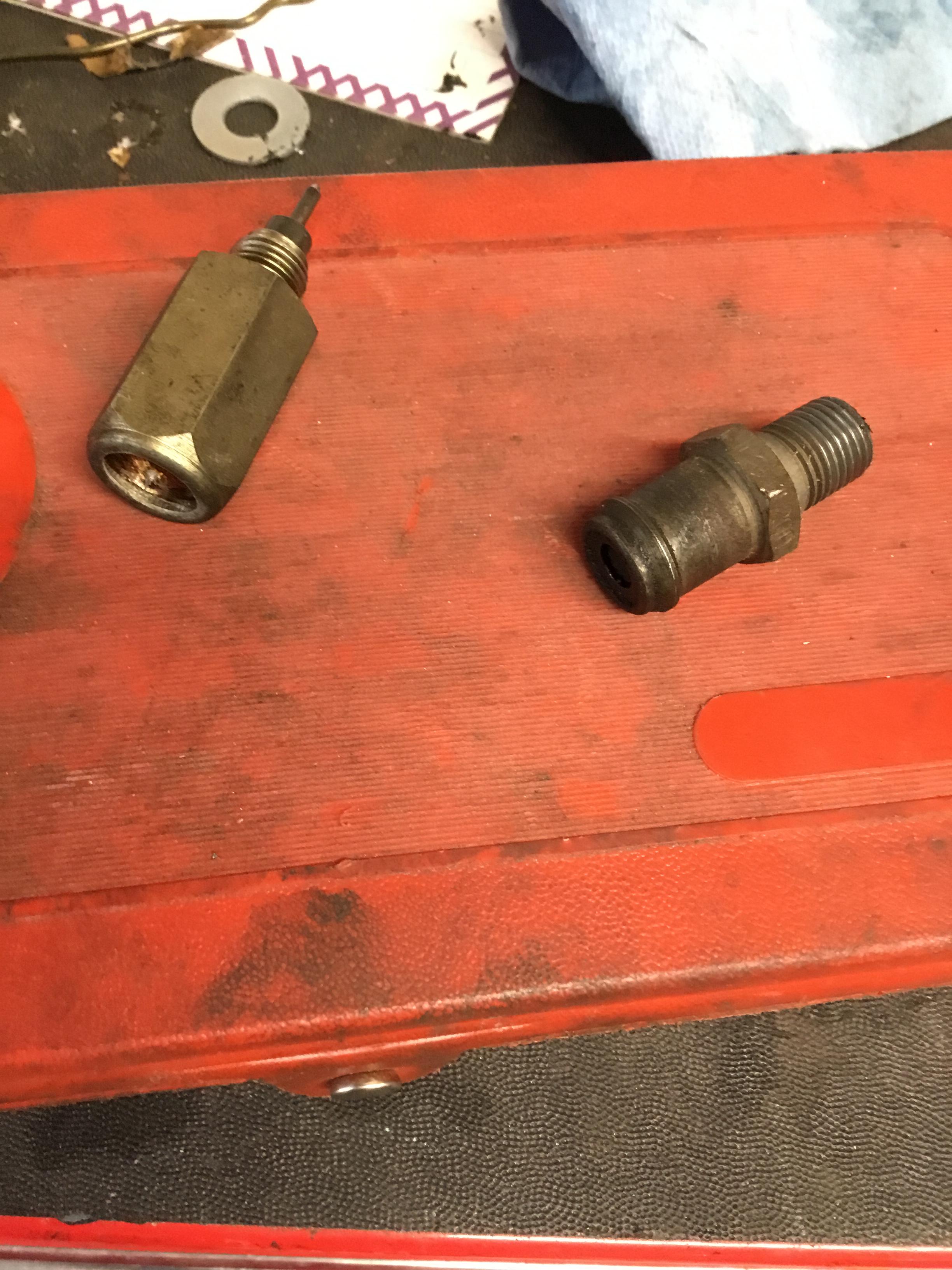

Looking for the wired selonoid that screws into the BCCD valve. The wire is broke off inside the plug. I’m going to try and fix it but I need a back up plan.
Item is pictured on the left.
They will all do that eventually. It's because of the stress riser where the potting ends and the way they bent the wire to make connection to the harness. If you've got a usable one now, I would recommend you pot some more of the wire and move that stress riser further from the solenoid.
