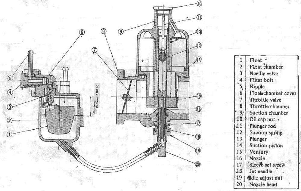

Hopefully someone will find all this info useable. The HJG46W-4 is the carburetor for the 71 Z. This carburetor along with all 240z / 260Z's is listed as having a bore of 1.811in (46mm), this must be at the throttle valve plate as I used my micrometer and measure 43mm at the carburetor inlet. It does appear from this diagram that the throat? is widened on the intake manifold side of the venture. None of this info really helps to answer any of my questions in this thread. Hopefully someone with the stock air cleaner can measure the height of the integrated velocity stacks and post in this thread.

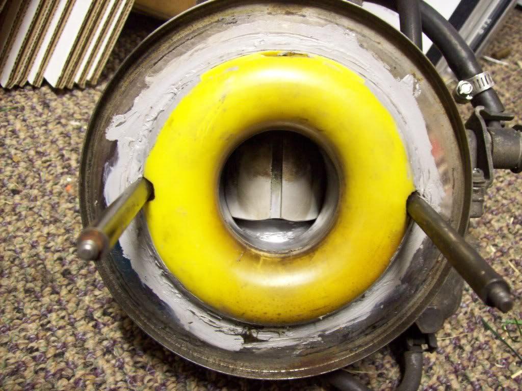

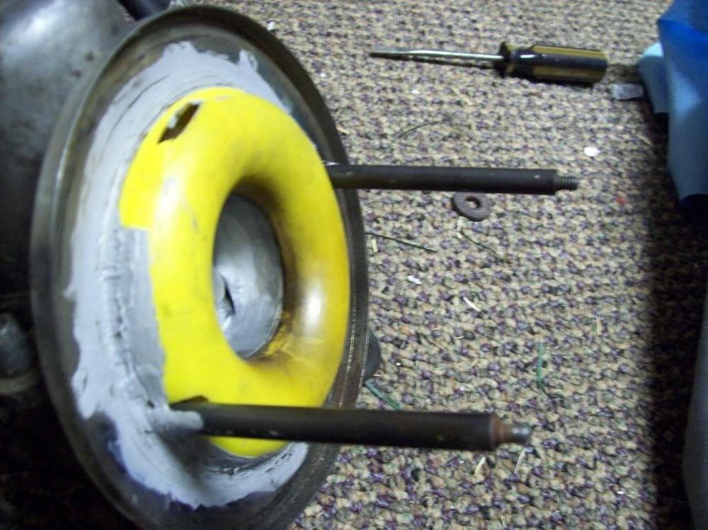

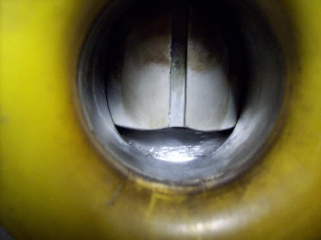

240260280, I keep seeing those pictures of norms mod but I can't find a write-up on it anywhere. Does anyone have more info on it?
