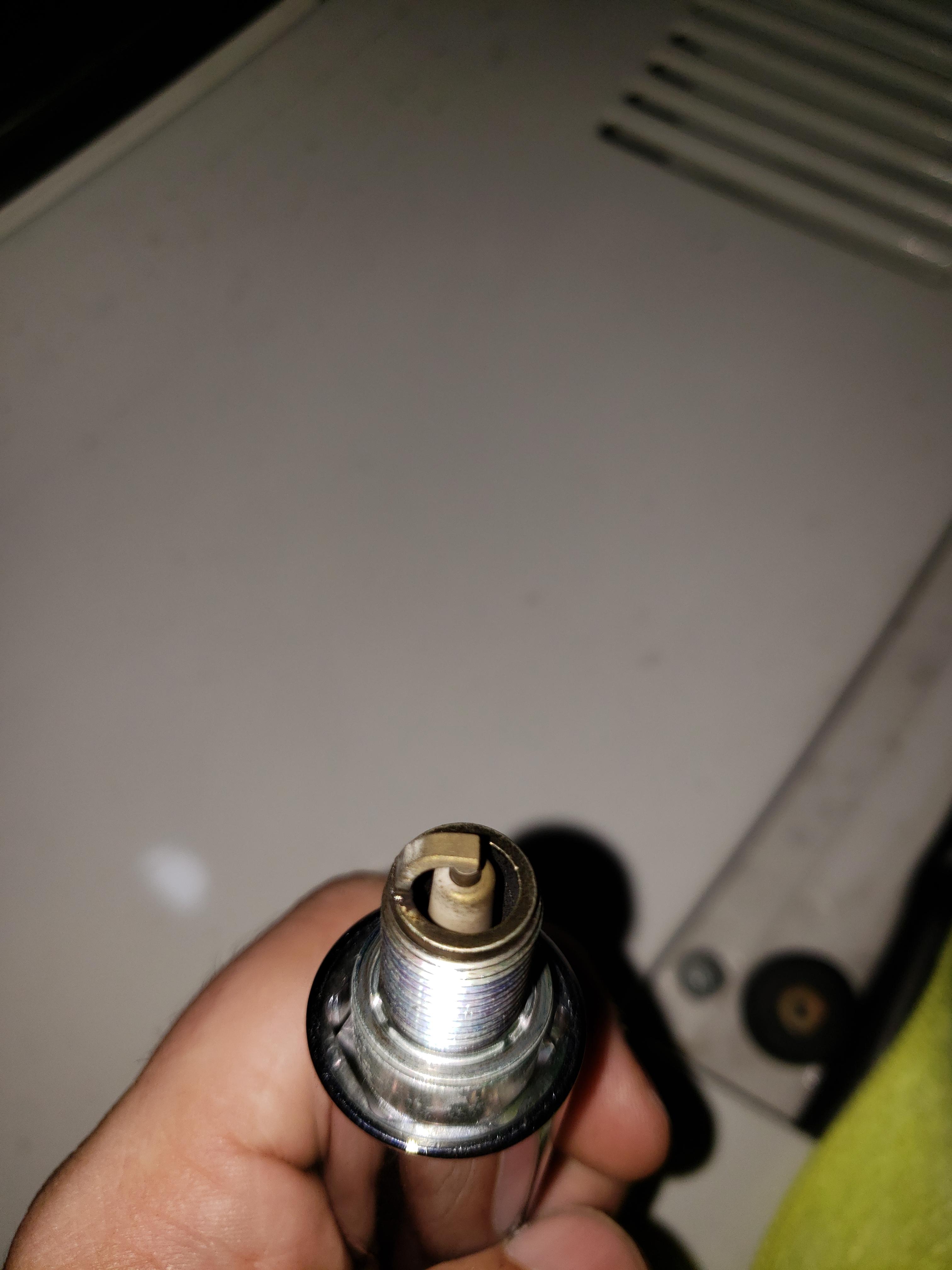

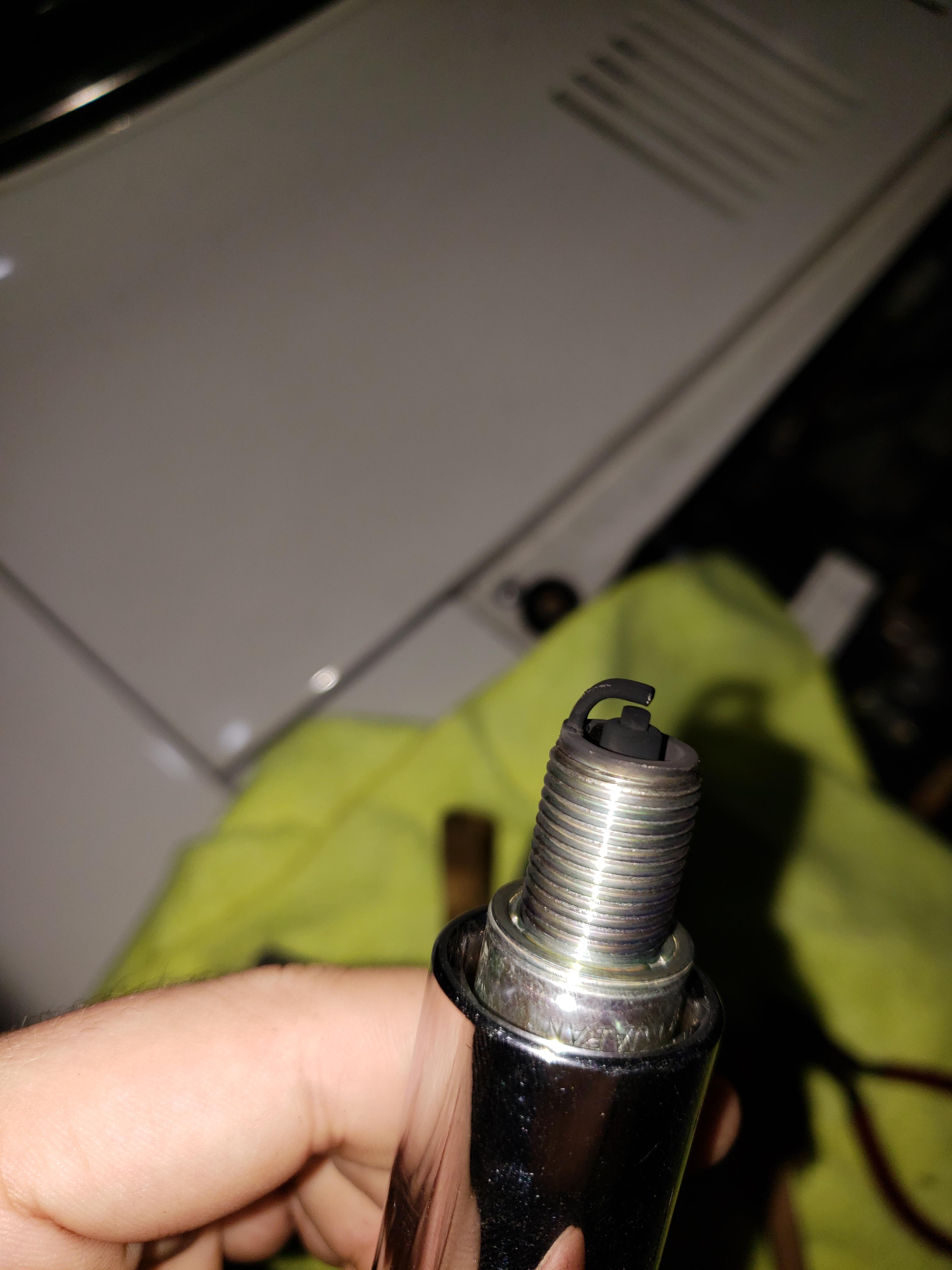

I checked the choke cables and they did not leave the jets down when pushed back once the engine got warm. I crank the engine and left the car to idle at the parking lot for 10 to 12 mins. Pulled spark plug 3, 4 and 5. 3 and 4 were fouled 5 (first picture) was clean. Maybe i should run the car for 20 to 25 minutes and then leave it to idle. Do you agree?
 No, don't let it idle. You'll only end up buying new plugs. The fact that only a couple of plugs are fouled narrows the problem down to, what I believe is, poor spark plug wire connections at one end or the other. Compression is good, new ignition parts, there's not much left to blame it on. Try re-seating the spark plug wires onto the plugs and into the cap. They all should snap into place. If you have a volt-ohm meter, you could pull the cap with the wires connected (leave the wires in the loom), pull the plugs, reconnect the wires to the plugs and measure the resistance from the terminals inside the cap to the center pole of the plugs. The resistance should be nearly identical on all six.
