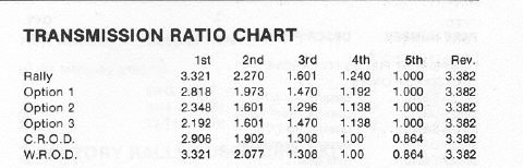

Does anyone from "way back in the day" know what the available ratios were for a NISMO 5-speed tranny for the 70-73 Z cars? I just bought a 73 240 Z racecar and it came with a Nismo 5-speed for a spare. The serial number is listed as NMCD 2#. Any help would be appreciated. Much thanks, photos coming soon!
Eric aka ZMunkey
Here's the list of the tranmission ratios that were available. I don't have anything that will tell me which trans you might have given the serial number.
Perhaps Alan T. might have something that will decipher the serial number....

2ManyZ's posted the list of the names for the different "B" box ( 'Bent Stick' FS5C71-B option box ) transmissions and their ratios - which you should copy and file away for future reference. That's useful data.
I think that the spare box you have is the "Option 2" Direct Drive ( fifth gear is 1:1 ratio - ie. not overdrive ) and the shift pattern is the 'Dogleg' first ( first gear is all the way over to the left and back, and reverse is all the way over to the left and forward, leaving second, third, fourth and fifth in the conventional 'H' gate pattern ). Does that make sense? If it doesn't then I'm not explaining properly!

which does show some of the competition boxes that were available. I don't know if I have the "close ratio w/od" box or the "Option 2" box like you've suggested. I'm thinking like you though, that NMCD 2# means "option 2" and that its got a 1:1 5 gear...
If I mainly want to do auto-x and driver's track day events and not actual road racing, wouldn't I want the shorter 1st gear found in the factory 4 speed? Expecially if I'm turning the 3.364 factory R-180 diff?
Oh, if I use the competition 5 speed and the 3.364 rear end, I can pull to 60mph at 6156 RPM! That would be a complete auto-x in just one gear (mainly)... If I use the factory 4 speed then 2nd gear is the same as first gear in the NISMO box (60 mph at 6170) and I have a shorter first gear for launching...
Hi,
It's easy to find out if it is 1:1 in fifth.
Simply put it into 5th gear and count the number of time the shaft turns.
I really don't need to add if the input shaft is turned 1 revolution and the output is the same then you have that 1:1 5th, do I?
Likewise you can do the same for all the other gears and then compare the raio with whats in the book. {Wouldn't mind betting thats the Close Ratio Option 2 box, you lucky lucky person}.

Why would I be a lucky lucky person to have this tranny? From what I can see on the tranny calculator, I *could* run auto-x events in 1st gear all the way out to 63 mph with my stock 3.364 rear end... BUT, that's *identical* to 2nd gear in my factory tranny with the 3.364 rear end! Where's the benefit in that (other than having 3 more gears to play with before I'm in 5th at 1:1 rather than just 1 gear before 4th-1:1)? Am I making sense?

Now on a road course I can see the benefit... 1st locked out to the left (like the old Porsche trans) and 4 higher gears ending in 1:1 with 2nd being only slightly taller than 1st in order to make it useful for cornering.
Sounds like, for what I need to do, that I need to sell this trans and get a 3.90 R-200 and other related parts I need to make this car nicer...

Eric, it all depends on your use.
Obviously, it's not the tranny you want to run, shame you're not in Aus, otherwise I'd be tempted to make you an offer. It's ideal for my use [Rally], unfortunately the freight would be prohibitive.
As to how to shift it, get a shifter from another trans, and yes you do make perfect sense, you may as well stay with a stock trans.
