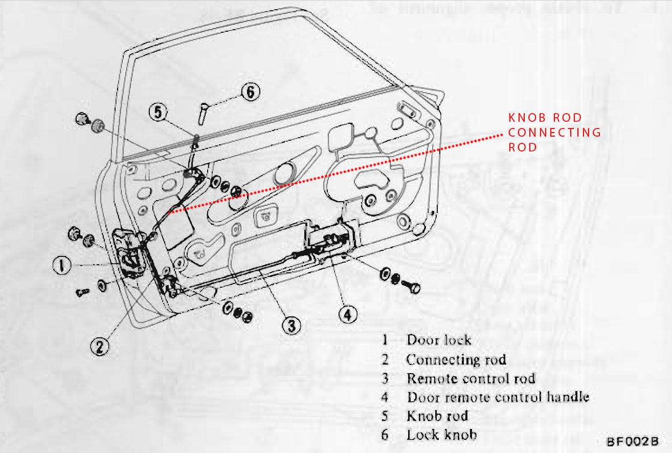

Posted May 17, 20187 yr comment_549418 I'm guessing this is going to be a very hard part to comes across, unless anybody knows somewhere that sells it new? I've looked extensively. Photo attached to clarify the part I need. My 78 280z somehow came with neither side. Everything else is there. Thanks, Kevin Link to comment https://www.classiczcars.com/forums/topic/60043-door-lock-knob-connecting-rod-both-sides/ Share on other sites More sharing options...
May 17, 20187 yr comment_549419 Thats wrecking yard material, but this guy probably has one: http://www.zspecialties.com/ Link to comment https://www.classiczcars.com/forums/topic/60043-door-lock-knob-connecting-rod-both-sides/#findComment-549419 Share on other sites More sharing options...
May 17, 20187 yr comment_549420 That is not a separate part. It is a component of the door lock. It's the same part number for the 77 and 78, but the 2+2 uses a different part. Link to comment https://www.classiczcars.com/forums/topic/60043-door-lock-knob-connecting-rod-both-sides/#findComment-549420 Share on other sites More sharing options...
May 17, 20187 yr Author comment_549421 Just now, SteveJ said: That is not a separate part. It is a component of the door lock. It's the same part number for the 77 and 78, but the 2+2 uses a different part. Really? I'll have to take a closer look when I take out the complete assembly this weekend. Thanks for the info. Link to comment https://www.classiczcars.com/forums/topic/60043-door-lock-knob-connecting-rod-both-sides/#findComment-549421 Share on other sites More sharing options...
May 17, 20187 yr comment_549428 Quick reference: http://www.carpartsmanual.com/datsun/Z-1969-1978/body-260z-280z/2-seater/door-lock-regulator-handle If you are missing part of the lock, the door lock part numbers for your car are 80502-N4420 Right 80503-N4420 Left Link to comment https://www.classiczcars.com/forums/topic/60043-door-lock-knob-connecting-rod-both-sides/#findComment-549428 Share on other sites More sharing options...
May 17, 20187 yr Author comment_549437 4 hours ago, SteveJ said: Quick reference: http://www.carpartsmanual.com/datsun/Z-1969-1978/body-260z-280z/2-seater/door-lock-regulator-handle If you are missing part of the lock, the door lock part numbers for your car are 80502-N4420 Right 80503-N4420 Left 10-4 thank you! Link to comment https://www.classiczcars.com/forums/topic/60043-door-lock-knob-connecting-rod-both-sides/#findComment-549437 Share on other sites More sharing options...
