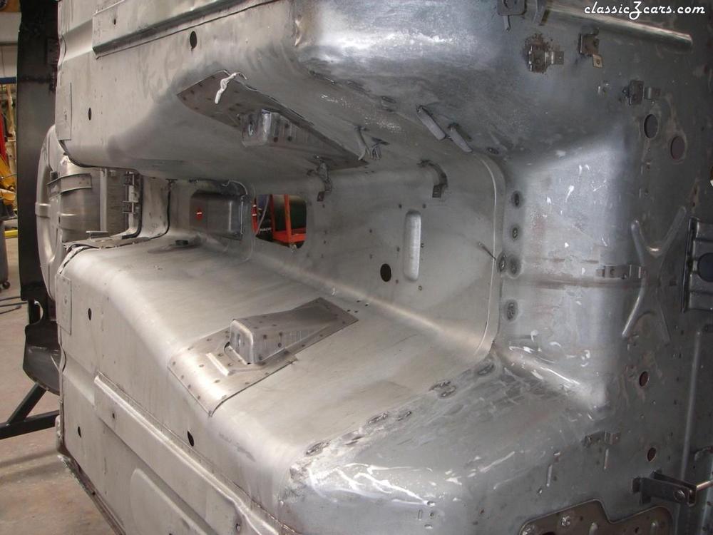

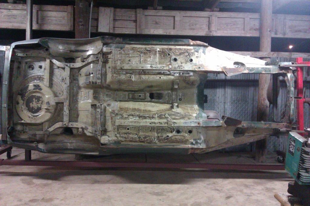

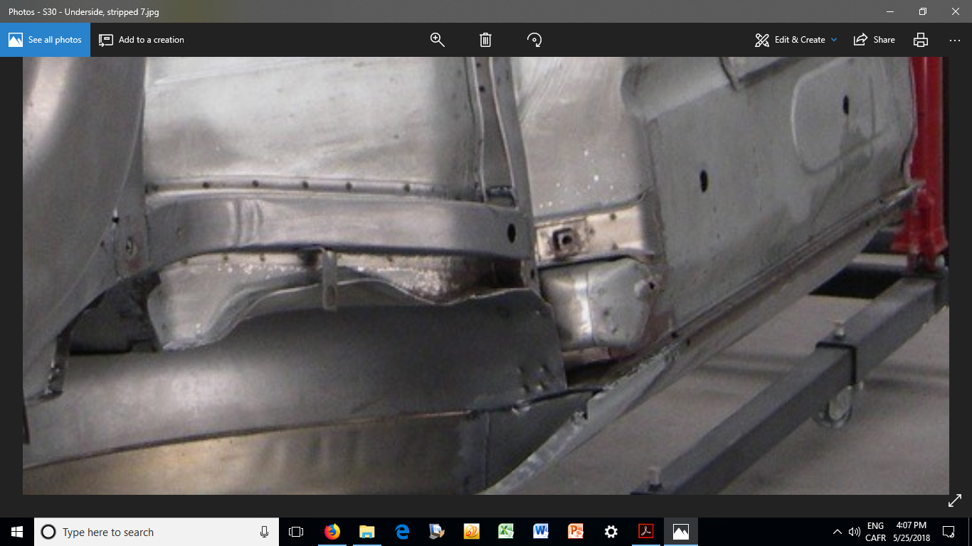

That's an interesting measurement.  My initial thoughts are:
  • It's hard to believe that the LHS and RHS pinch weld lines weren't designed to be anything other than parallel.  Proving that with 100% accuracy is another matter, of course, because we have only the FSM 'Standard Body Dimensions' diagram as a reference and it doesn't even specify the left-to-right separation distance of the pinch weld lines.  I've just tried doing a blow-up of the diagram on my screen, so that I could scale off the separation distance and compare it to a marked measurement.  I get 1326mm.  The accuracy of a derived measurement like this is probably +/- 2mm.  Still doesn't solve your predicament.
  • How do you find a centreline for a unibody?  That's a great question.  It would be nice if the design included an alignment hole at the front and the rear -- but it doesn't.  At the back, you have the two 'C' holes drilled into in the rear sub-frame piece.  Plumb those two, then measure and mark a centrepoint.  At the front, however, you don't really have anything obvious to work from.  Whatever you choose, you need to make sure it's not compromised by any of the collision damage -- everything ahead of the firewall probably needs to be treated as suspect.  Finding the mid-point between the pinch weld strips under the front edge of the doors might be as good a reference as any.
  • Collision repair sources say that "3mm" is the accuracy that they shoot for.  I believe that, in practice, this means they work to +/- 3mm, rather than +/- 1.5mm).  So that means they're happy with a left-to-right discrepancy of up to 6mm ( about 1/4") on wheelbase, or any other pair of long-ish measurements.
  • The rotisserie photos below (unknown source, so apologies for no photo credit) may give you or somebody else has some better ideas about how to find and mark a centreline.
  • The racers in the crowd are probably the best source of information on how to do this and on, 'how close is close enough?'.  Track damage is pretty common occurrence and race cars usually get repaired rather than replaced.

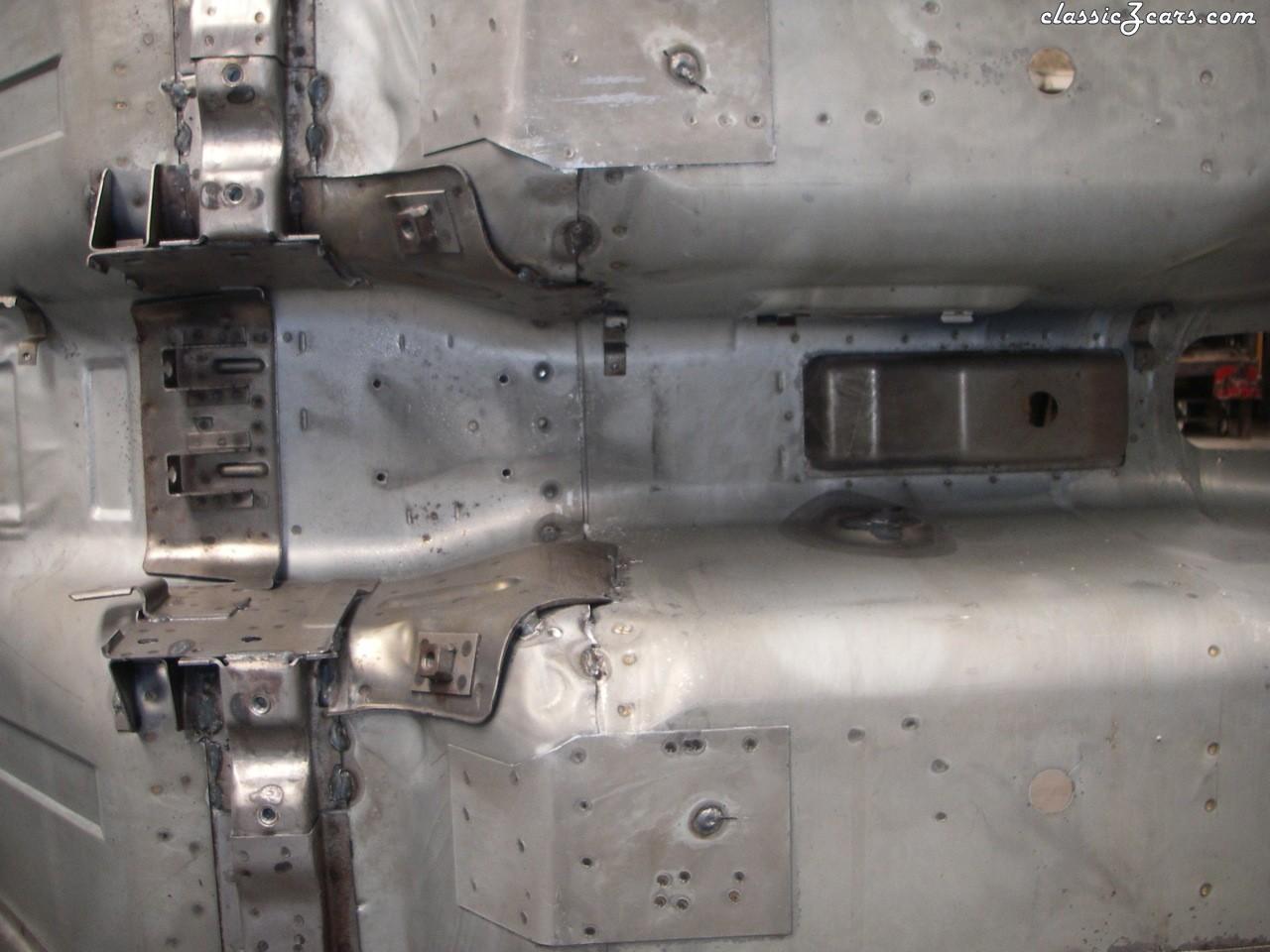

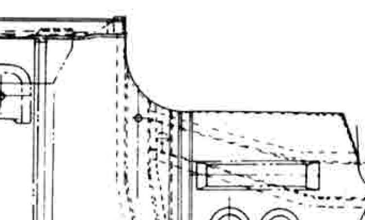

Awesome info. I appreciate that. Can i co firm, the "c" holes, they are about 1" in diameter just by the seat belt buckle buckets
Sent from my SM-N950W using Tapatalk
Nope.  I think the 'C' point is something that you have to mark for yourself, based on the visual info inferred (implied?) by the FSM diagram.  It seems to be in line with the outboard wall of the longitudinal rear sub-rail where that rail ties into the front transverse sub-rail, and then positioned dead-centre on the front transverse sub-rail.  Note that there is a hole (factory-punched) in the transverse rail in that vicinity, but it sits about 1/2" outboard of the location that the FSM diagram suggests.  Who knows?  Maybe the punched hole is the C-point.  It would certainly serve quite nicely for purposes of fore-aft measurements, but it would be off a bit for width-wise and diagonal measurements.  See pix below (and, again, apologies to the unknown owner of the newest photo I'm about to post):
