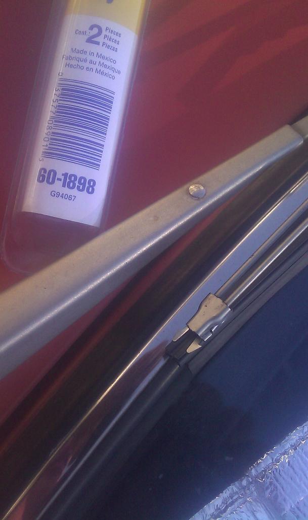

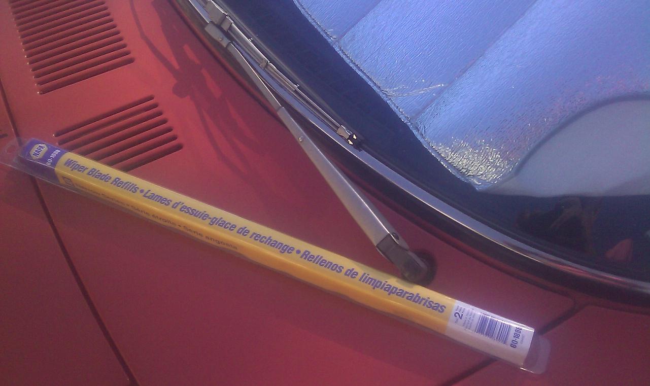

September 7, 201410 yr comment_454877 FWIW I just put new wiper refills on original arms (I don't know why, it never rains here) and found NAPA 18" refills. They are NAPA 60-1898 $5.59 for 2 blades in the pack. I had to close the tangs a little where the new blades slide thru the original arm retainers for them to fit securely. Link to comment https://www.classiczcars.com/forums/topic/5988-wiper-refills/?&page=2#findComment-454877 Share on other sites More sharing options...
