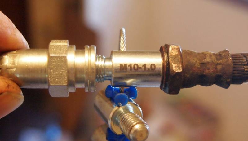

My old brake lines from the banjo bolt fitting to the metal brake line at my front calipers are being replaced and I ran into this problem.
At the banjo end the threading is M10-1.0 male while the end of my new line is a M10-1.0 female.
The brakes are a four piston design so I'm assuming it's a Toyota upgrade. The new brake line is a Centric 150.42010 from Rock Auto.

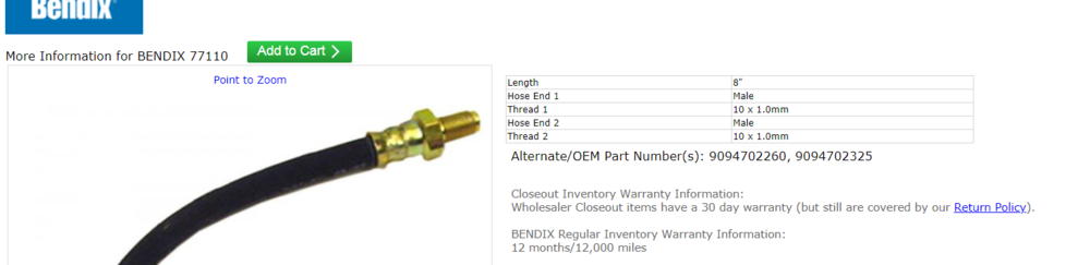

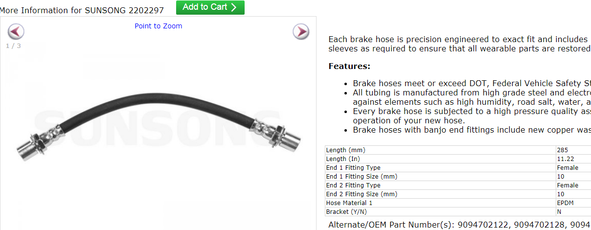

I often use Rock Auto to research and compare parts.  Find the Toyota that uses your new brake caliper and look at the pictures of the brake lines.
It looks like the closest I can find is CENTRIC 15044303 which is a front hose for a Toyota Land Cruiser (1981). Unfortunately, there are no measurements provided so should I assume M10-1.0?  I might try contacting Centric or one of the other manufactures to see if they can provide the specs. Or maybe a trip to Summit Racing.
Ya gotta click the info button, sometimes on the other brands.
This link says 15044303  is the rear hose for a 79 Corolla though.  Closer.  Blue INFO button.
Edit - I mixed my self up.  I would just click enough blue buttons until something made sense.  Then take your calipers to the auto parts store and make sure they fit.
https://www.rockauto.com/en/catalog/toyota,1979,corolla,1.2l+l4,1274622,brake+&+wheel+hub,hydraulic+hose,1792
Edited by Zed Head
Looks like:
https://www.rockauto.com/en/moreinfo.php?pk=7646880&cc=1276398&jsn=__GIP__1__
is the closest (Toyota Land Cruiser) since it is the right length and is a M10 male/female; however the grove for the hose end clip is on the wrong end and I'd need to assume the thread is 1.0 pitch. I guess I can go with that if I cannot locate anything better.
