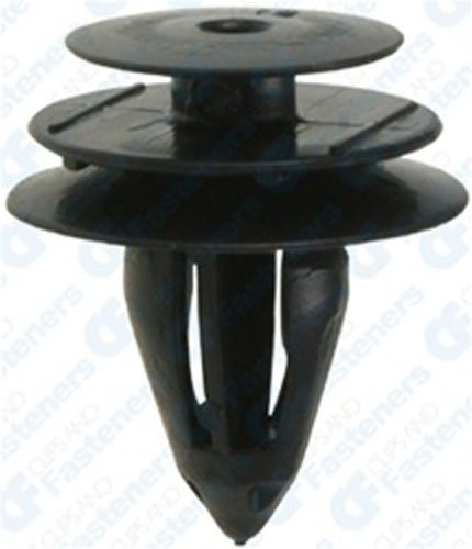

December 10, 20177 yr comment_537075 I agree that taking the door panel off is probably the best way. I did the lock swap because mine were worn. I could lock but not unlock. Now it's the opposite, I just have to hold the handle up when locking. Kind of a pain but it works. My weapon of choice for door panels is this $5 beauty from Autozone. I found the perfect 77' door panel clips on Amazon https://www.amazon.com/gp/product/B0040CTVAE/ref=oh_aui_detailpage_o00_s01?ie=UTF8&psc=1 These are reusable like the origianals. Edited December 10, 20177 yr by gwri8 Link to comment https://www.classiczcars.com/forums/topic/59119-new-key-by-code-in-glovebox/?&page=2#findComment-537075 Share on other sites More sharing options...
