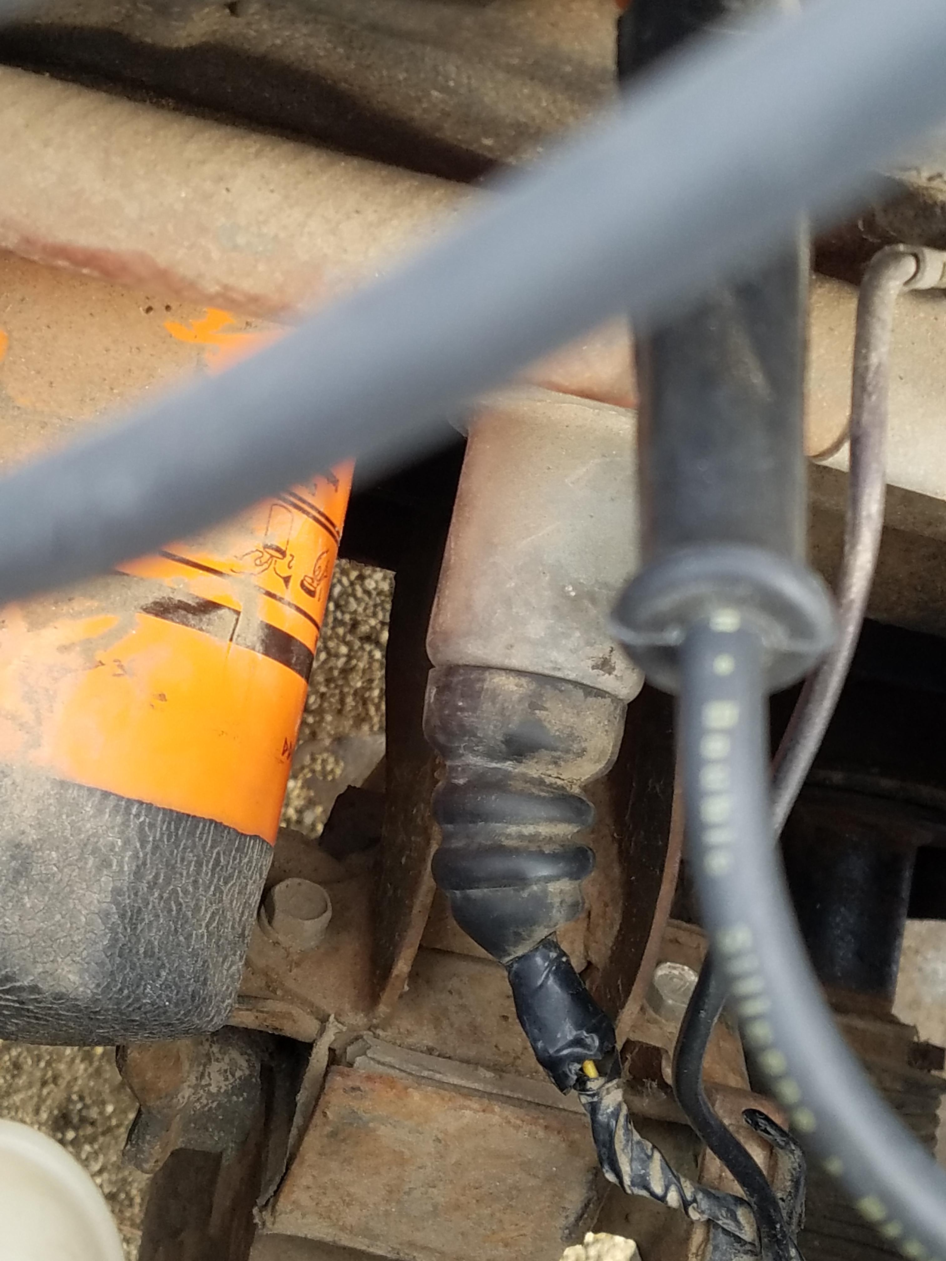

Hey guys thanks so much for the fast replys ok so when i took the old gas out it didnt smell. Smelled like gas. But it was greenish (light transparent) it was a tad green but compared to the new gas i bought the gas was straight clean like water. Also i notcied when i tried to crank it up my fan was slow also as if it was heavy i made sure it wasnt hitting the plastic gaurd and its not should i upgrade it? Also i have pics ill upload them also can i upload videos? Oh also next to oil filter there is this plug can anyone tell me what it is?

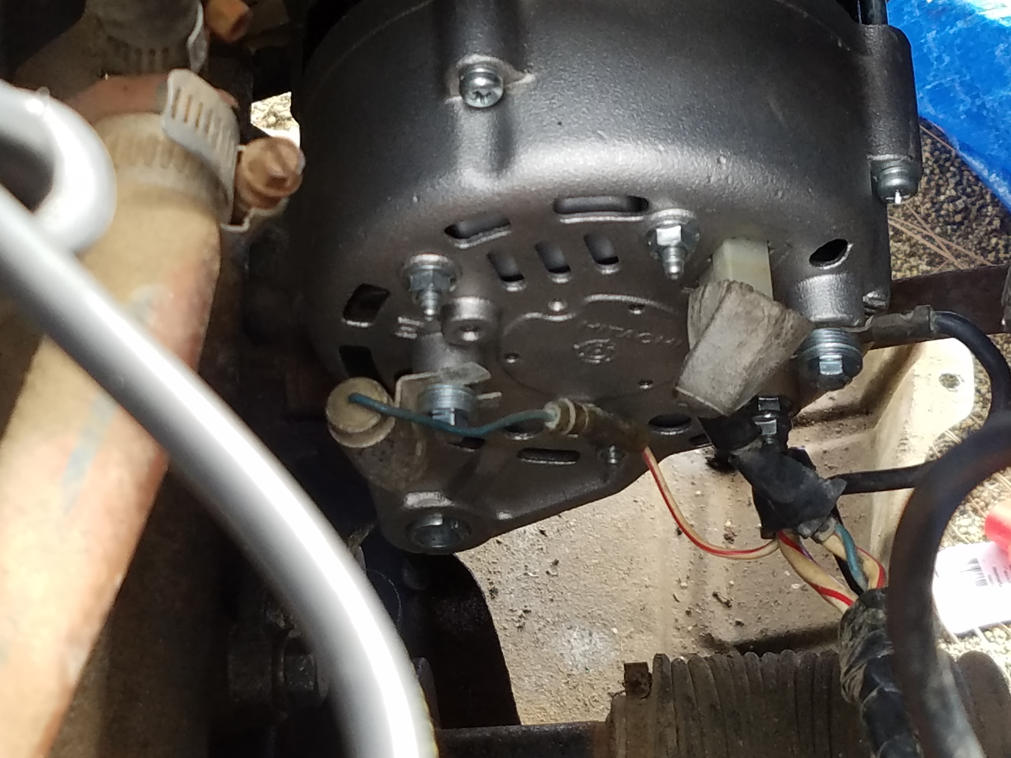

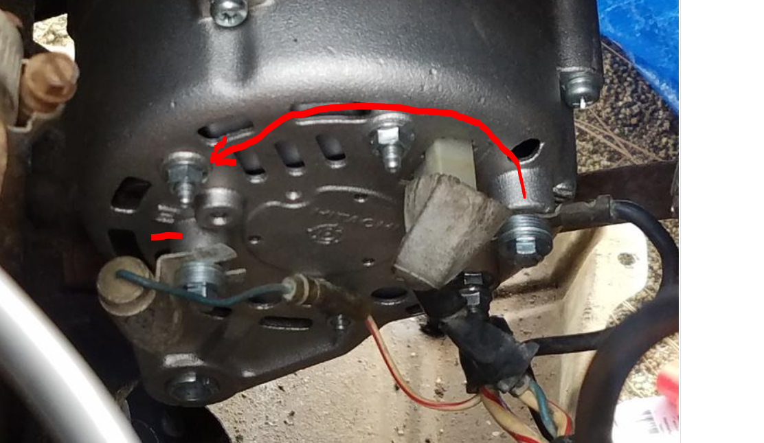

Your alternator ground wire is in the wrong spot but it is probably not a big deal.  "E" stands for earth, which is also called ground.  But the alternator case is also connected to ground.  It looks like your T plug has been messed with.  Take that white piece of tape off and see what's under there.

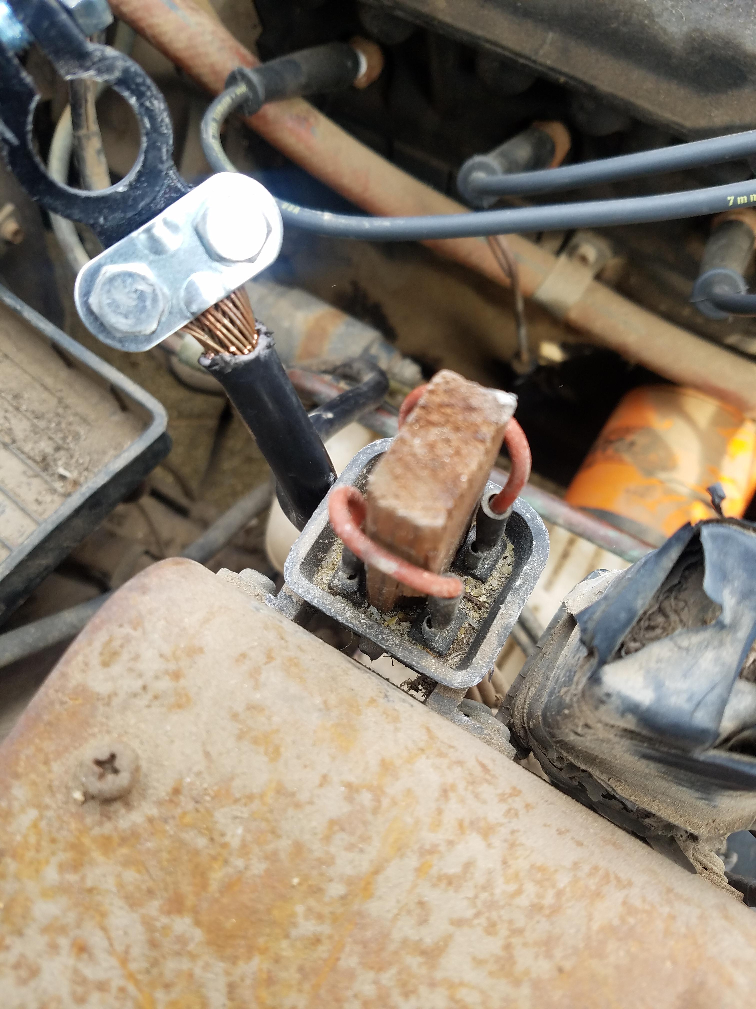

Your fusible link ends look like they need cleaning.  Be careful that you don't short your battery when working on the electrical stuff.  Take the battery negative cable off if you're not used to working on electrical.  Burnt wires would be a nightmare for you.  Those are bad battery cable ends also.  They get dirty easily.  Could be part of your problem.

This is the oil pressure sending unit, not sure if that's what you are speaking of though.
