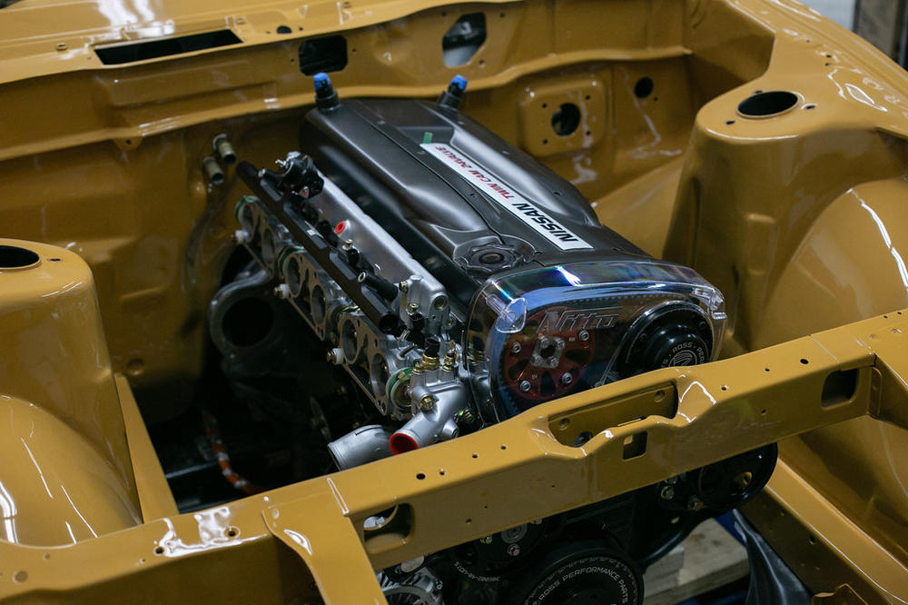

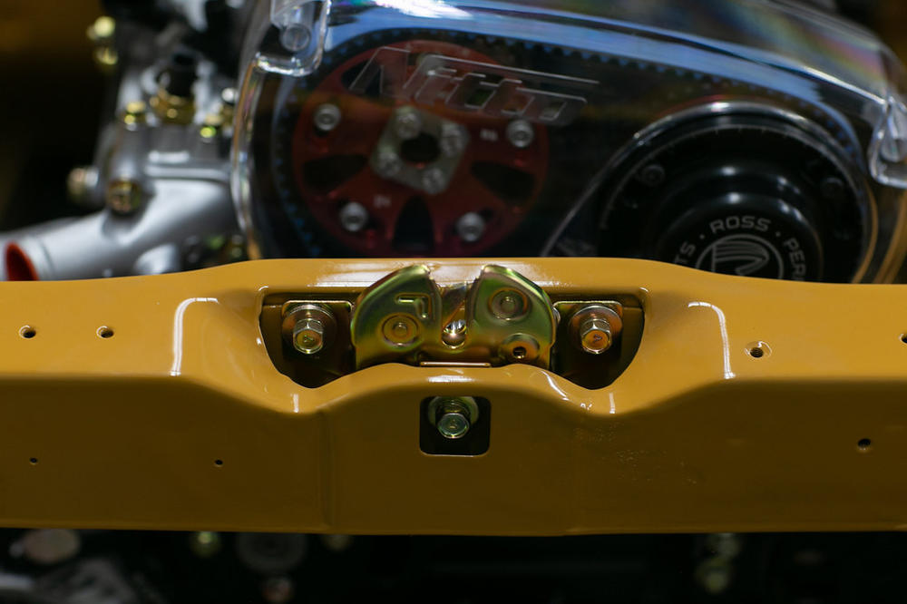

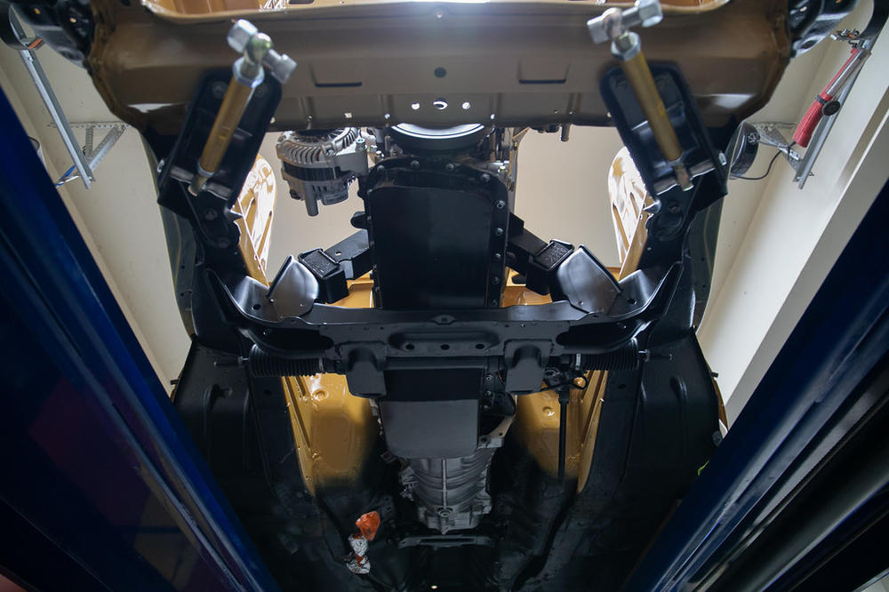

The ZR crossmember is in the US from Japan. Just need to get it coated and then the engine can go in the car. I have a complete extra set of OEM parts needed to swap an RB into a Z31 as well so will have those coated and sell the set on ebay for quite a bit since you just cannot find the parts. Took me a year to get them all!

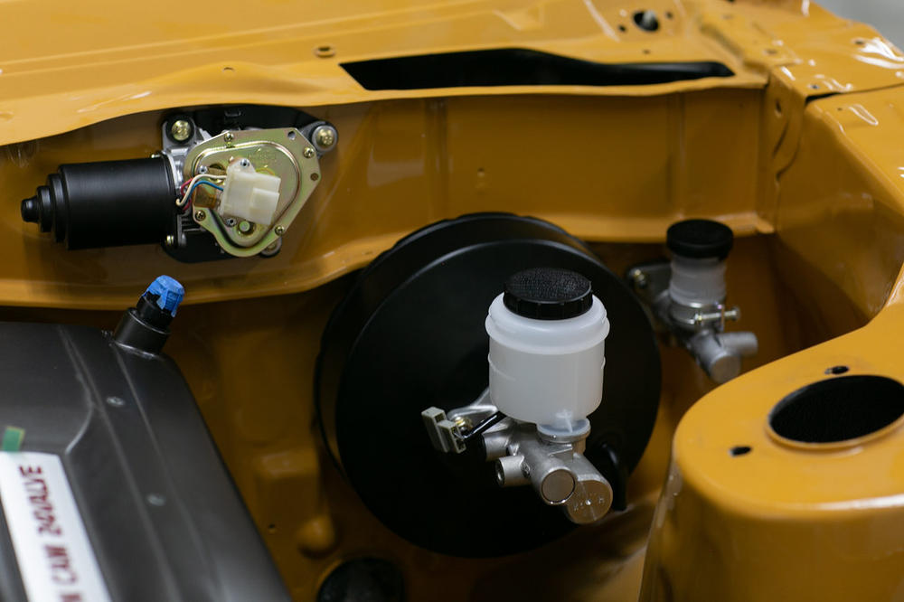

Finished the wiper motor restoration and very proud of this one! It came out better than OEM!

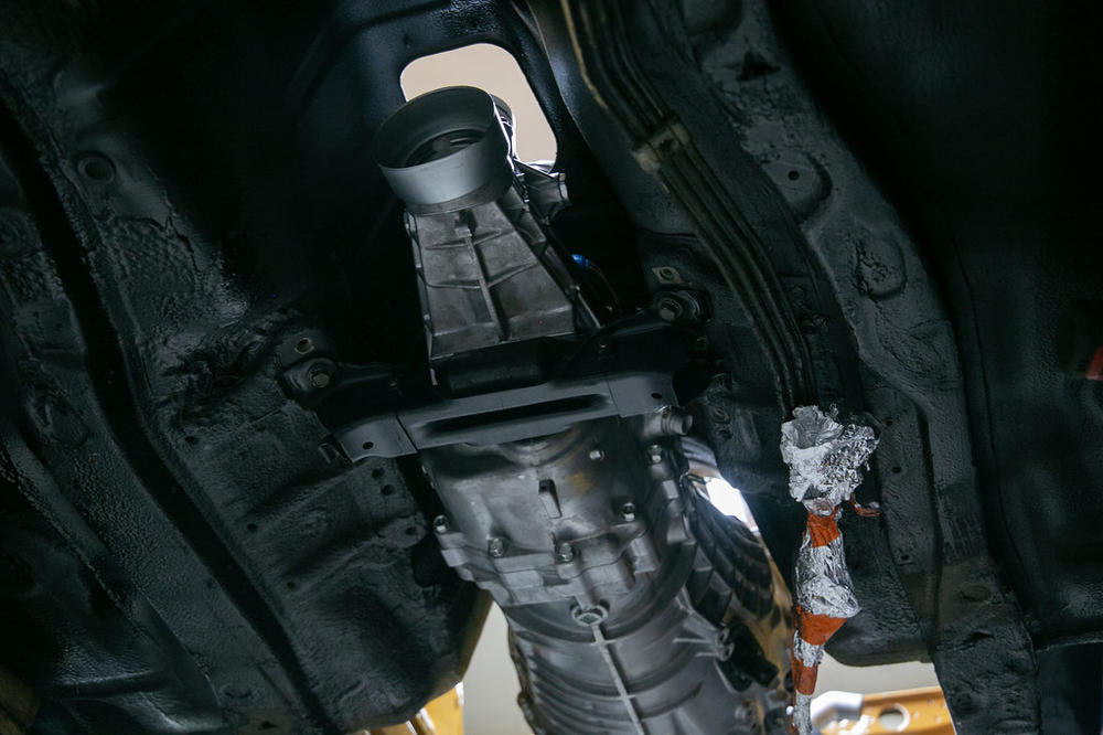

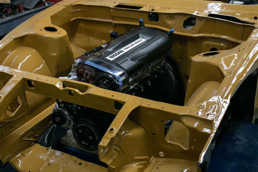

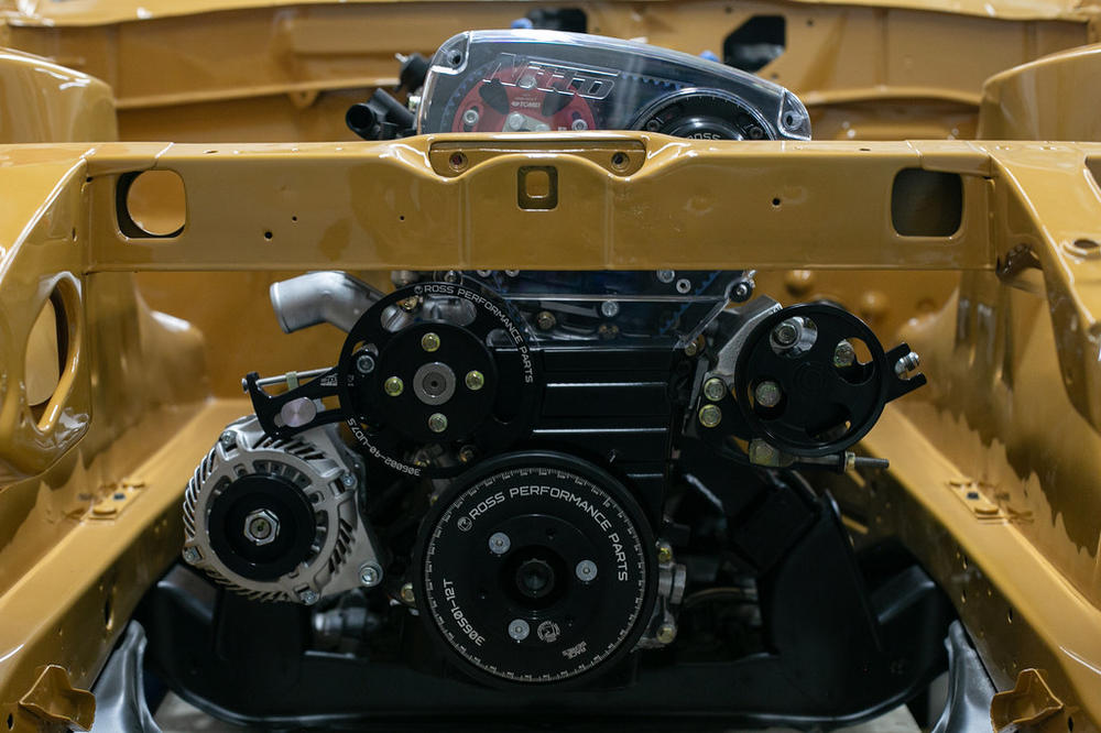

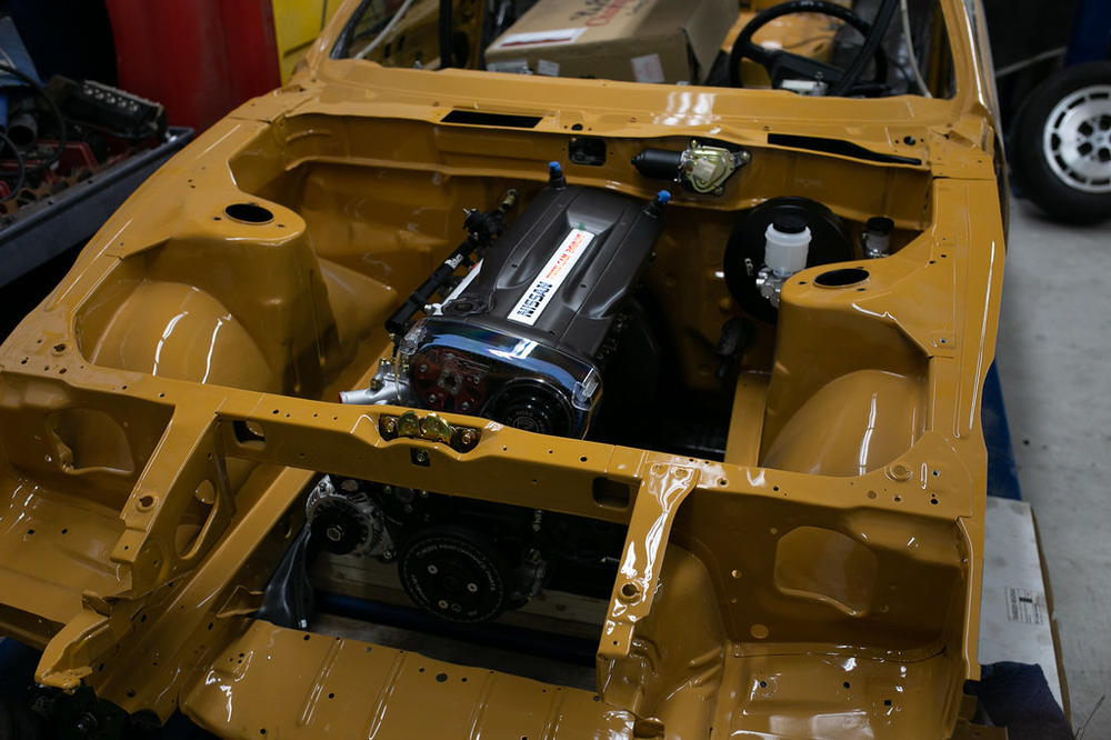

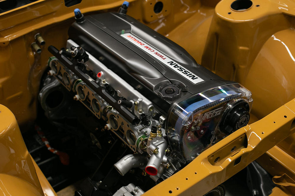

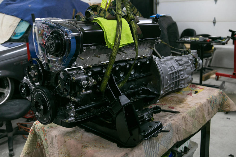

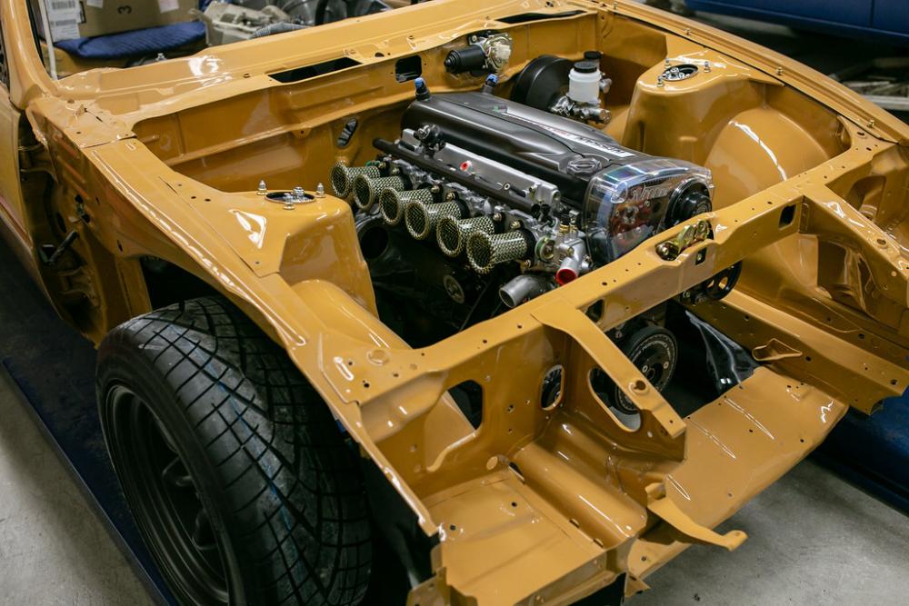

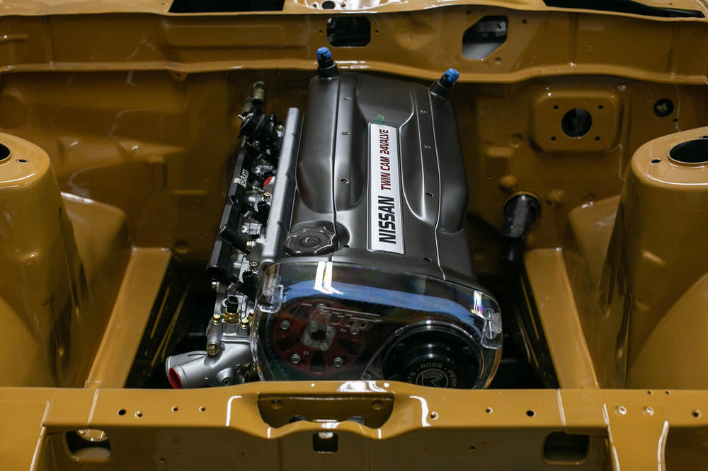

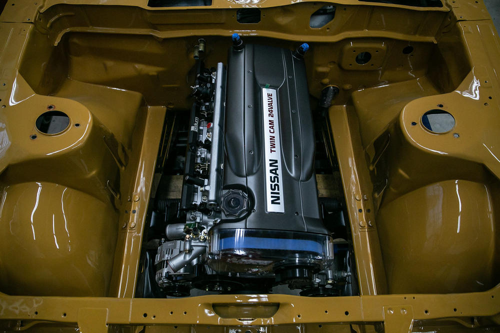

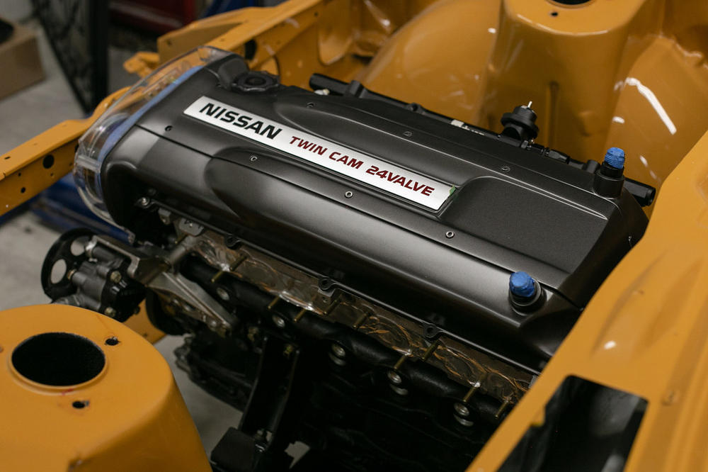

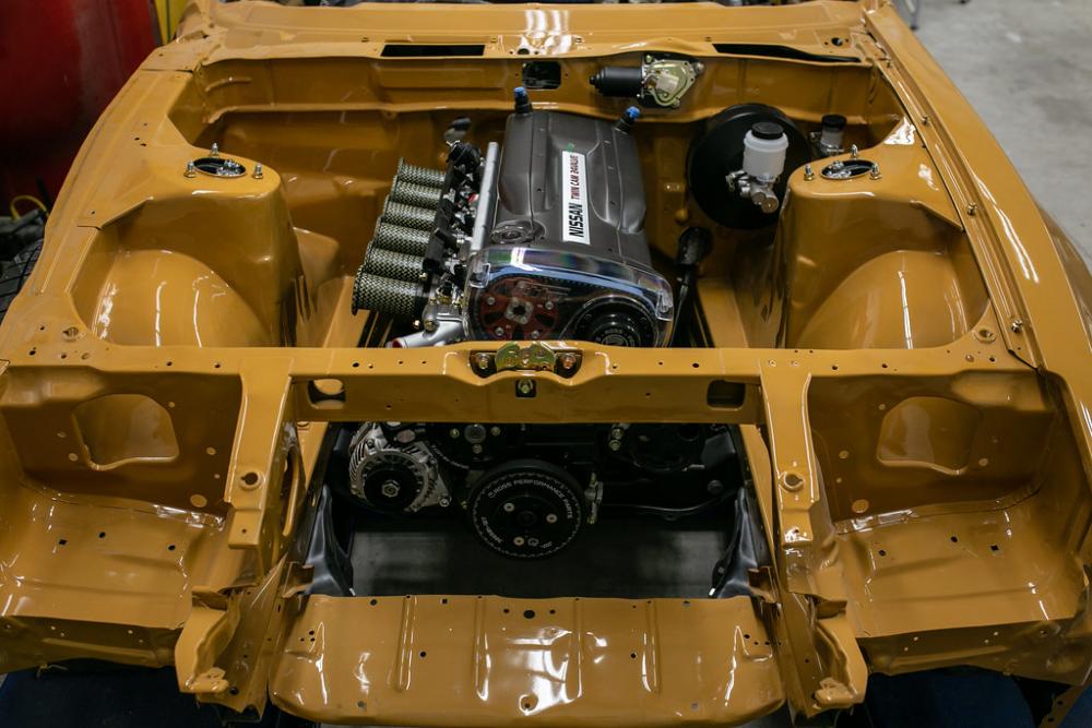

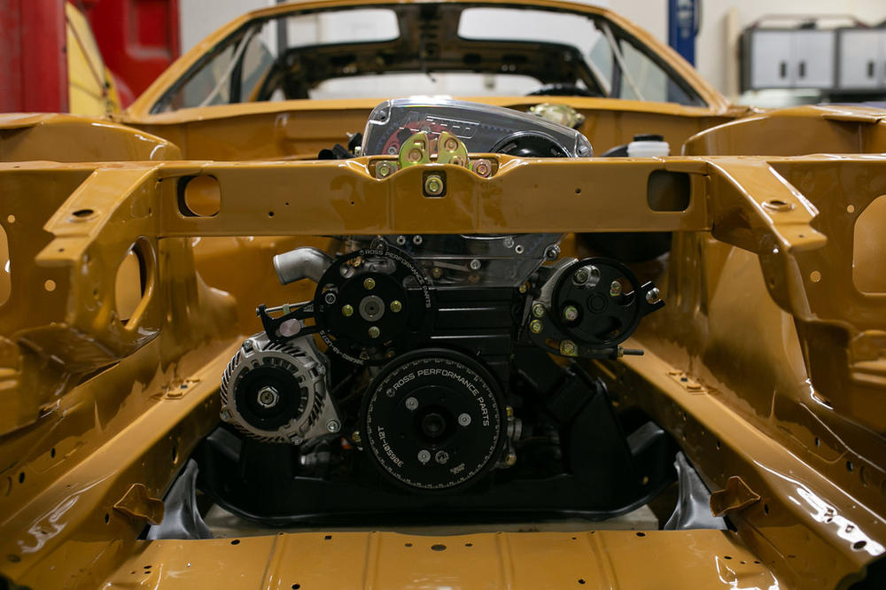

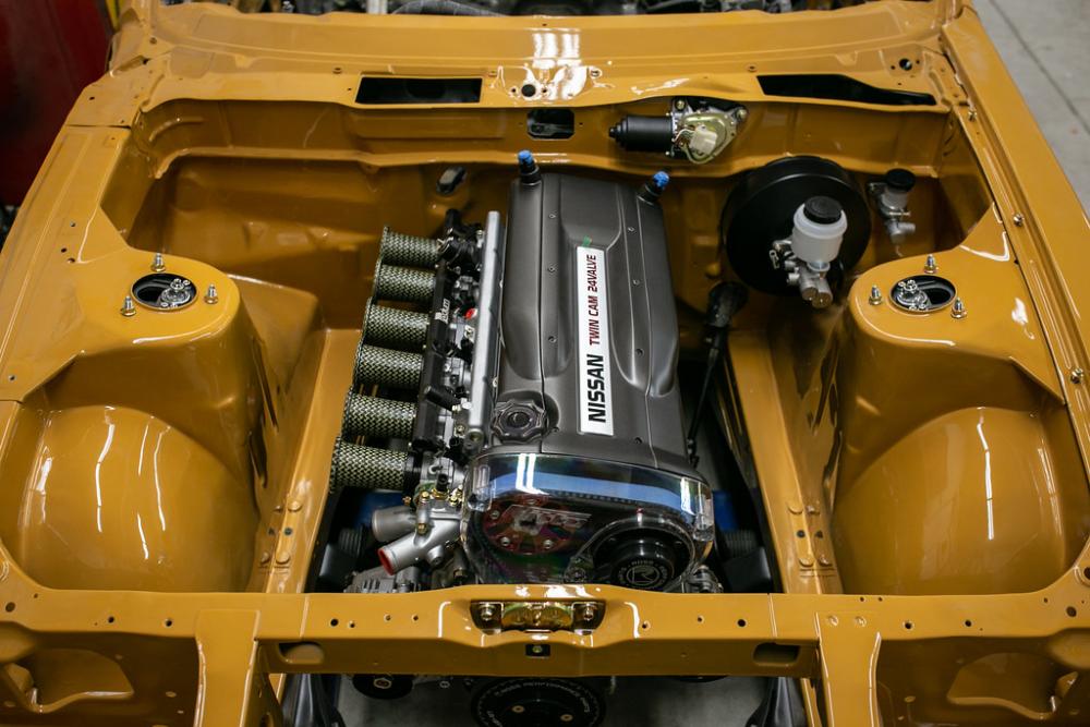

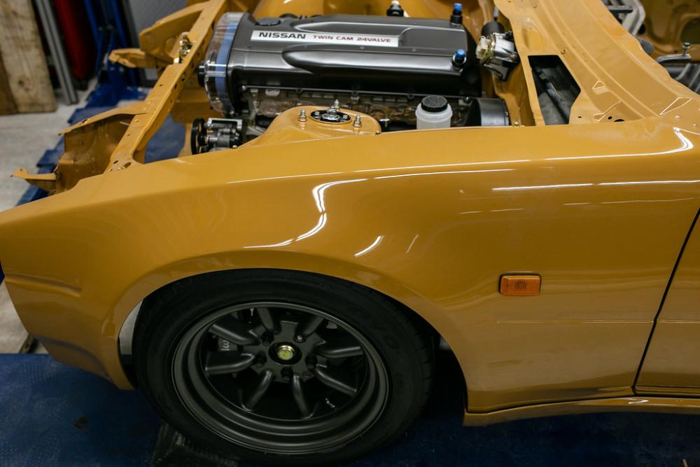

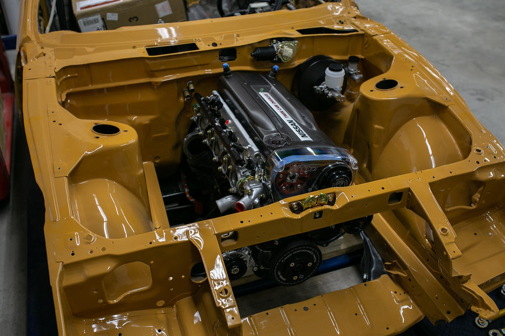

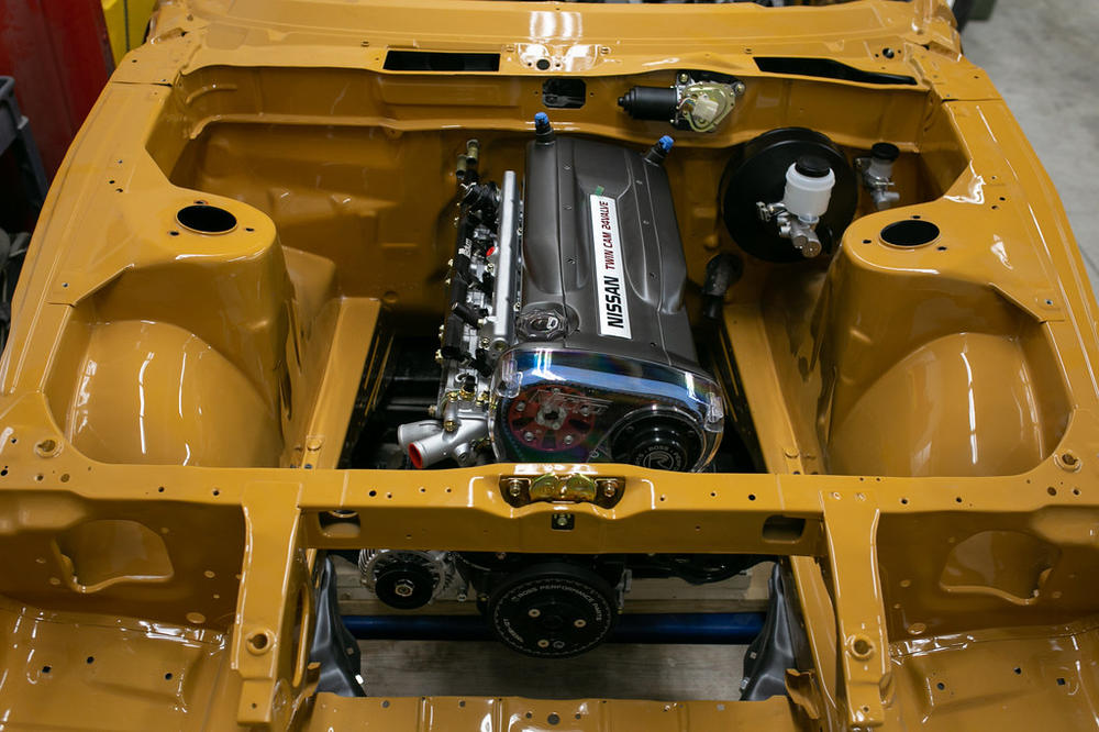

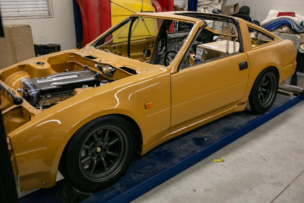

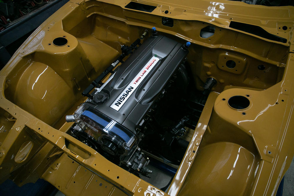

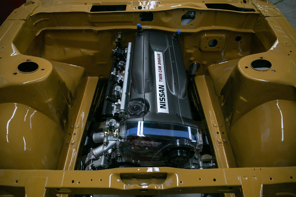

RB is finally in the Z31! My buddy modified the OEM trans bracket to work and the shifter on the R34 transmission lines up dead center in the Z31 hole! We did run into an issue where the Z31 3 row radiator I bought will not fit so wil have to go full custom from the company that will be making the header and exhaust.
  • 1 month later...

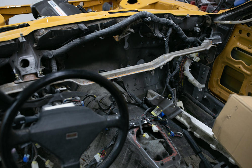

Thanks, Jeff! I am going back over to work on it Sunday. We are trying to get the masters on, wiper motor in, pedal assembly in and the heater core so the dash can go back in. Next month it will go up to MD so that Freed engineering can build the custom one off Titanium Octopus header and full exhaust. It will be work of art and sound similar to a sport bike/F1. Ti has such a unique and exotic sound in addition to looking beautiful and saving weight.

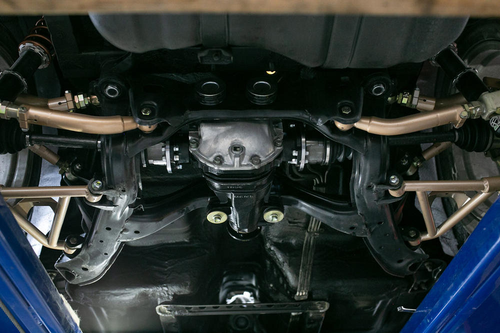

It's about time to install the Infiniti M30 rear R200 VSLD 3.91 diff along with the new S14 240sx CV axles I ordered some time in the next week.

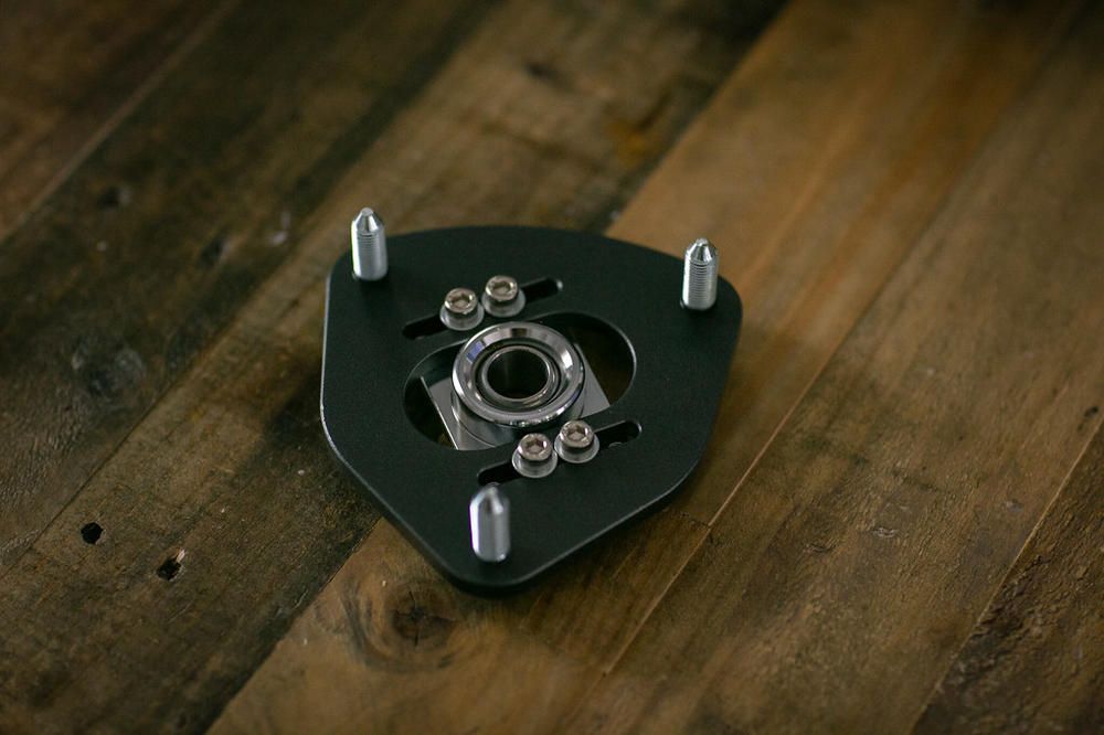

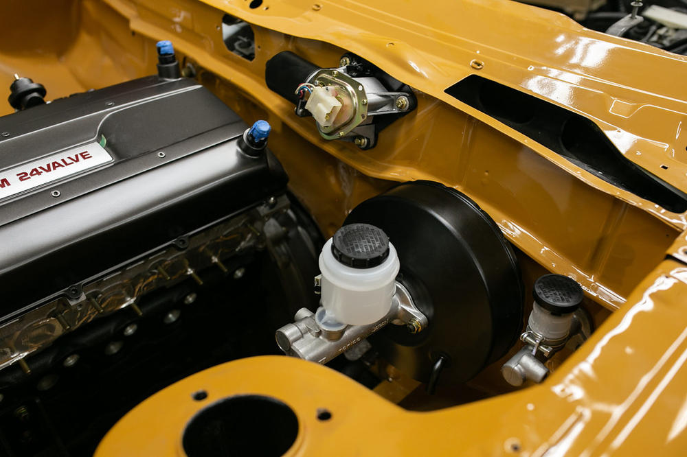

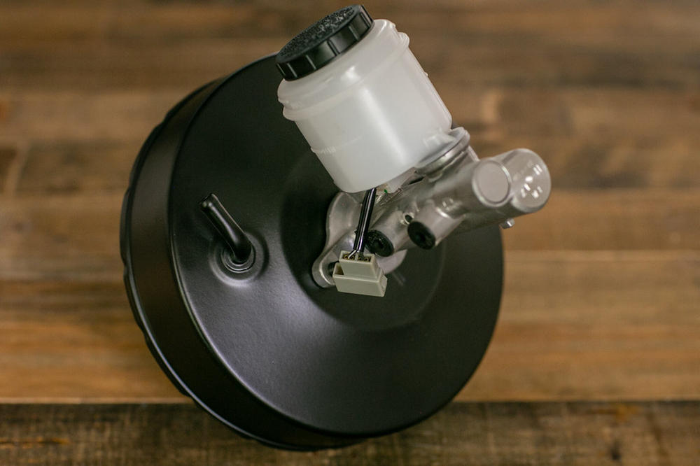

Here is the S13 240sx slim brake booster which was powdercoated, the new brake master cylinder, the freshly plated hood hardware and coolant connecting pipe as well as the freshly powdercoated coilover top plates. The green clashed with the look of the car so I had them done gunmetal.

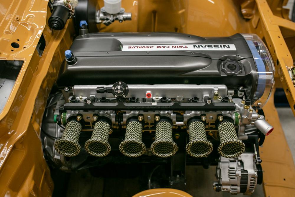

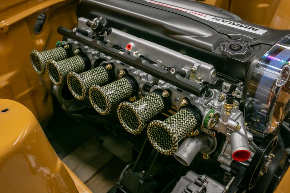

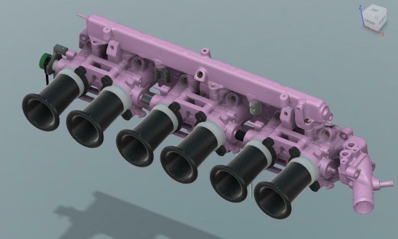

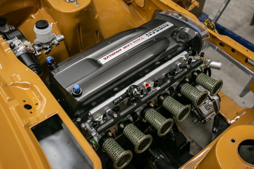

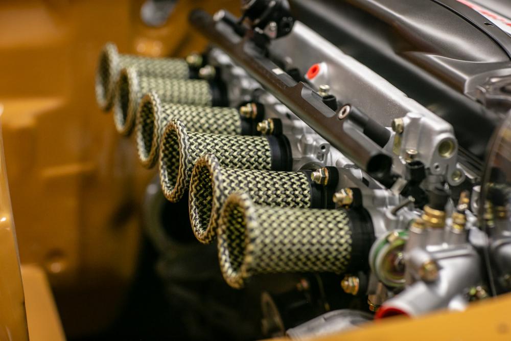

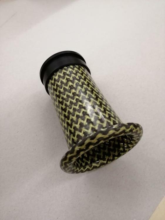

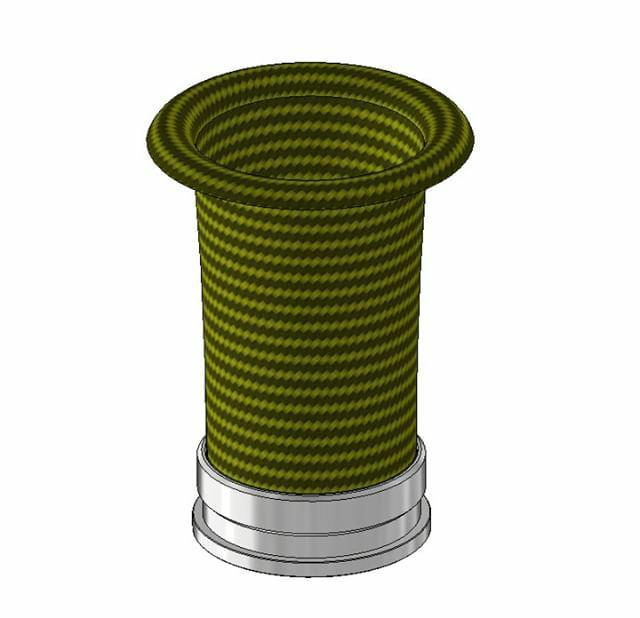

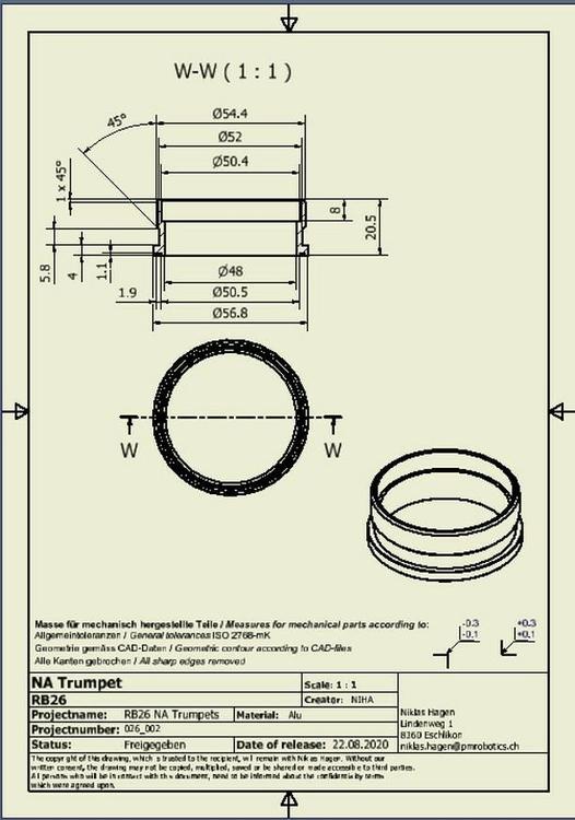

The place in Sweden has finished 5 of the 6 carbon kevlar velocity stacks so they should be on the way soon too. It's coming into the final stretch now.

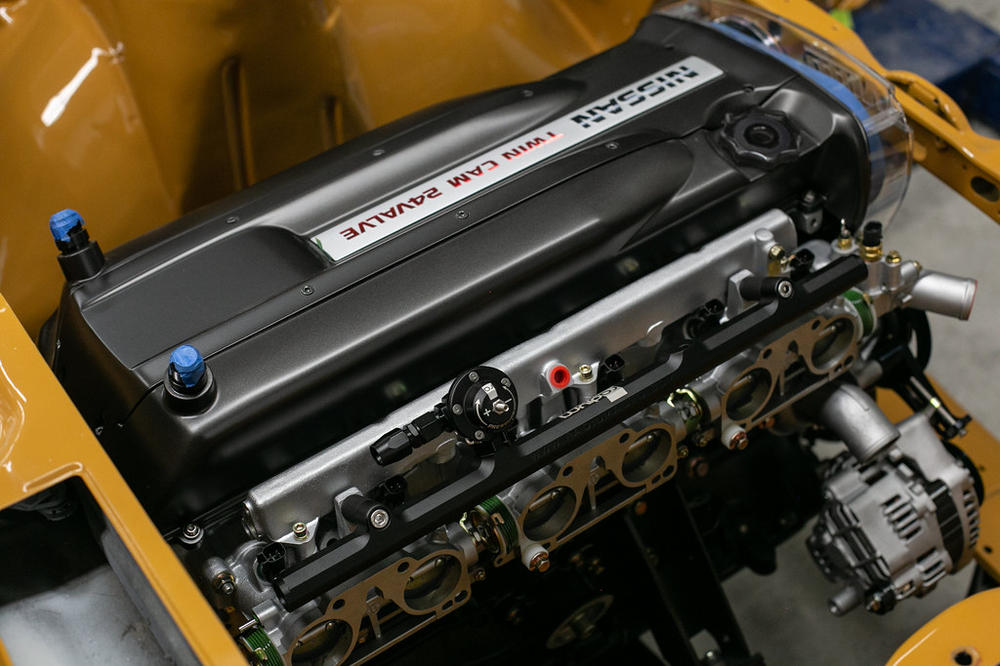

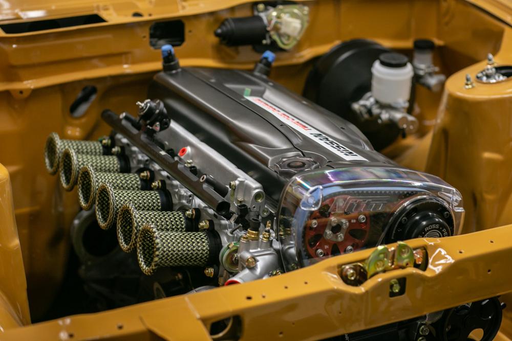

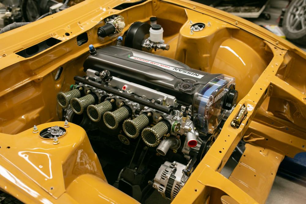

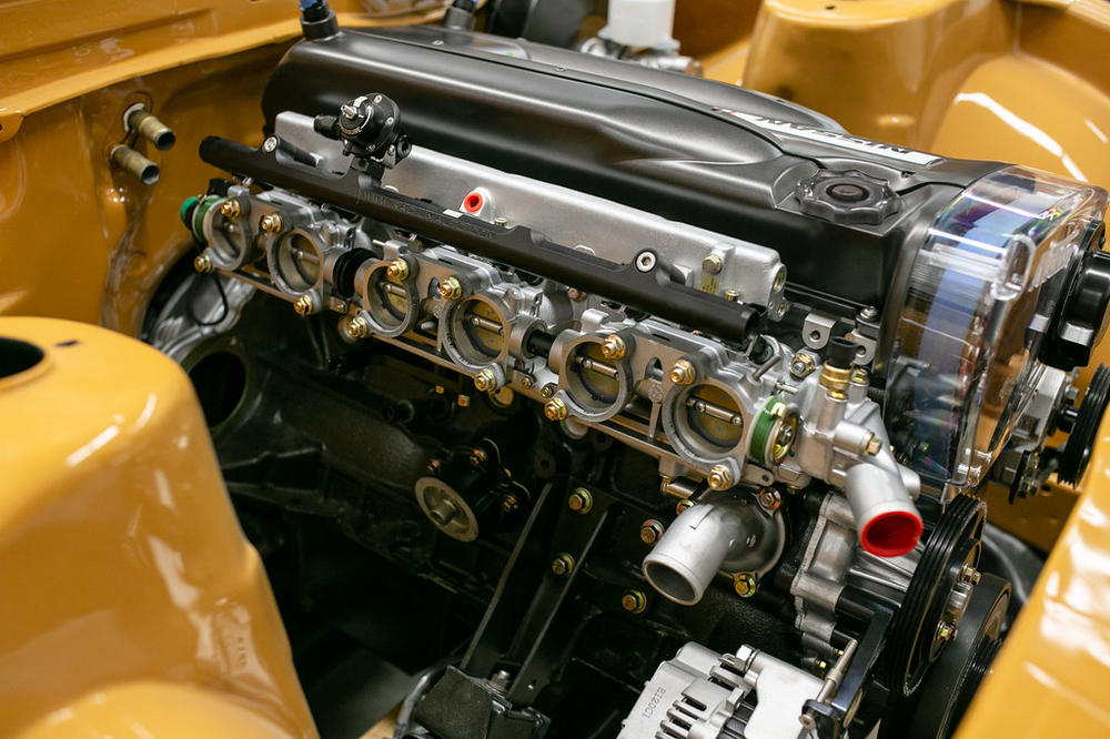

Velocity stacks are made and should be shipping to me this week.

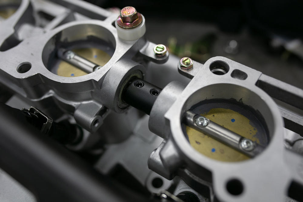

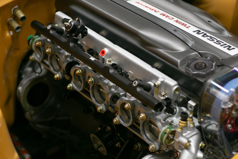

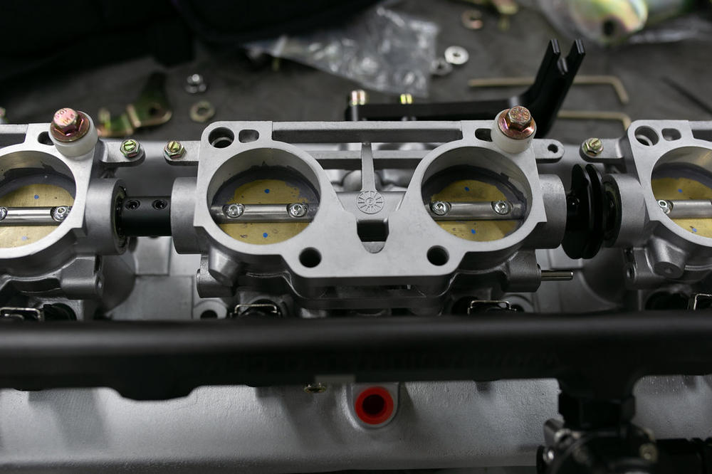

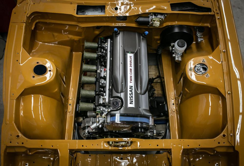

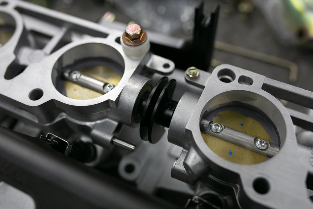

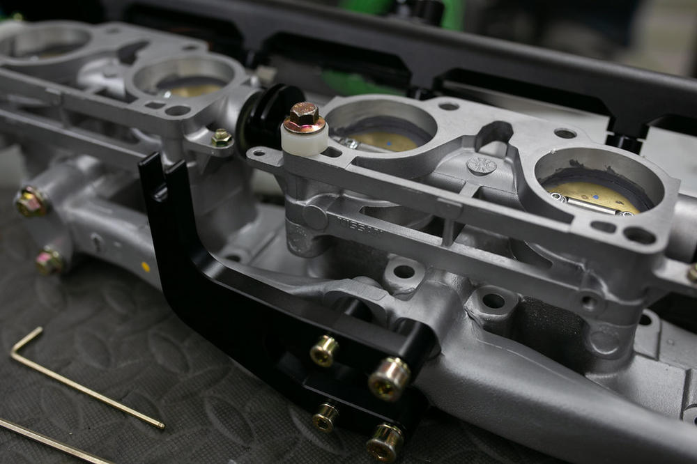

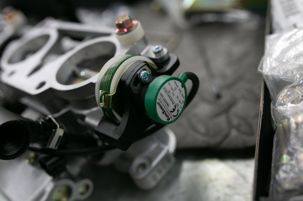

ITB's are torqued and the nturally aspirated linkage is installed along with the TPS.

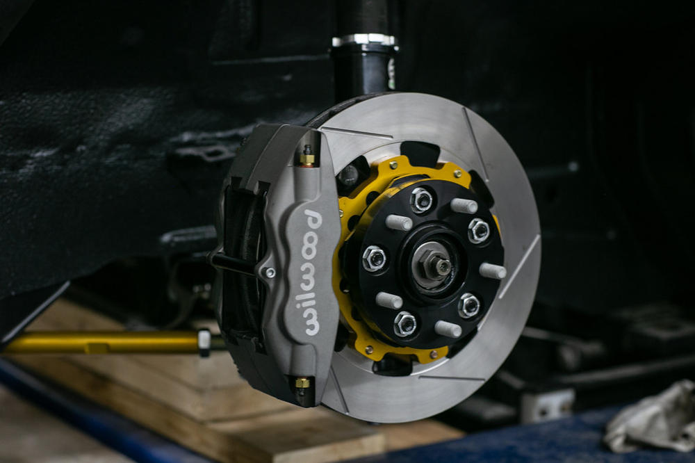

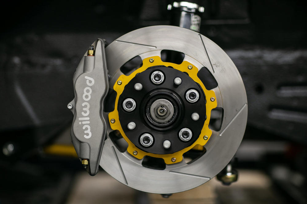

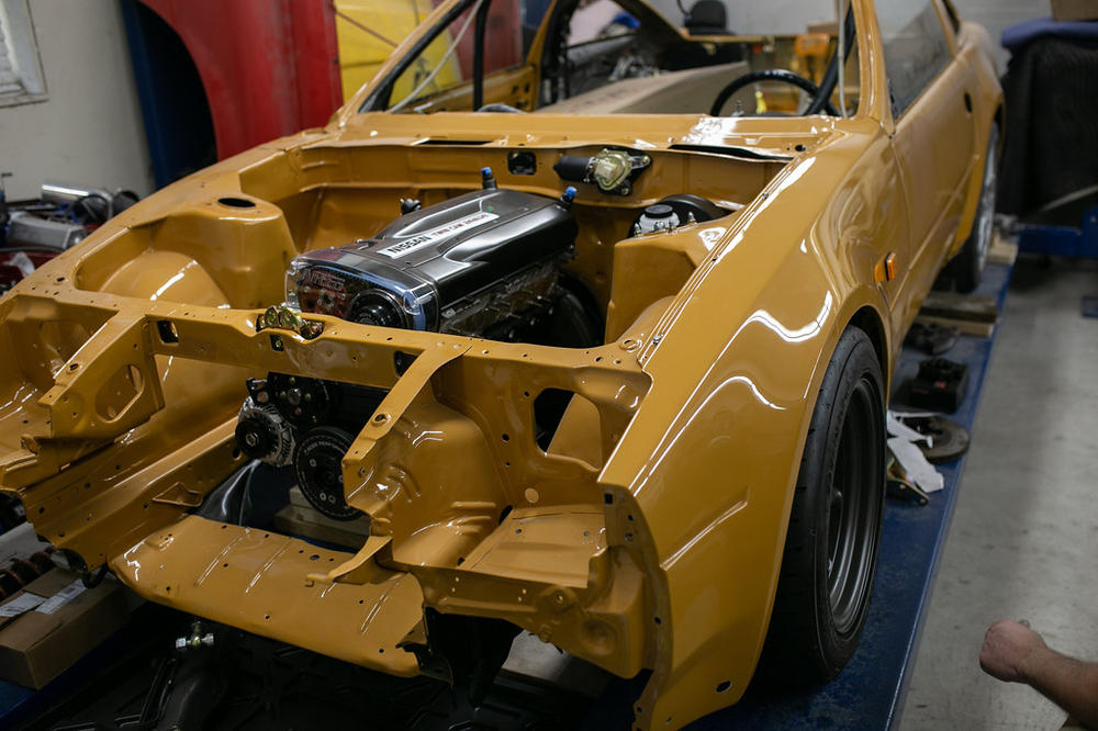

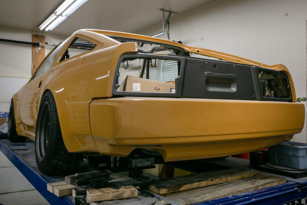

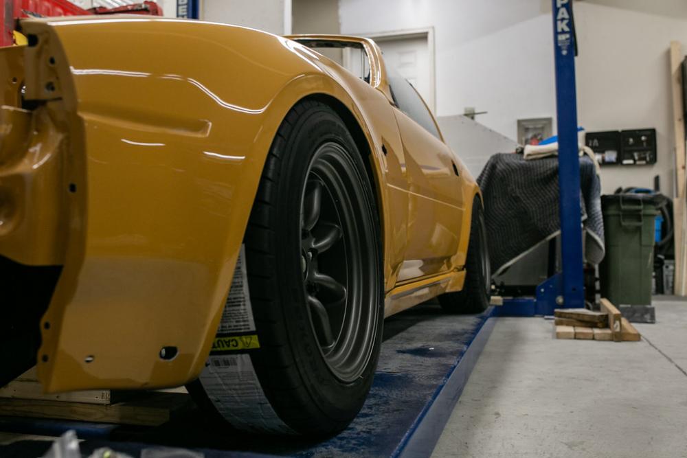

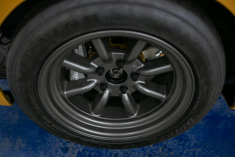

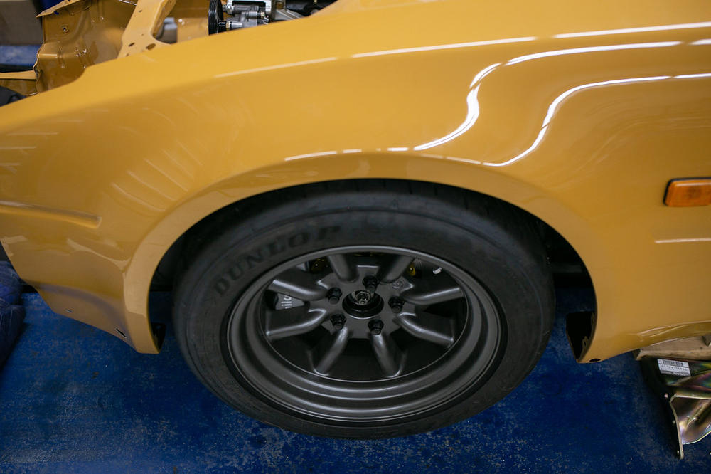

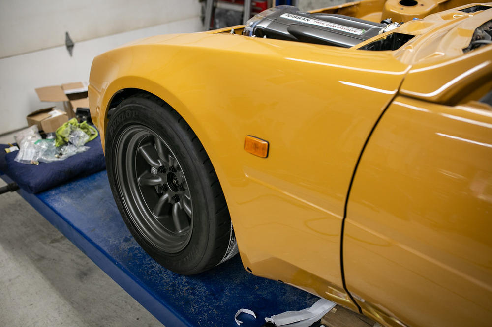

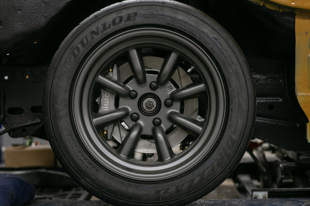

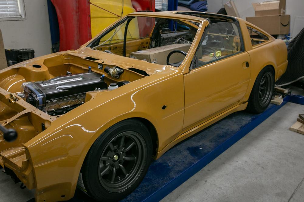

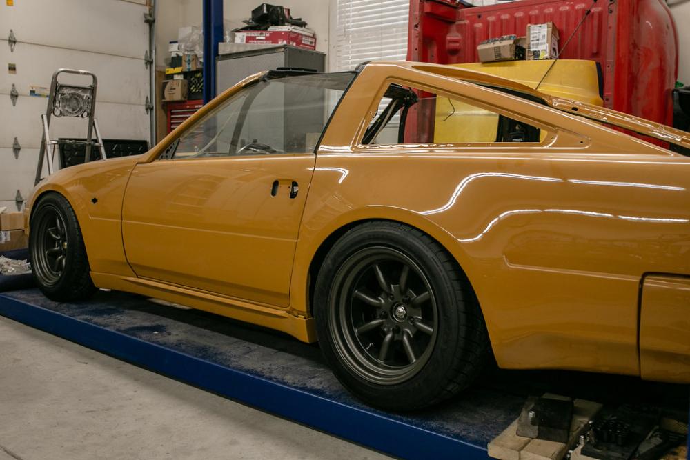

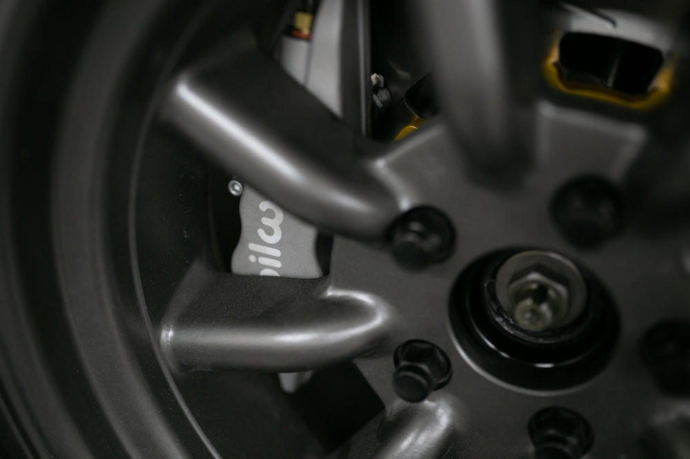

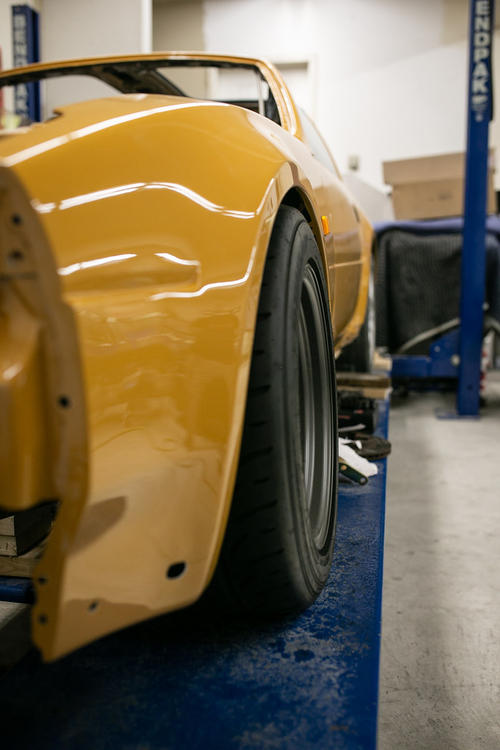

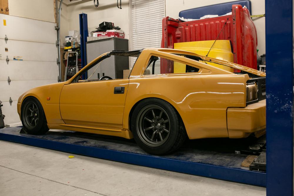

The wheels fit (barely) with the 20mm spacers. You can hardly fit a business card between the back of the spoke and the caliper. These tires are too wide as well so will be able to get pretty low with the 195's. Got the diff and axles in as well. First day in a long time working on the car where everything just went as planned.

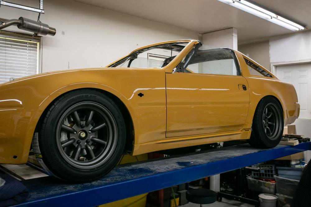

First time working on the car again in 3 weeks.

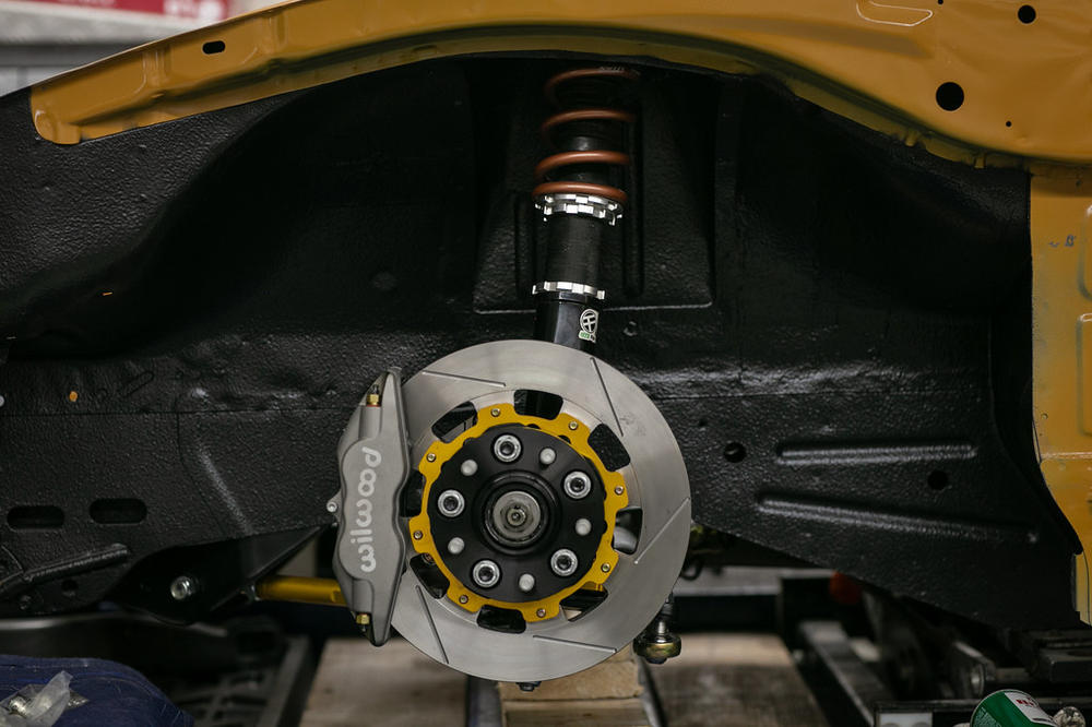

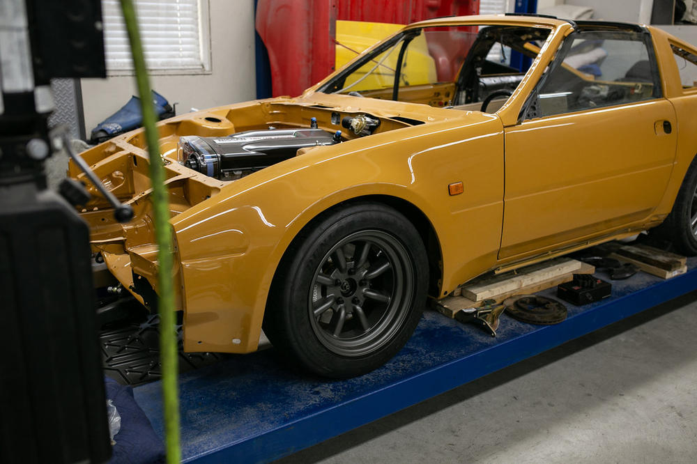

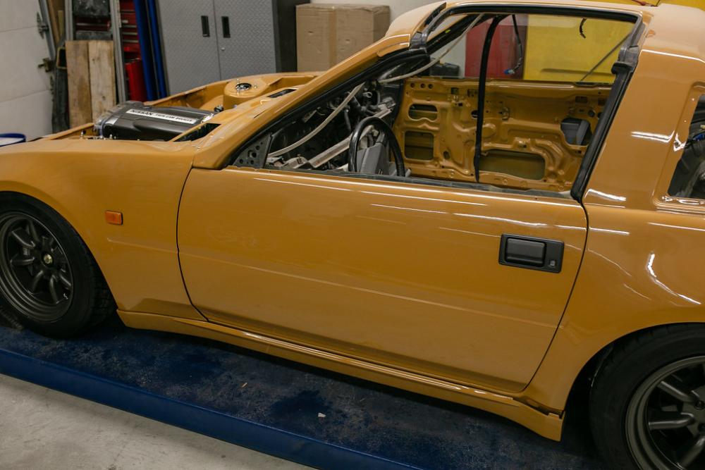

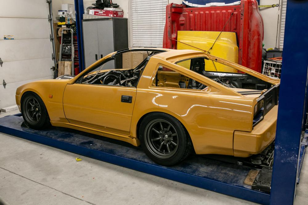

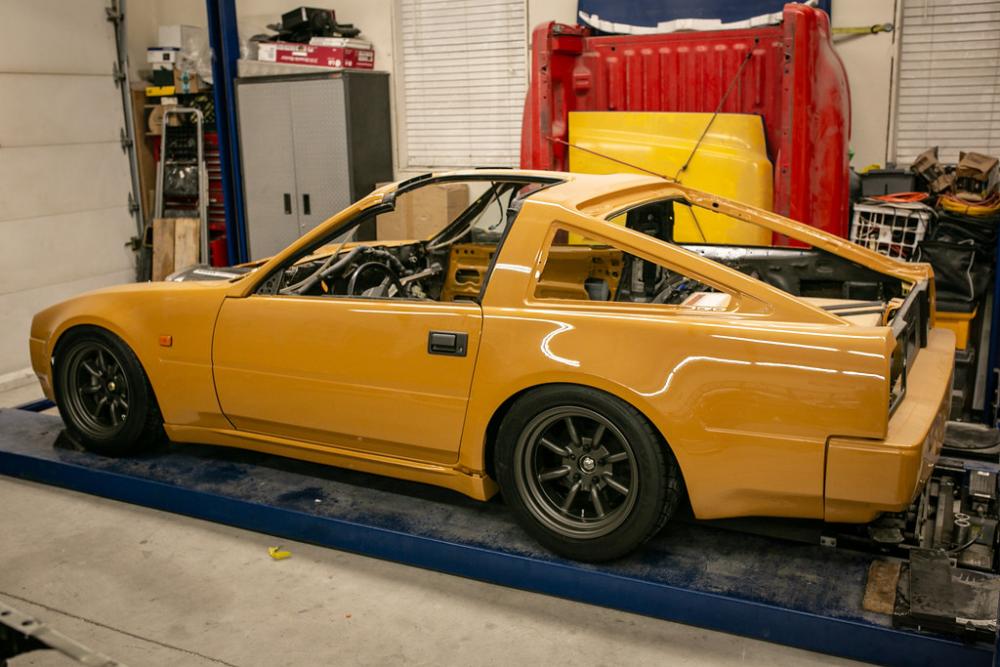

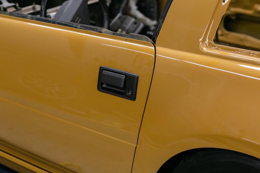

Got the passenger front side suspension and brakes installed and all 4 corners roughly dialed in at the final ride height and a very rough base alignment by eye. Steering is hooked up and got the driver side NOS door handle installed with all the linkage hooked up. Planning on getting the heater core and blower motor back in next weekend along with the dash and then it is ready to go up North for header, exhaust, radiator, catch can, power steering/coolant reservoirs and driveshaft. Then it will come back for rear brakes, wiring, fuel setup and final assembly before it goes for alignment and tuning. After all that, it will be fully wetsanded, buffed and then the entire car will be wrapped in Xpel clear film.
