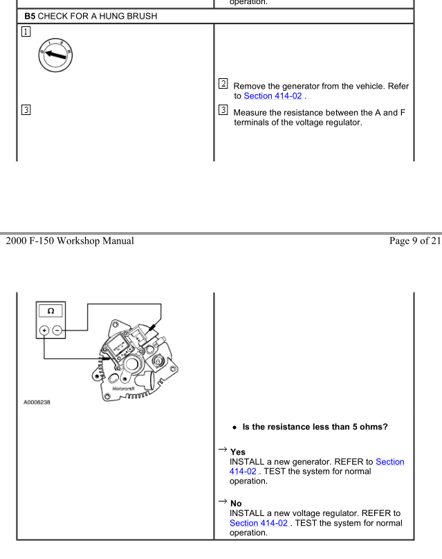

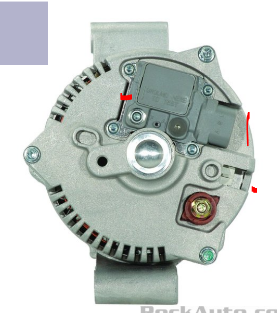

Here's a shot of a typical alternator and regulator.  There's a three pin plug with an A, S, and I.  A jumper wire from A runs over to the small one pin plug.  The back of the regulator has an A and an F terminal with F exposed for testing.  Instructions that say "ground here to test" molded right in to it.  The manual has a test procedure that illustrates checking the slip ring for grounding, a "hung brush' test using A and F resistance, some loose fuse and connection tests.  All pretty interesting but it might just be more direct for me to remove it and take the regulator and brushes off and inspect.  Pretty usre it has 75,000 miles on it.  Debating...

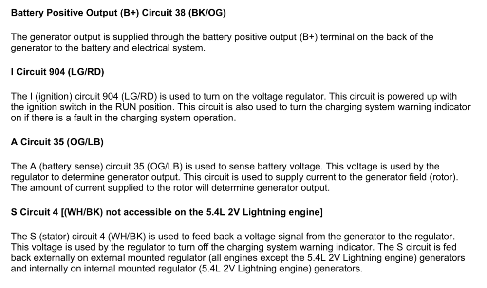

Here's a shot of the test instruction overview.  Of course, "S" does not mean Sense.  Gotta learn a new language now.

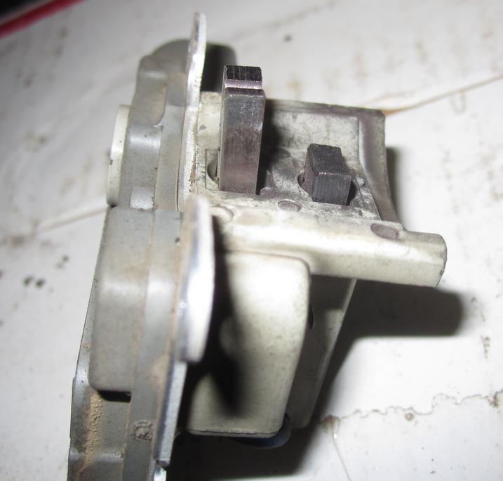

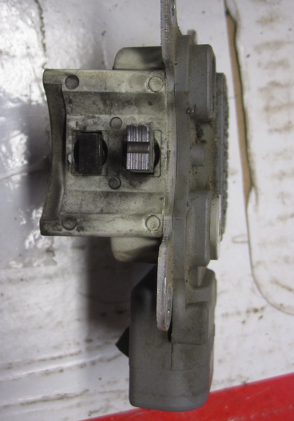

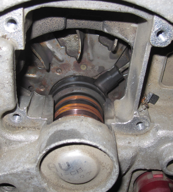

But, with Google as my guide, and my $6 eBay service manual, I was able to get it pretty well figured out.  Attached some pictures.  The only test it failed was resistance across A to F.  3.3 ohms instead of the 5 limit, the "hung brush" test.  Wasn't really hung, just gone.
