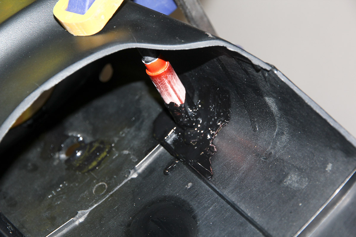

If you can't find a replacement, the mounts can be repaired relatively easily. Most of mine had been broken off as well. I found some pens at my office that were approximately the same size as the mounts, then glued them in place and reinforced with some fiberglass. A bit fiddly, but worked really well.
