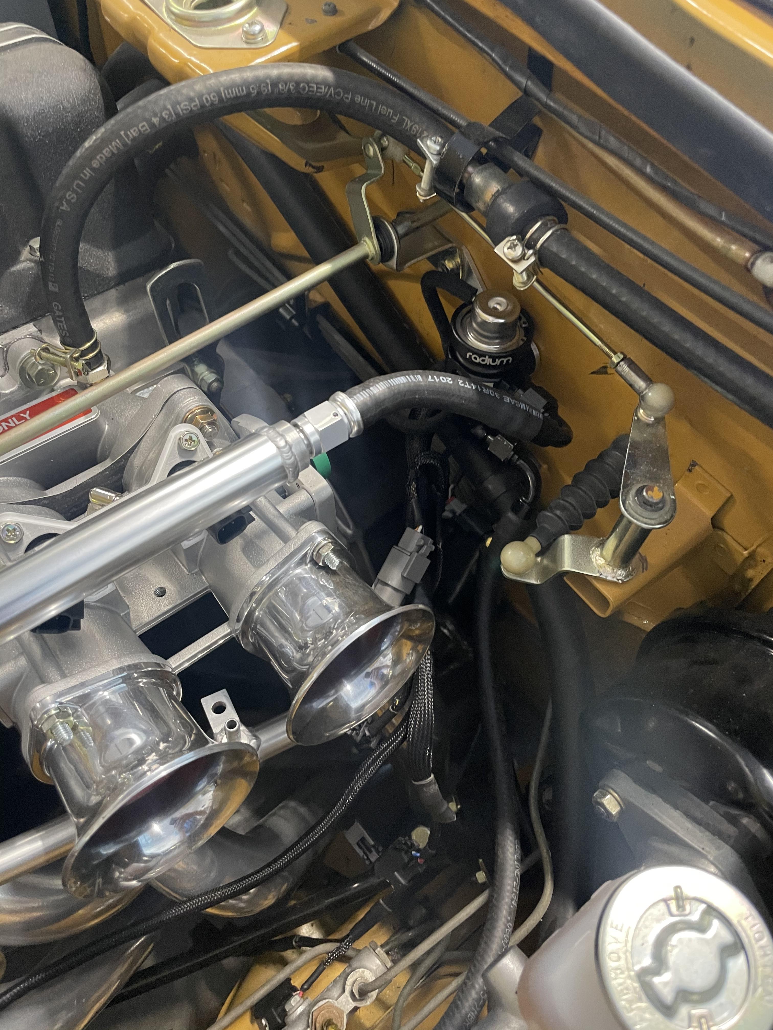

May 18, 20214 yr Author comment_621750 I went with clear anodized fuel fittings. I think it gives it a vintage look. My fpr mount works awesome. Link to comment https://www.classiczcars.com/forums/topic/58568-duffys-171-series-1-240z-build/?&page=60#findComment-621750 Share on other sites More sharing options...

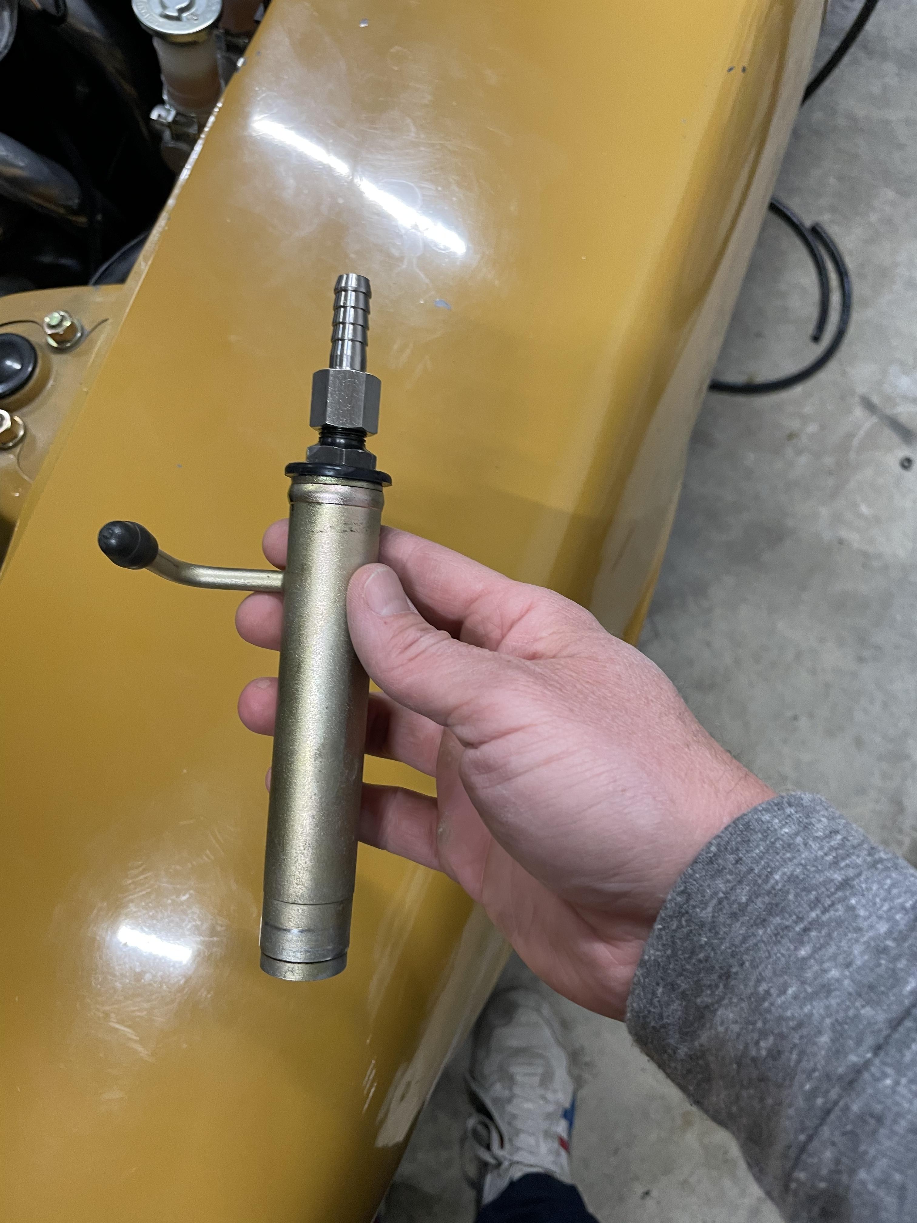

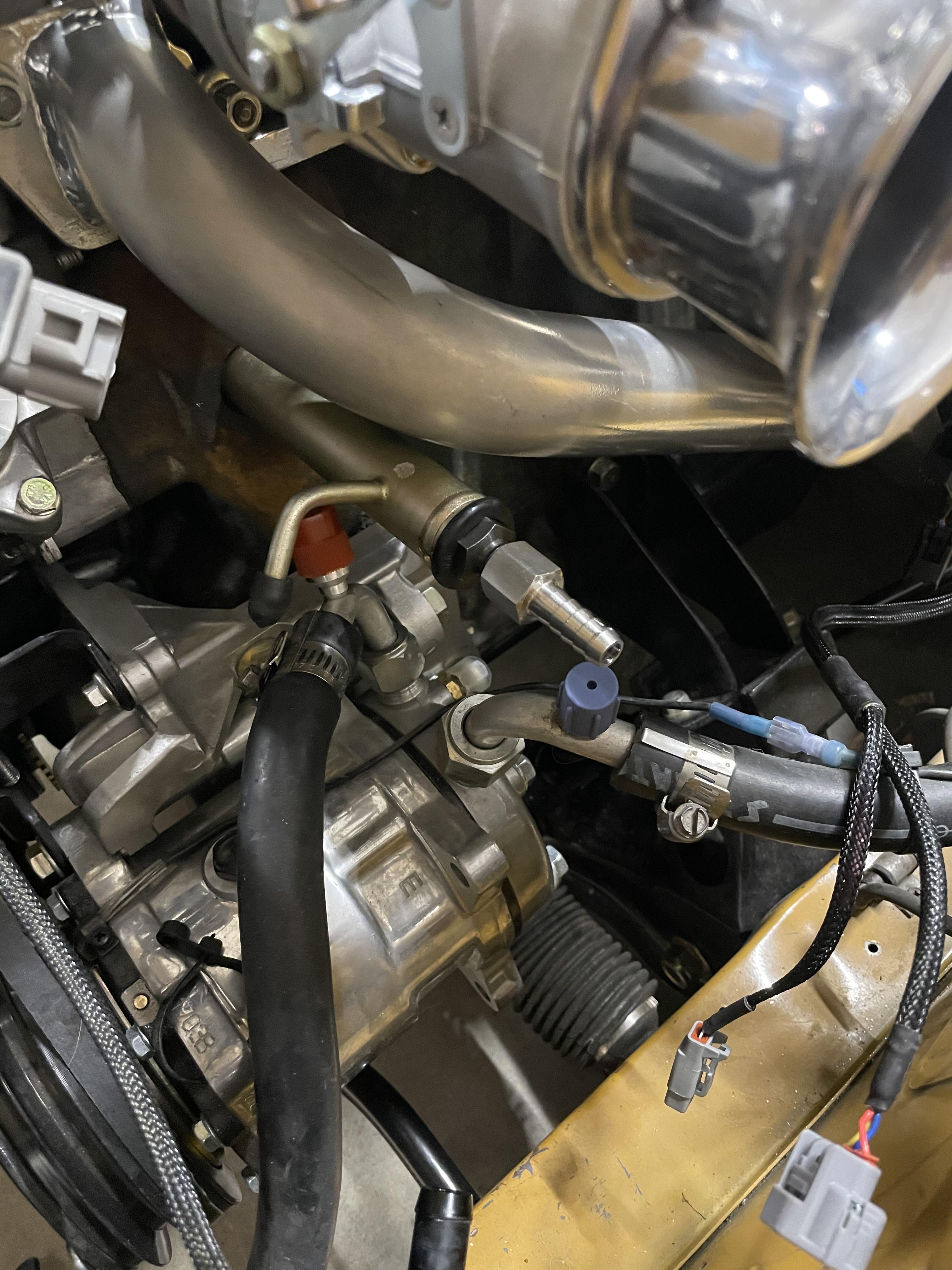

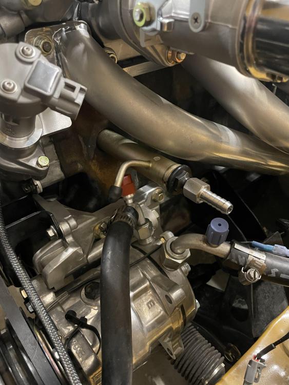

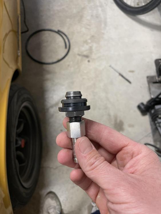

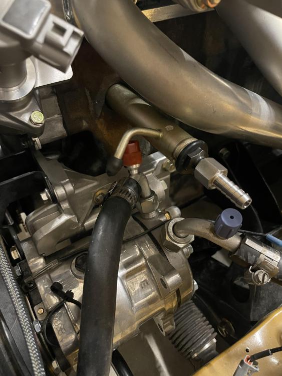

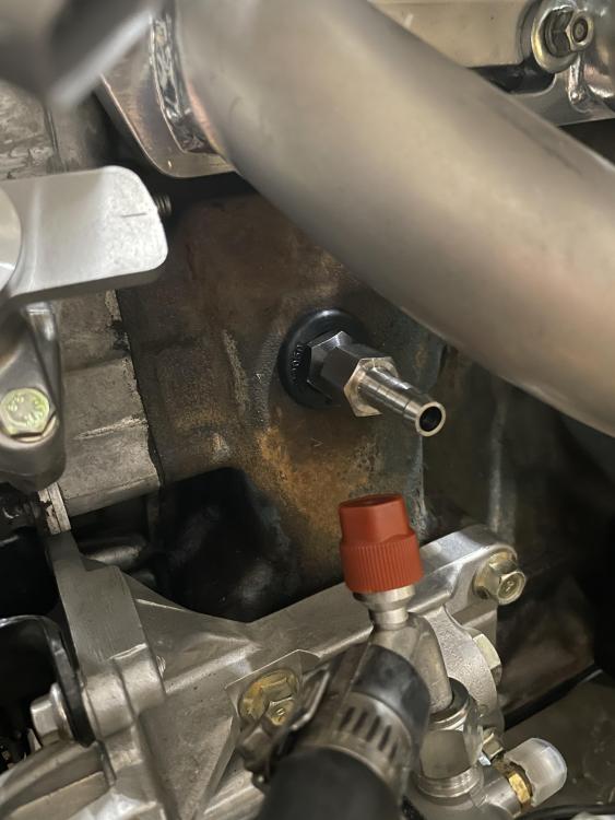

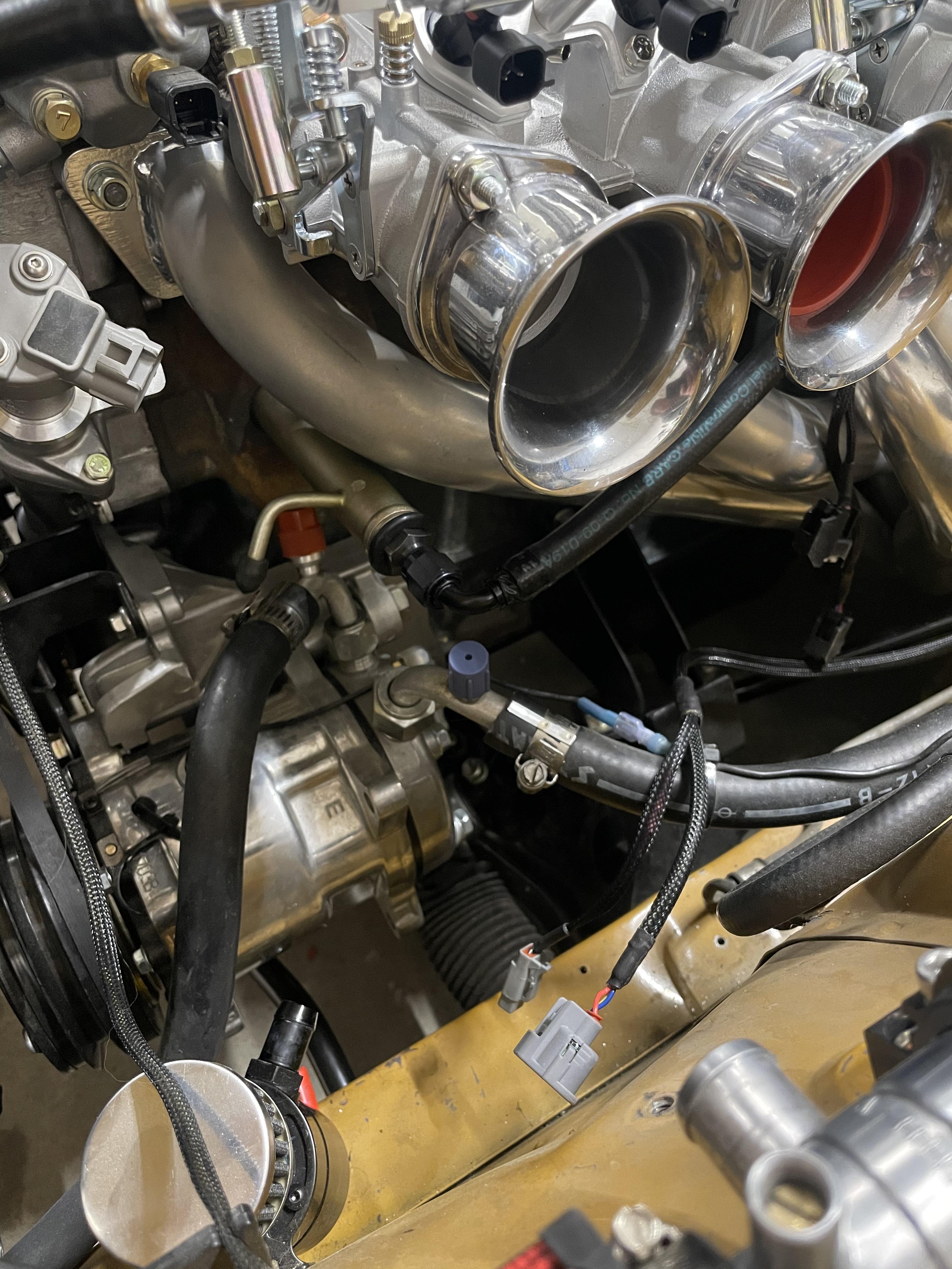

May 19, 20214 yr Author comment_621814 Next is figuring out pcv and ITB. This idea came from Tony Degara. Pretty darn genius and simple! This utilizes the stock pcv valve and it will feed directly into the center of my vacuum balance bar. The AN fitting is just for mock up, but I love the look. I think using the stock crank case tube works the best since it gets it out past the header. This is some Acura pcv grommet. I got another one that works directly into the block. Link to comment https://www.classiczcars.com/forums/topic/58568-duffys-171-series-1-240z-build/?&page=60#findComment-621814 Share on other sites More sharing options...

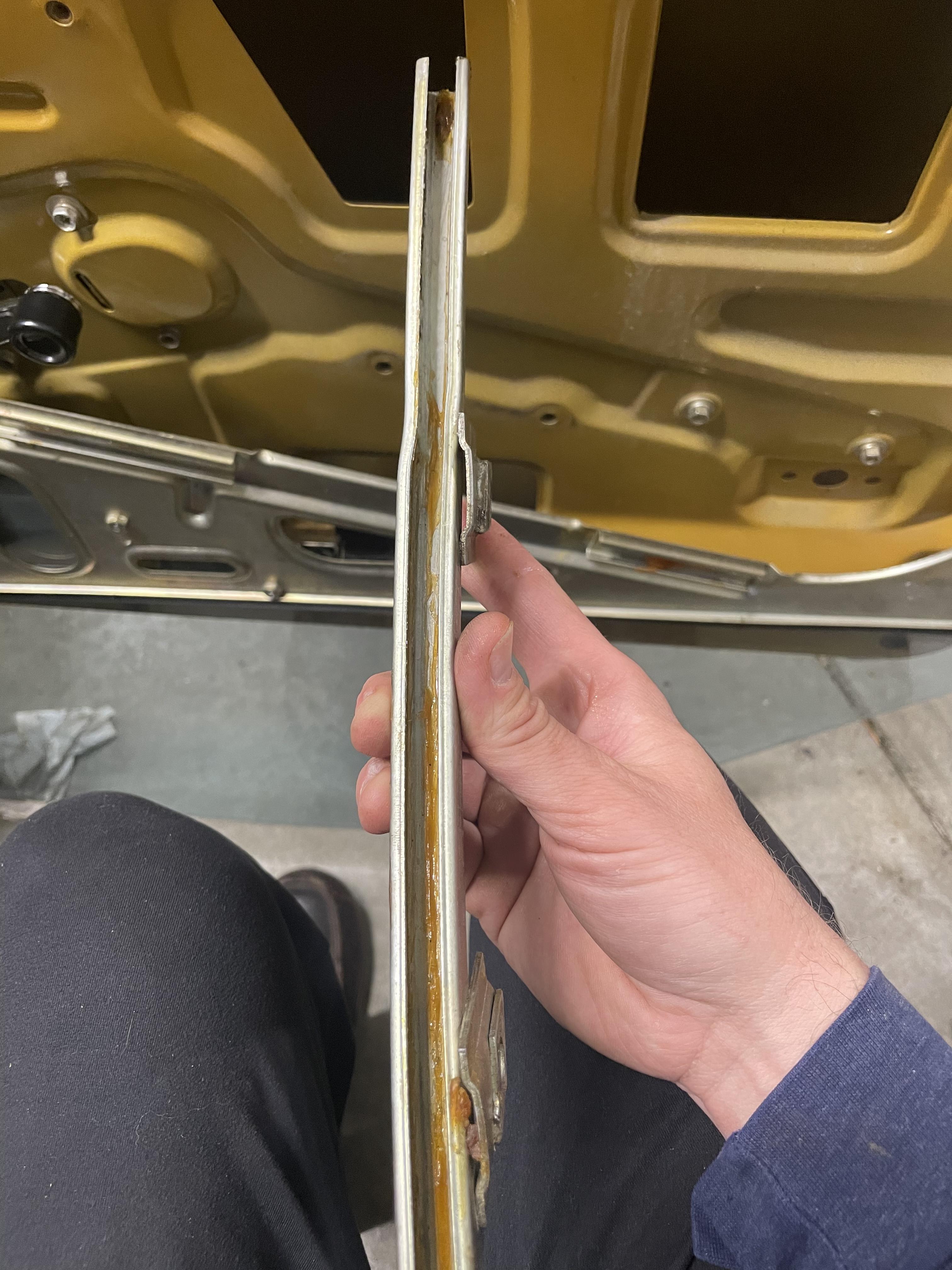

May 31, 20214 yr Author comment_622464 Somehow this window track was bent? Seems impossible. Link to comment https://www.classiczcars.com/forums/topic/58568-duffys-171-series-1-240z-build/?&page=60#findComment-622464 Share on other sites More sharing options...

June 1, 20214 yr comment_622530 Got to say - surprised anyone messes with the spray bars . Looks like a new one , but they still scare me Link to comment https://www.classiczcars.com/forums/topic/58568-duffys-171-series-1-240z-build/?&page=60#findComment-622530 Share on other sites More sharing options...
June 1, 20214 yr Author comment_622555 5 hours ago, madkaw said: Got to say - surprised anyone messes with the spray bars . Looks like a new one , but they still scare me My engine builder loves them, it's a brand new one. You like internal? Link to comment https://www.classiczcars.com/forums/topic/58568-duffys-171-series-1-240z-build/?&page=60#findComment-622555 Share on other sites More sharing options...
June 2, 20214 yr comment_622571 There wasn’t any suitable replacements forever and running a used one wasn’t thrilling to me . I’d say there’s more to go wrong with the pipe attached to the cam towers then oil coming right out of the cam. Didn’t realize that was a new cam oiler - which is great . Not saying one method is better than another , but it was hard to find new ones . I tried an aftermarket one that I had to modify the valve cover for it to fit -BS .  Link to comment https://www.classiczcars.com/forums/topic/58568-duffys-171-series-1-240z-build/?&page=60#findComment-622571 Share on other sites More sharing options...
June 5, 20214 yr Author comment_622764 On 6/1/2021 at 5:32 PM, madkaw said: There wasn’t any suitable replacements forever and running a used one wasn’t thrilling to me . I’d say there’s more to go wrong with the pipe attached to the cam towers then oil coming right out of the cam. Didn’t realize that was a new cam oiler - which is great . Not saying one method is better than another , but it was hard to find new ones . I tried an aftermarket one that I had to modify the valve cover for it to fit -BS .  Andrew does love a oil spray bar. It would be tough to argue one over the other.  Link to comment https://www.classiczcars.com/forums/topic/58568-duffys-171-series-1-240z-build/?&page=60#findComment-622764 Share on other sites More sharing options...

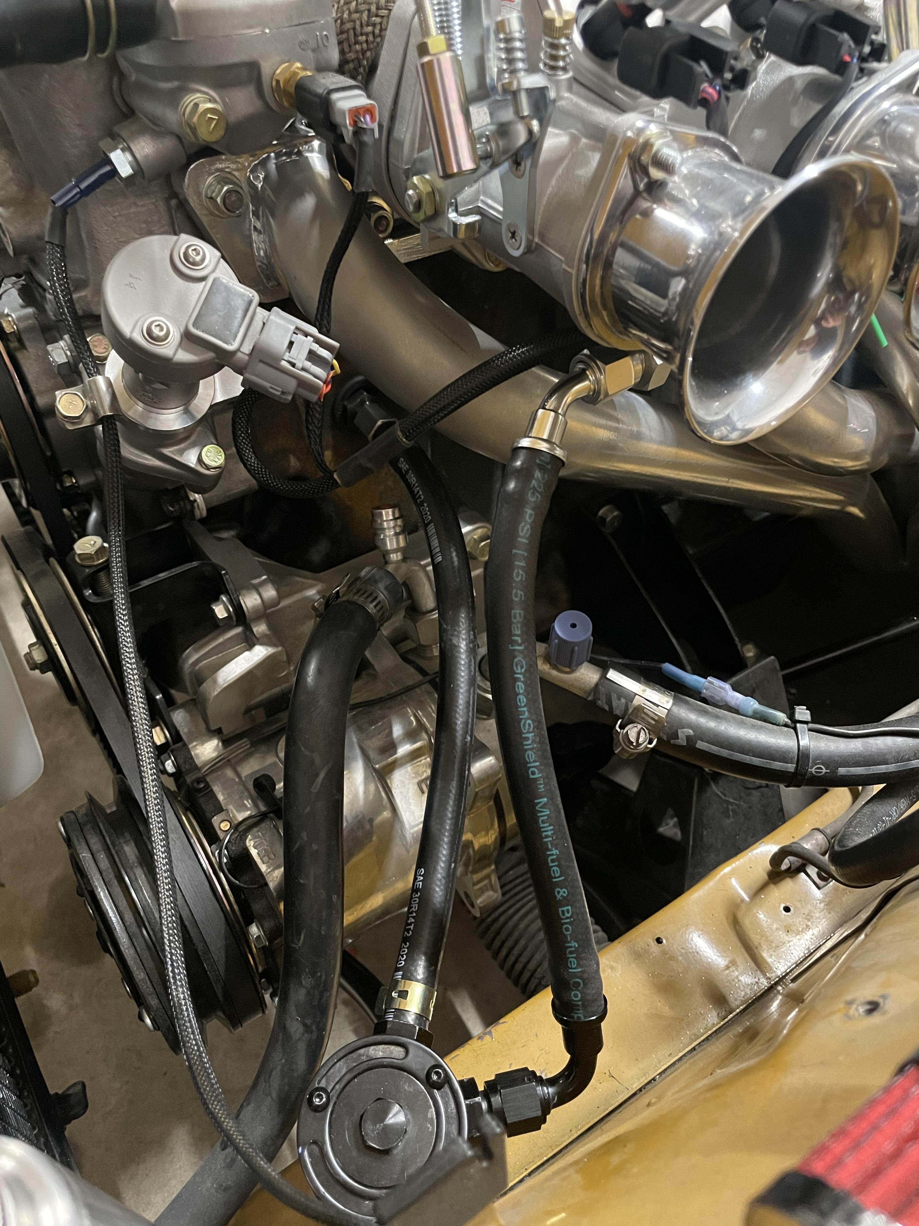

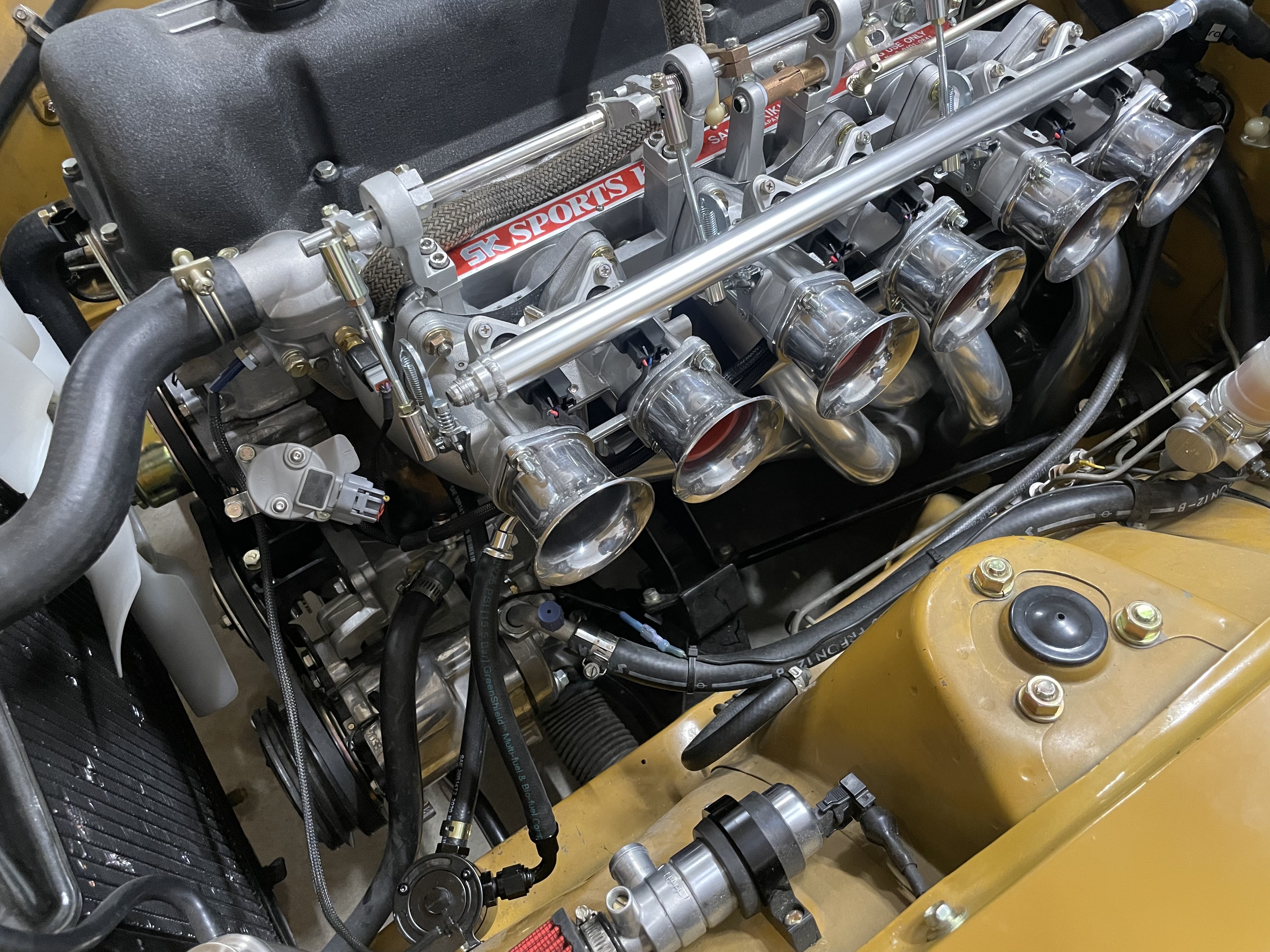

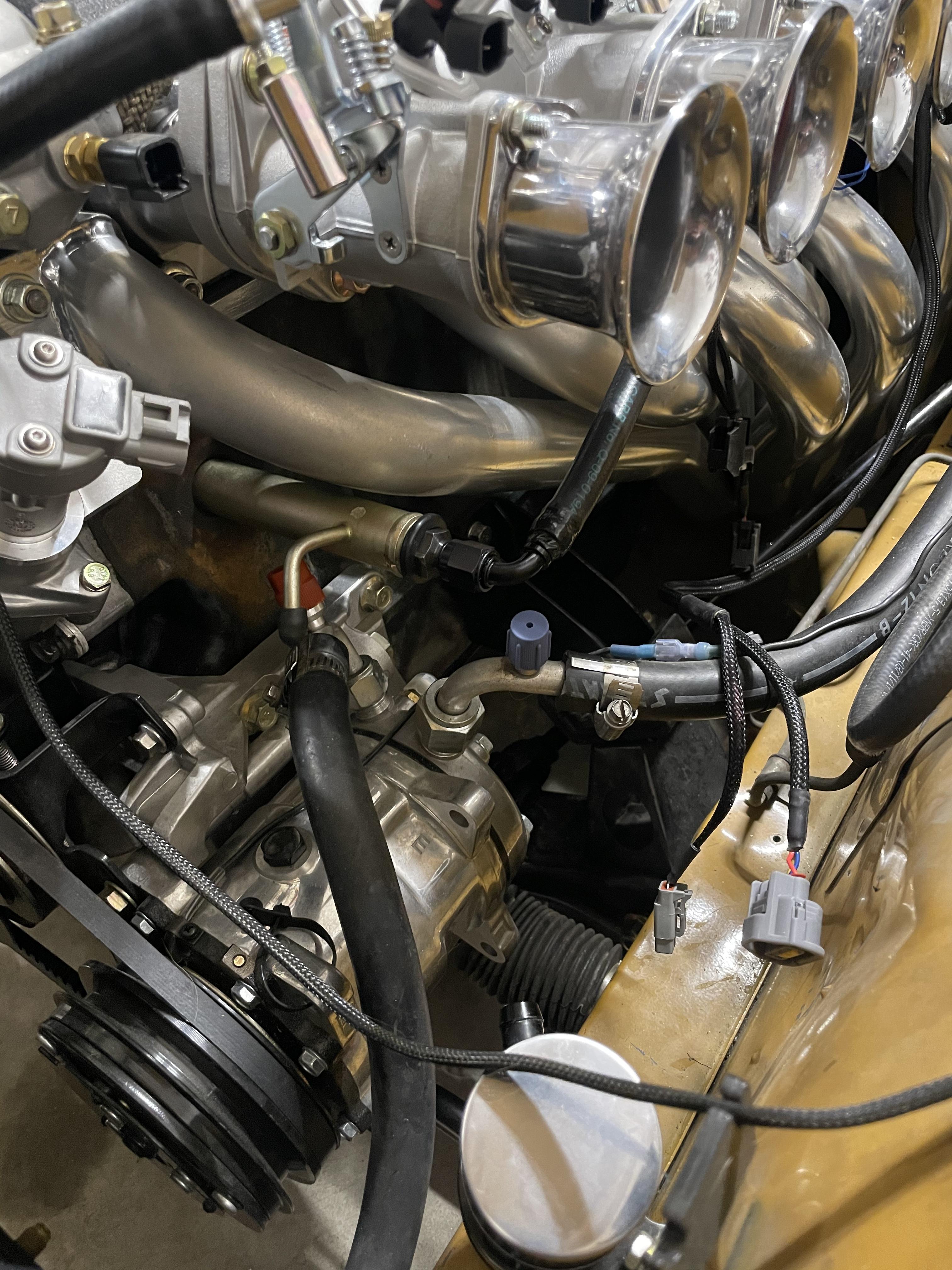

June 6, 20214 yr Author comment_622915 My new current pcv plan. Slightly filtered, oil catched then back into my throttle bodies vac balance log. I will figure out a better filter later on. Link to comment https://www.classiczcars.com/forums/topic/58568-duffys-171-series-1-240z-build/?&page=60#findComment-622915 Share on other sites More sharing options...
