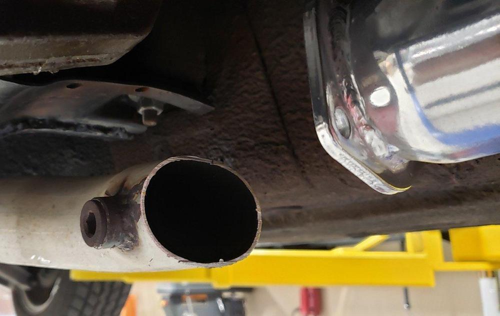

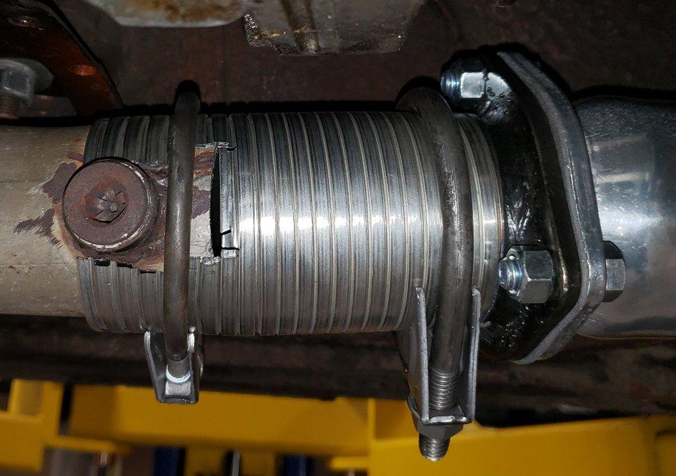

Knowing I needed to do something about the super loud exhaust, I set about a temporary solution to connect the new header to the existing exhaust pipe.  This is so I could finish filling it with coolant, purge any air, and be in a position to drive it to the exhaust shop for something more permanent.  I bought some 2.5 inch flexible exhaust tubing at the parts store and trimmed it to fit the oval shaped opening and around the O2 bung.  Once I was close I closed the hole with some HVAC metal tape.  Not leak proof by any means but sure quietened things down some.
My wife helped me put the hood back on and I got the cooling system filled.  With so much accomplished I decided a quick jaunt down the street was in order.  The clutch action felt really good, brakes worked, the engine ran and rev'd great through the first three gears.  I was honestly shocked as I expected coughing and sputtering from the carbs until they were tuned.  After almost a year, it is back!  All in all, I am super happy to have it back together and running again.  I hope to get it to the exhaust shop next weekend or earlier and start tuning the carbs some.  Stay tuned!
