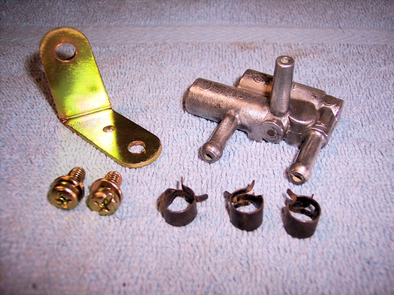

June 15, 20178 yr comment_523191 I think the "vacuum block" mounted to the inner fender (below the coil) is part of the fuel vapor recovery system and leads to the fuel vapor tank mounted in the right side quarter panel. I am relatively new to Z's so mileage may vary.... Also, FYI, BSPT plugs can be found at McMaster-Carr in several different metals (i.e. brass, aluminum, steel) and configurations (i.e. hex, hex socket, square). Edited June 15, 20178 yr by David F Link to comment https://www.classiczcars.com/forums/topic/57927-removing-emissions-clutter-for-cleaner-look/?&page=2#findComment-523191 Share on other sites More sharing options...
June 15, 20178 yr comment_523192 6 hours ago, siteunseen said: I'm just getting up so still a little fuzzy but I can only think of the two hoses on my air cleaner box that connect to the over flow bung on the float bowls of the carbs. I'll look later and let you know for sure. There is a vacuum block mounted below the coil but I'll be damned if I can remember what it does right now? The part mounted below the coil and ballast resistor is called a flow guide valve - no vacuum associated with it. It routes some vapors from the crankcase (the tiny tube on the PCV vent pipe) and vapors from the fuel tank to the back of the air cleaner so they can be pulled into the combustion process. The only "vacuum" that might be present would be the airflow being pulled into the carbs. Edited June 15, 20178 yr by jfa.series1 Link to comment https://www.classiczcars.com/forums/topic/57927-removing-emissions-clutter-for-cleaner-look/?&page=2#findComment-523192 Share on other sites More sharing options...

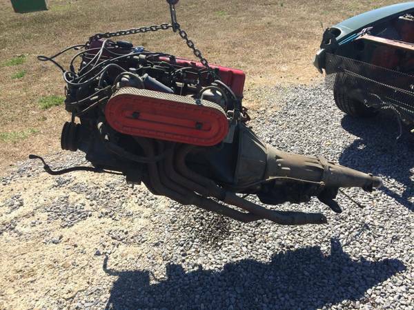

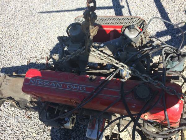

June 16, 20178 yr comment_523240 I can see you have a high performance air cleaner like I had one time. Bought this motor for the carbs. Link to comment https://www.classiczcars.com/forums/topic/57927-removing-emissions-clutter-for-cleaner-look/?&page=2#findComment-523240 Share on other sites More sharing options...
