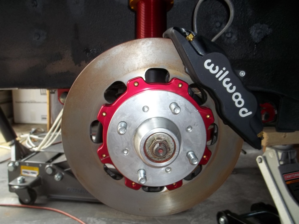

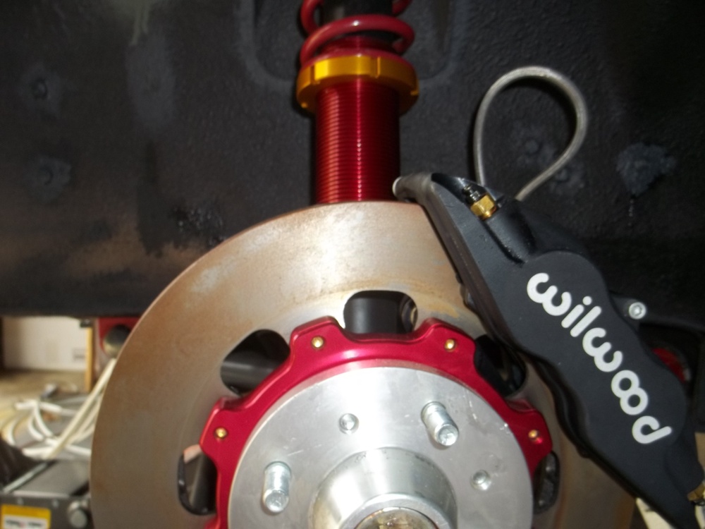

timsz Posted May 7, 2017 Share #1 Posted May 7, 2017 Is the angle of these calipers alright ? I see posts that the bleeders should point straight up. I can take them off to bleed them, so I can get trapped air out. Should they be pointing straight up just for bleeding purposes ? Thank you very much. Link to comment Share on other sites More sharing options...
Chickenman Posted May 7, 2017 Share #2 Posted May 7, 2017 That's just fine. No need to remove for bleeding. With multi-piston calipers, lightly tap the caliper with a Plastic tipped hammer while bleeding. This releases any air bubbles that may be hiding in little nooks and crannies of internal passages. Link to comment Share on other sites More sharing options...
