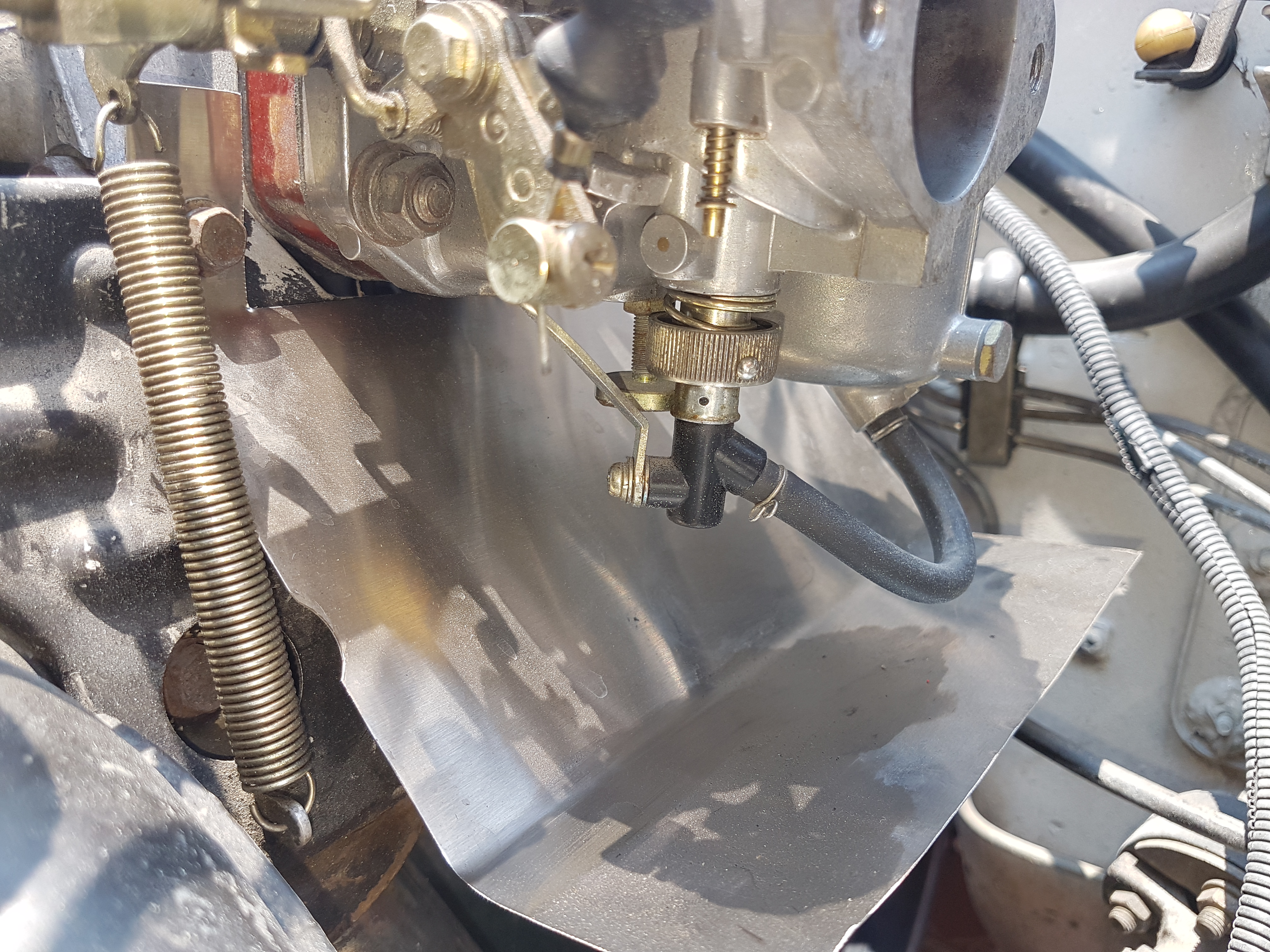

May 25, 20178 yr Author comment_521672 On ‎05‎/‎03‎/‎2017 at 6:51 PM, Mark Maras said:  Curious if there was ANY improvement after bypassing the steel fuel rail? I'm of the opinion that wrapping fuel lines retains heat that comes from the fuel rail mounts, but that's just a theory and probably only part of the problem. Mark, Just got the Thermo-tec Heat barrier adhesive: https://www.amazon.com/Thermo-Tec-13575-Adhesive-Backed-Barrier/dp/B00029KC2K Do you recomend just pasting it on the side of the heat shield extensions that faces the manifold? or should i also paste it on the side that faces the SU CARB fuel bowls? Please advise! I am removing the heat shield extensions today to paste the heat barrier.  Link to comment https://www.classiczcars.com/forums/topic/57633-thermo-tec-products-as-heat-protection-to-avoid-percolation-under-hood/?&page=2#findComment-521672 Share on other sites More sharing options...
May 25, 20178 yr comment_521674 Â I don't know which side would be the most effective. Logically (this has failed me in the past) it seems to me that the reflective side would face the heat source but I would rely on the info and or instructions that came with the shielding product. Let us know which direction you install it and any change that you notice. Â I still have doubts about the two piece heat shield. It seems like it would be more effective if was one piece. You could bridge that gap with a third piece attached with speed nuts and screws. Link to comment https://www.classiczcars.com/forums/topic/57633-thermo-tec-products-as-heat-protection-to-avoid-percolation-under-hood/?&page=2#findComment-521674 Share on other sites More sharing options...

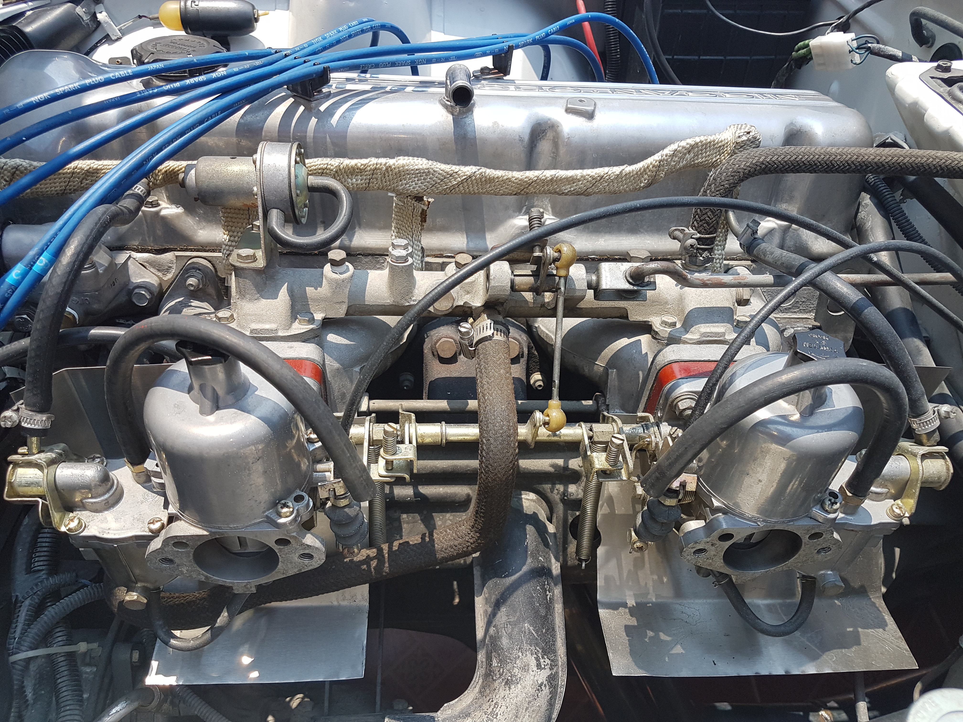

May 25, 20178 yr Author comment_521685 It didnt came with instructions. I guess the side facing the manifold is the one that should be covered. Please be advised that besides these 2 heat shields i have the original stock heat shield covering the center of the manifold. THis guy manufactured my heat shield extensions!! He has great ideas: Â Link to comment https://www.classiczcars.com/forums/topic/57633-thermo-tec-products-as-heat-protection-to-avoid-percolation-under-hood/?&page=2#findComment-521685 Share on other sites More sharing options...
