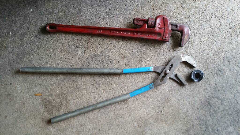

I know this is a well discussed problem but I did come across a fairly easy solution with simple tools for removing a incredibly stuck gland nut without removing strut assembly completely from the car although you will need to remove the top of the shock tower from the wheel well for access. All you need is a 12" (or larger) channel lock with 3" jaws, two 14" (or longer) 1/2" steel cheater tubes, I used EMT conduit, plus a pipe wrench, mine is 18". The channel locks work well as the jaws have deep teeth that will bite into the gland nut edge giving you a good grip where most wrenches just end up rounding the nut corners. The 1/2" conduit fits snugly around the channel lock arms increasing arm length giving much better leverage and the pipe wrench is used around the shock tube housing to hold it in place when you apply pressure to the nut with the locks, I recommend a helper to hold the pipe wrench so the shock housing does not move or twist. Once you have the locks in place with teeth pressed into the nut edge, push, push hard while holding the tube in place and the nut should release. For more leverage you can use longer 1/2" cheater tubes. It also helps to have a jack underneath the shock assembly to keep it from moving down when turning with the locks. Hope this helps...

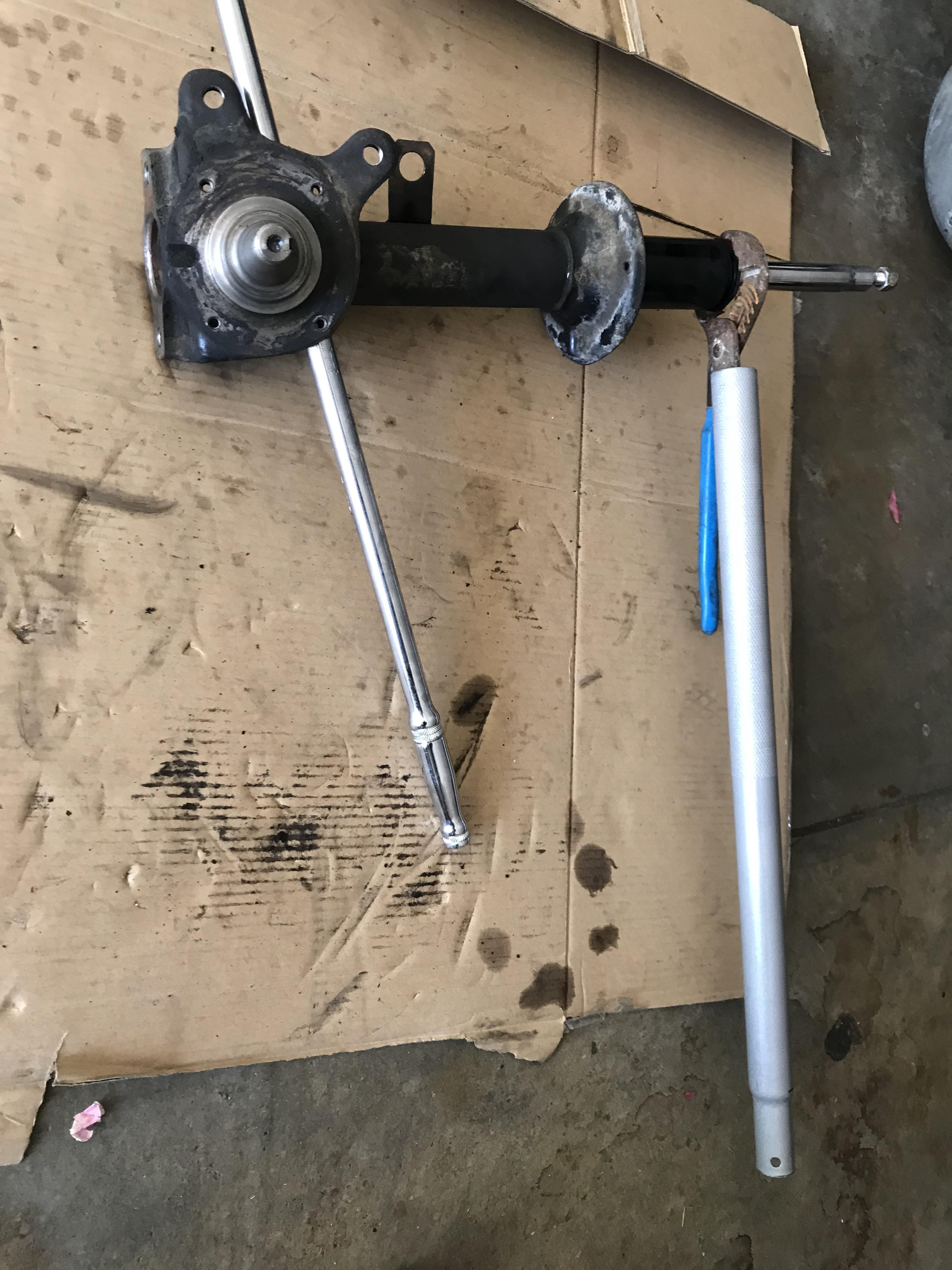

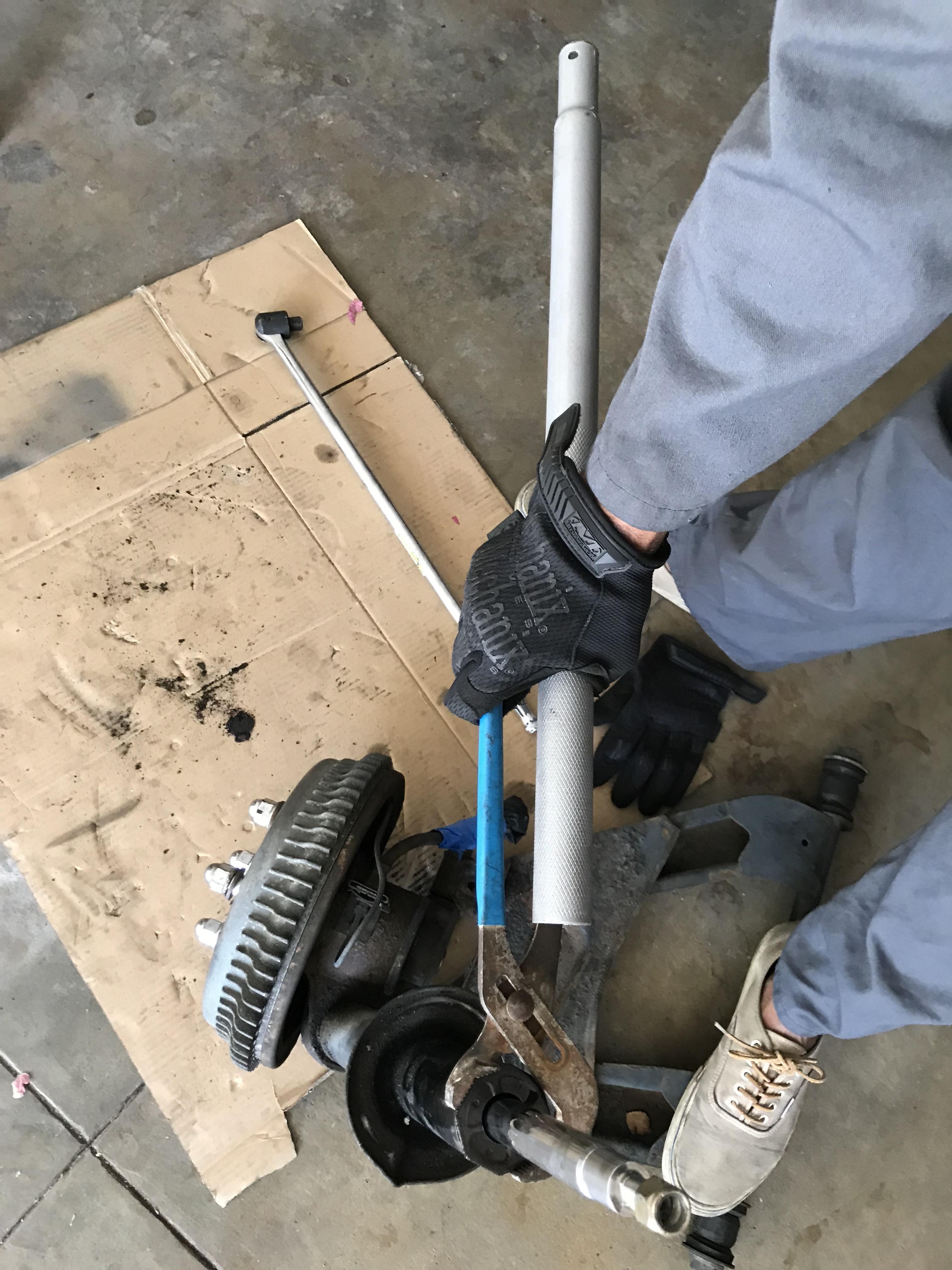

I ended up stumbling upon a very similar solution and just want to share some pictures in case it helps anyone. I used Channelock pliers with my jack's handle as a cheater tube and my breaker bar to keep the front struts from spinning.
I also didn't know this before, but Channelock pliers are directional and lock down more when force is applied (video).
