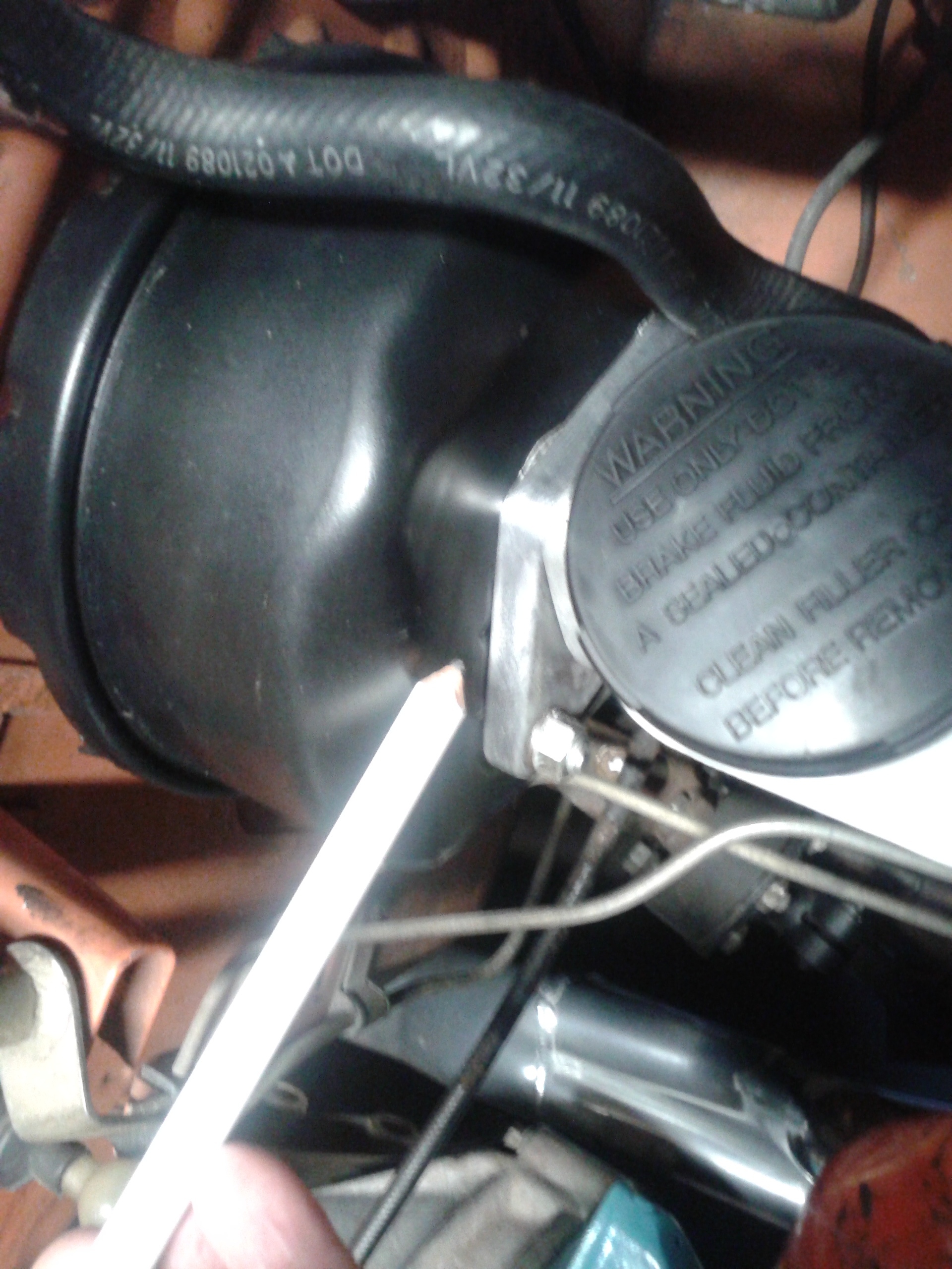

From what I read beforehand, the vent was to keep the pressure from building up inside the booster's hole.  My backing plate had a small gap at the bottom, booster side, and leaked fluid from there but the booster's hole was dry.  So I don't know what to think about the difference in mine and your's Captain but I damn sure won't be rotating that booster.  That was a HUUUUGE pain in the rectum.  I'll go look at my 280's position later this morning, it's original to the car, and let you know.
The sealer was there from Nissan so I put it back.  I wasn't thinking theories and logic, I'm a worker bee. ;)
I just thought of something, my booster has one way to mount because of the vacuum hose, so it's right.  More questions than answers but the clock says 0:00 and the confetti has fallen.1487361136266.jpg

As for the o-clock positioning of the vent, I was remembering incorrectly and talking earlier as though the vent passage was in the aluminum spacer, and it's not. My vent passage is not in the aluminum spacer, but is stamped into the booster clamshell. Mine points right at the vacuum hose connection which is in the same place as the one in your pic (mine's a 77).
So the bottom line is that my vent hole is at maybe 4:00?

Captain Obvious the 240 is at 11 o'clock.  280 is 4 o'clock like your's.
