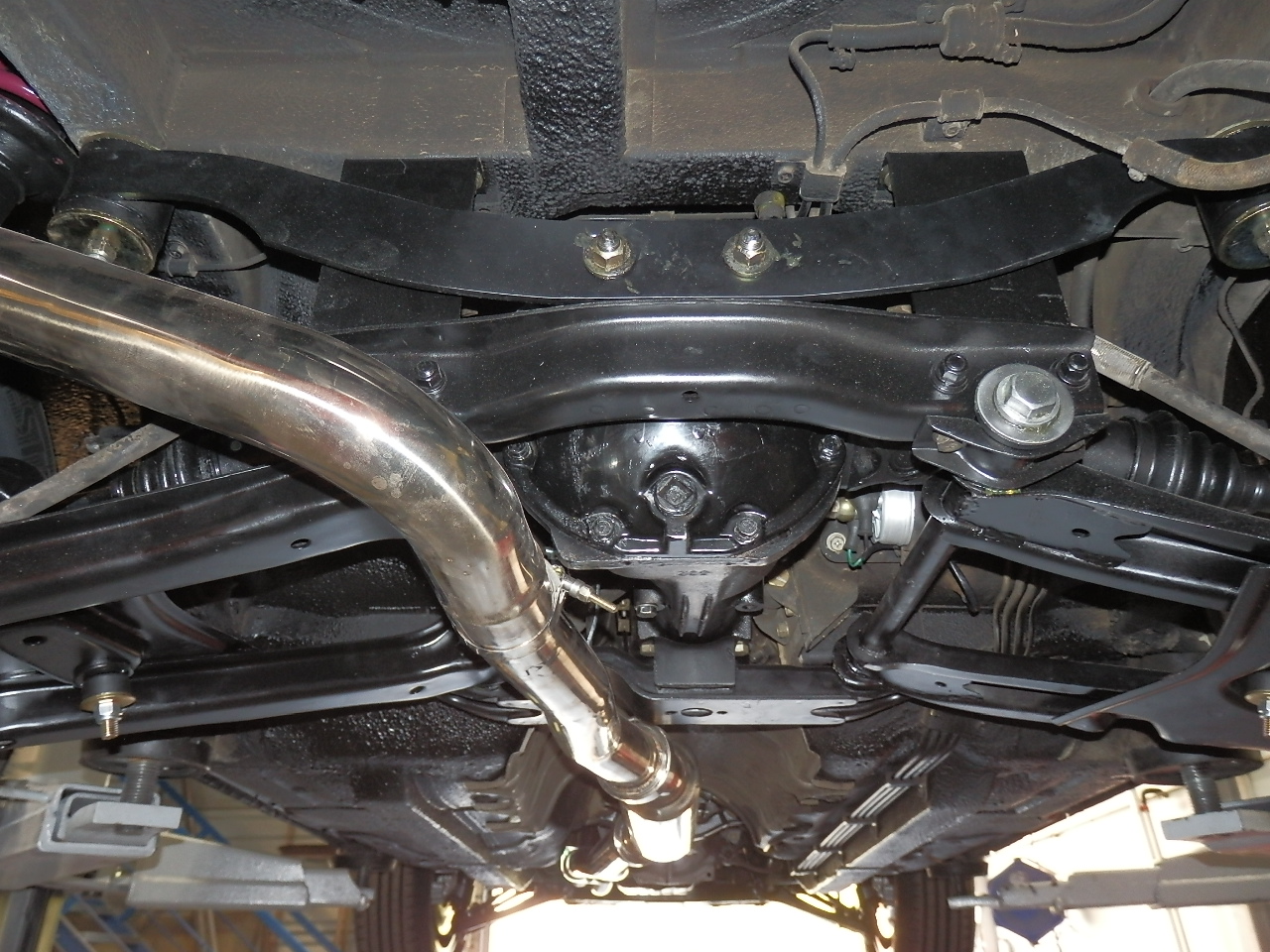

I'm not missing the point Alan - you're not clearly stating to whom you're replying : Dreamzz has a 280Z so any image of a stock JDM S30 exhaust isn't relevant and Fujitsubo revised their twin exhaust system to avoid the negative comments of it hanging too low (ie well under the small U shape*) amist the trend of lowering Zs....although frankly, I'd have thought they'd have done that years ago as we've been lowering them since the year dot !
*image of mine through it....on a 280Z.

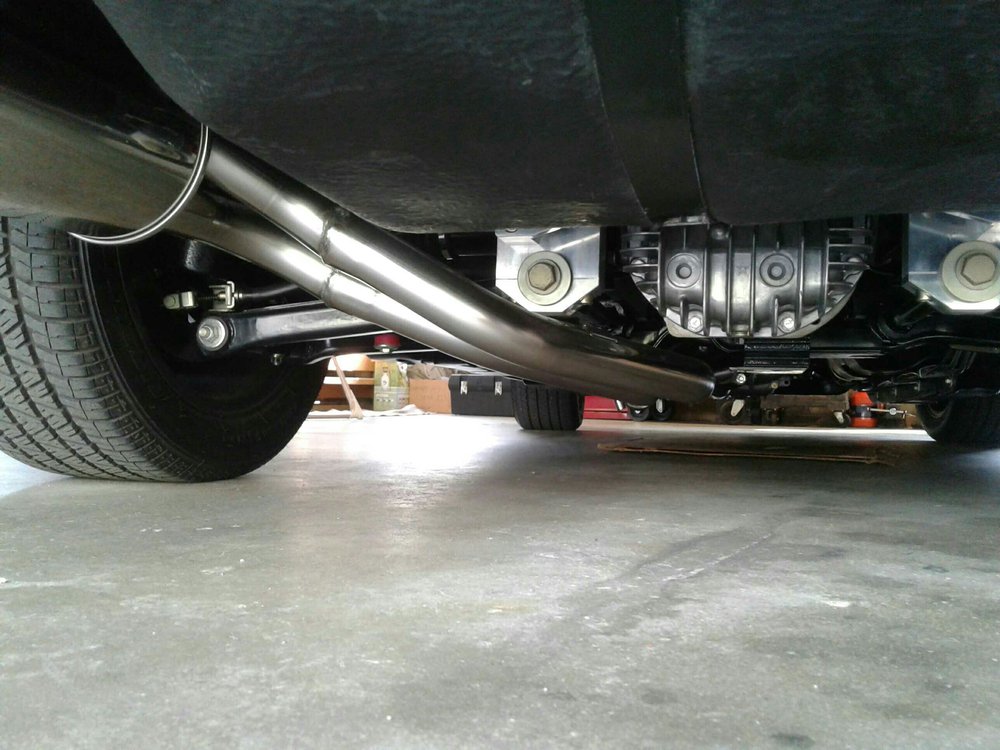

Just went to garage and took picture of how I fit the fujitsubo legalis system to my 75 280z with an R200 LSD. My car is what I and most would consider a resto mod. I have and will continue to have to customize things as I did when I chose an electronic direct fire ignition. Actions have reactions. I posted so others wouldn't expect a "plug and play" if they chose to go this route.
Sent from my SM-T377V using Classic Zcar Club mobile
