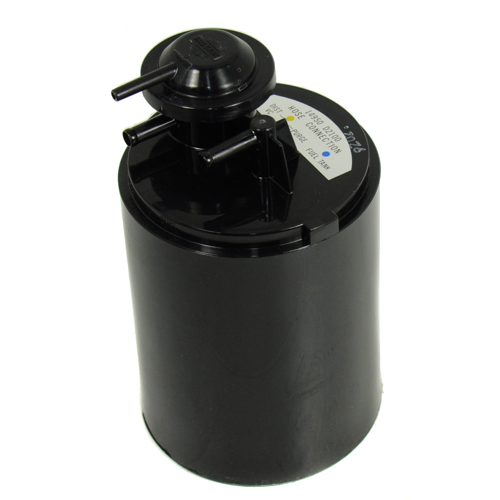

I am thinking of relocating a smaller canister (from a Sentra maybe) up to the firewall. I will have a fuel return line after the FPR so that's not a problem...
About the charcoal can... They use a ported vacuum source to actuate the canister purge.
They don't want to pull air through the can at idle, or at WOT as it is essentially a controlled "vacuum leak" and could adversely affect stability at idle and performance at WOT. The only time they purge the can is at light cruise.
So... With all the changes you're making, are you planning to still have access to a suitable ported vacuum source peaking at light cruise?
As long as it is plumbed the same as the stock can, I thought it would work the same. The can posted above seems to be actuated the same as the stock can...
Bottom line is I want it gone from the front of the engine bay so I can clean up the fuel lines. Venting the gas tank evap line to the filler neck will allow the tank to fill properly but not vent when capped. A relocated evap can down by the fuel pump seems to be another possible solution. Close off the engine side of the evap and vent the tank under the car. Yes, I will be losing some gas vapour that won't be going through the intake but I'm not going to lose sleep over that. Thoughts?
Sorry, but I'm not sure I'm understanding... You are correct that as long as it's plumbed the same as the stock can, then that Sentra can should work just fine. You need three connections to the carb can. A vapor IN connection, a vapor OUT connection, and a CONTROL signal connection.

So if I understand correctly.... I can relocate the can under the chassis by the fuel pump IF the vapour tank is kept in place and the vacuum line is still connected to the throttle body. The can will "vent" under cruise and I can dump to atmosphere under the car. So I would need a vacuum line to the back of the car. Basically keep the hard line at the firewall to go back to the can....
Based on my understanding of the system, I believe you nailed it.
Needing that vacuum line at the back of the car kinda negates some of the advantages of moving the can though, doesn't it?
Not really I suppose because there is already a hard line there that was going from the vapour can to the charcoal can. I will just route the hard line farther up the firewall to a place where I can run vacuum to the throttle body.
