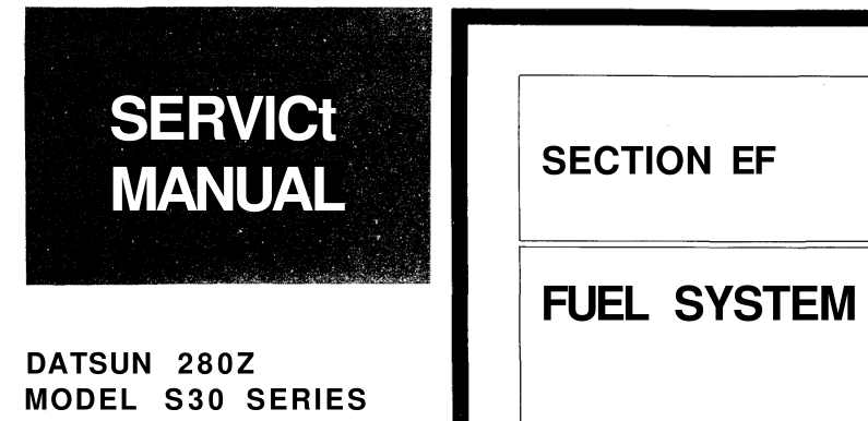

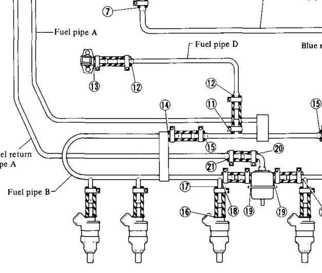

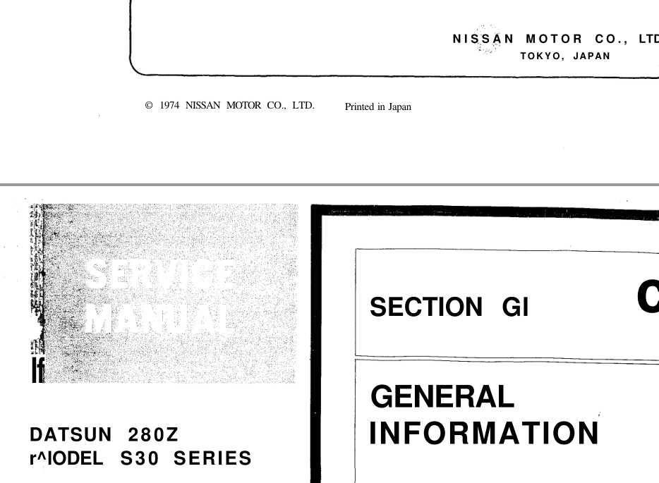

Do you have a picture of the FSM image showing the rubber only?  I can't find it.  Also just realized that the commonly available electronic 1975 FSM appears to actually be the 1976 FSM.  The actual 1975 FSM seems very crude, with misspellings.
The 76 image shows a separate pipe that could easily be transplanted from a 76 to a 75, if they did start with a long rubber hose.  My impression of their system is that they only used very short pieces of rubber to connect metal tube, over the manifolds.

So you think the idea as to minimize the use of rubber (therefore rupture possible with fuel leakage) around the hot exhaust manifold? Perhaps one of the reasons they went with the solid hard line fuel rail later (vs the two section connected with hose).
