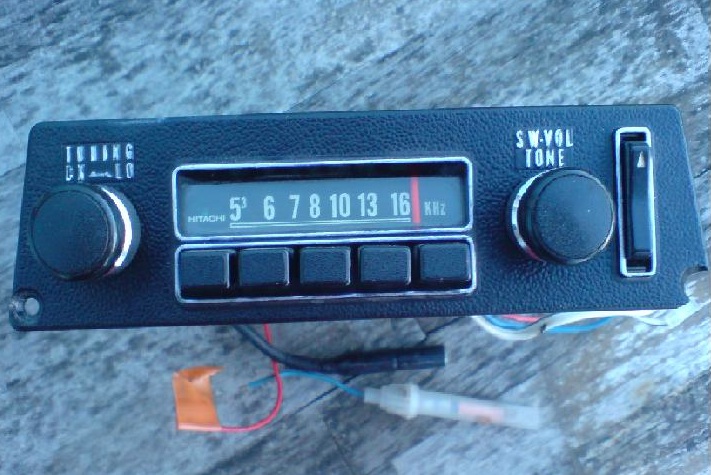

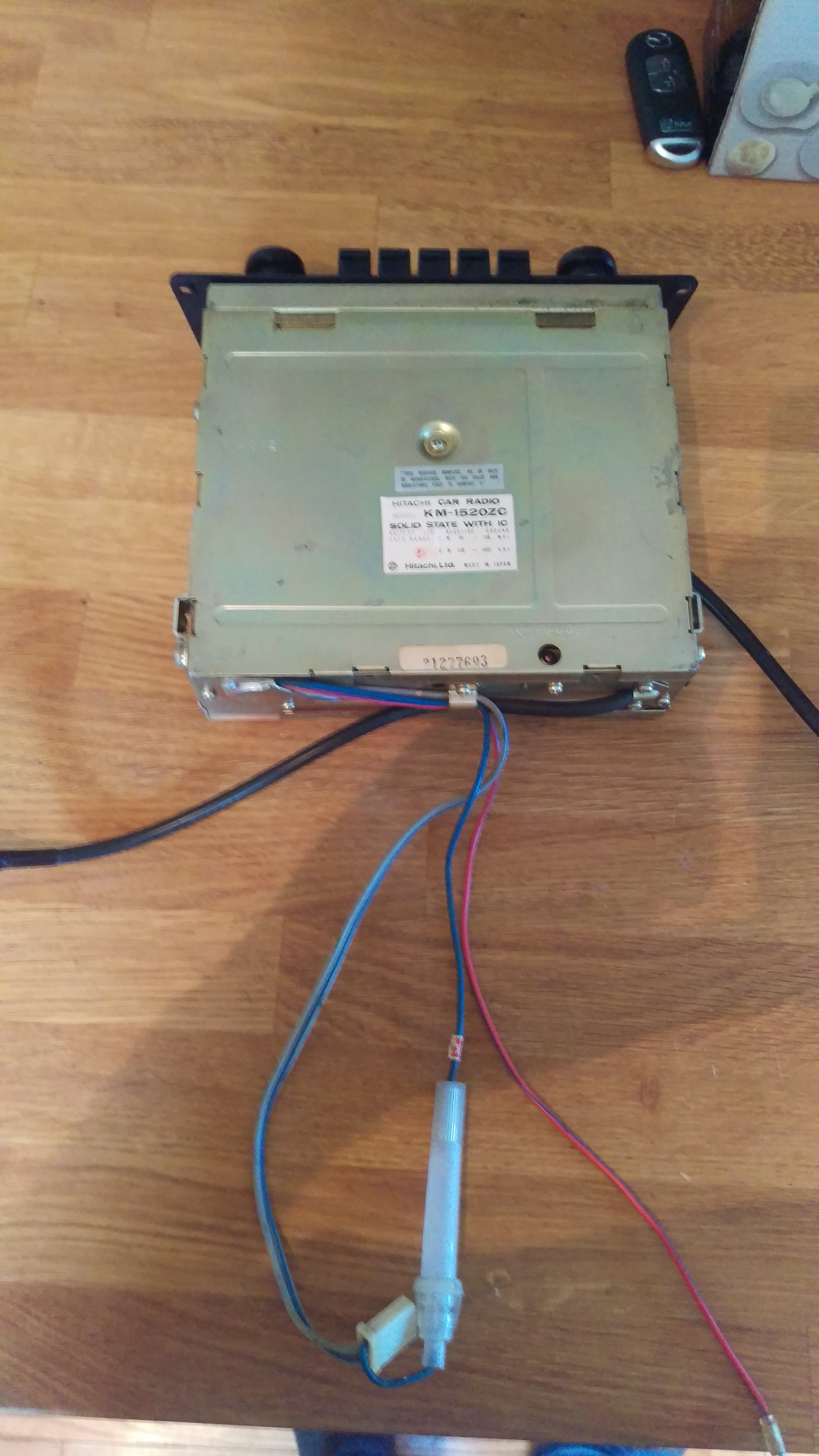

Hello,
My original radio is missing the guts to the inline fuse holder (blue wire). Does anyone know where I can get all of the guts for the fuse holder? This would include the fuse as well as the coil noise suppressor.
Much appreciated.

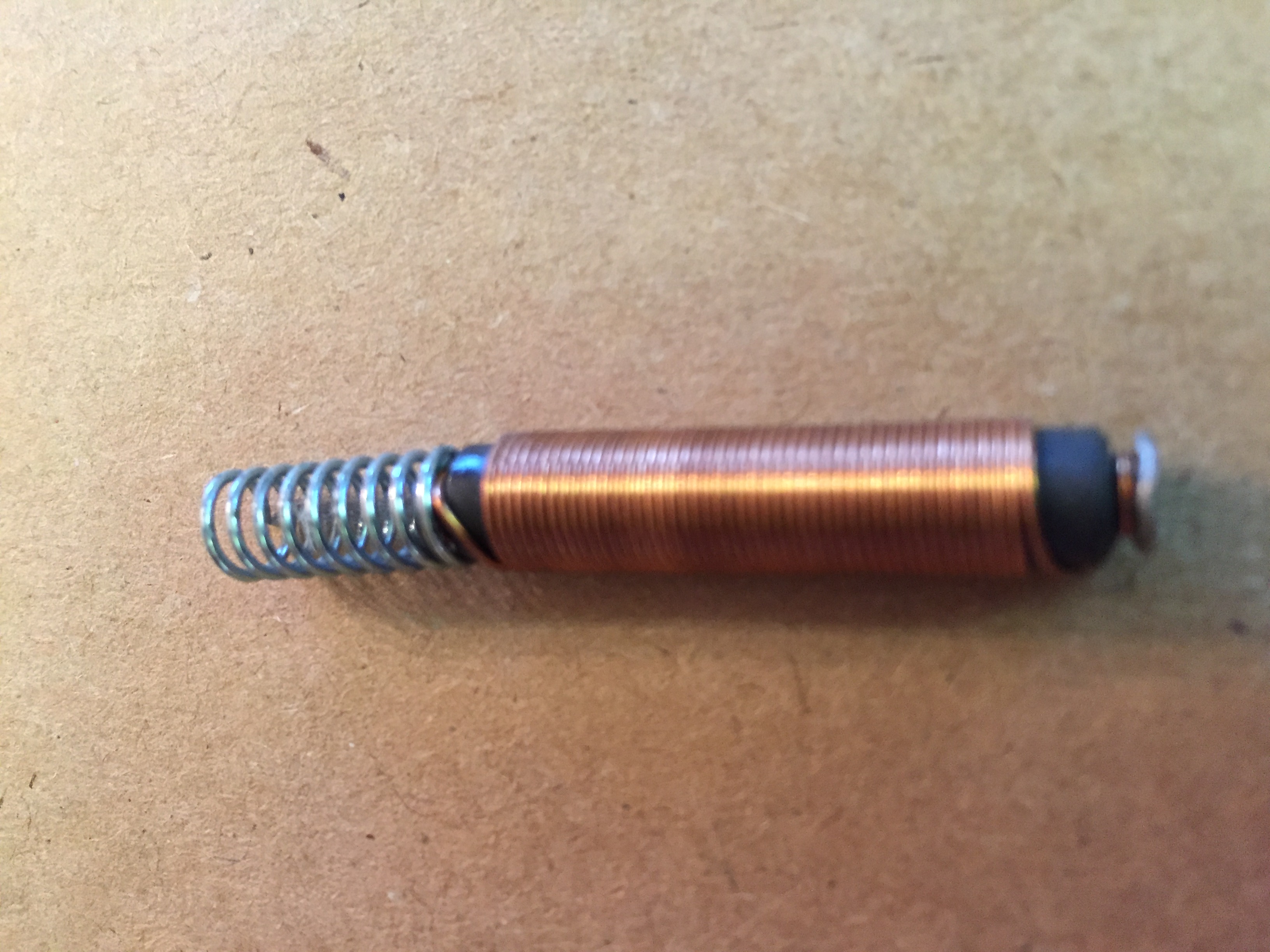

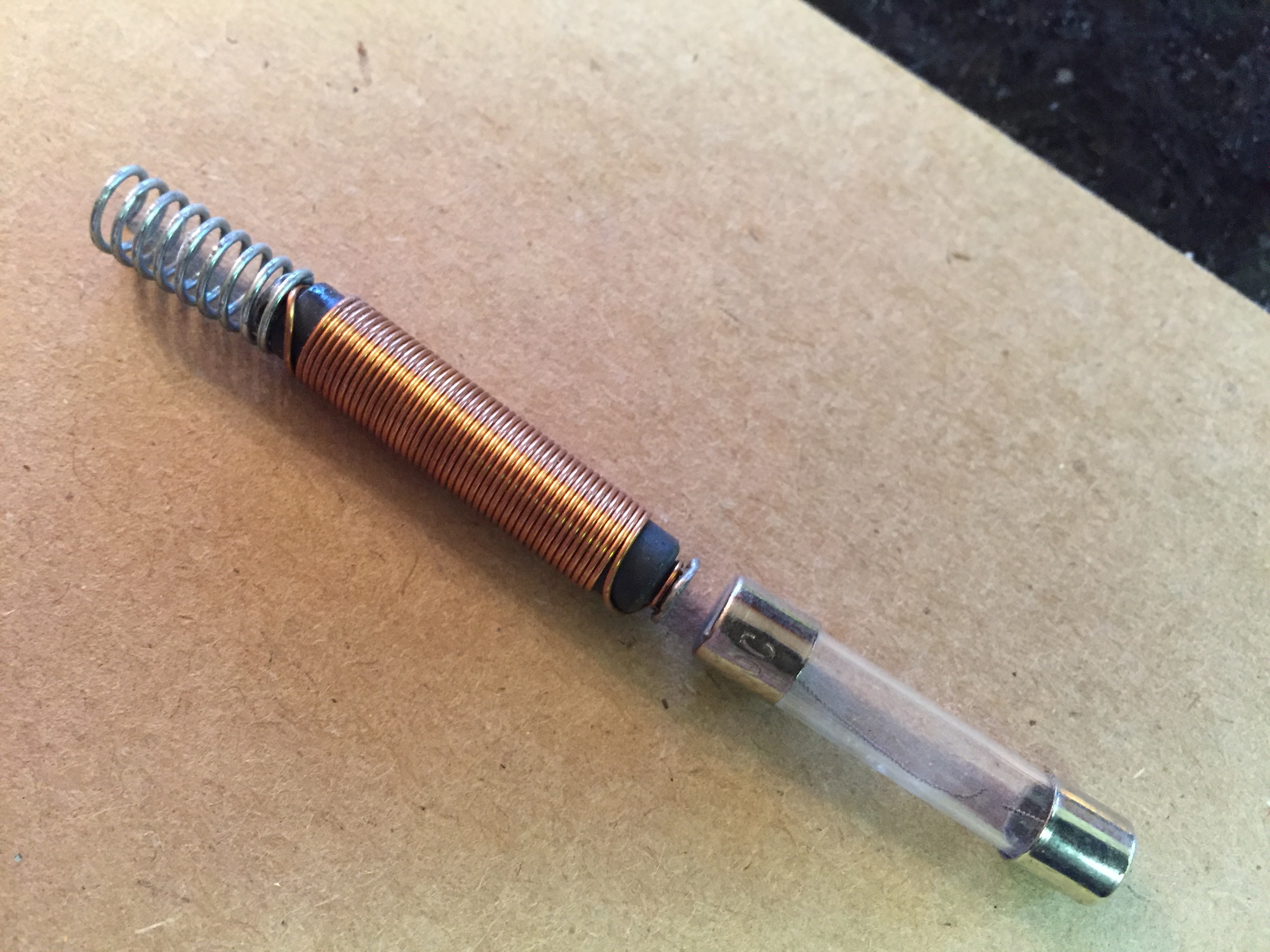

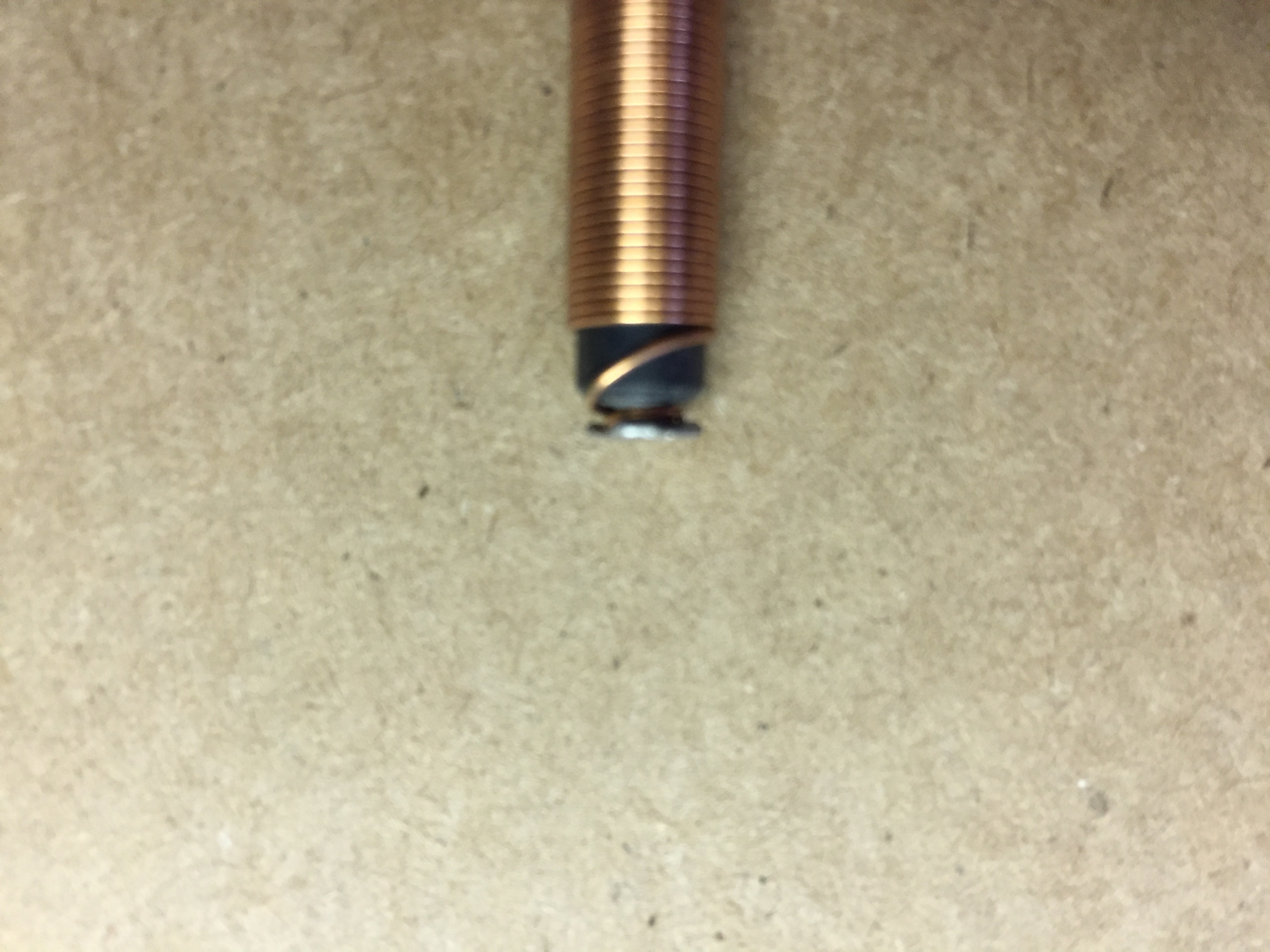

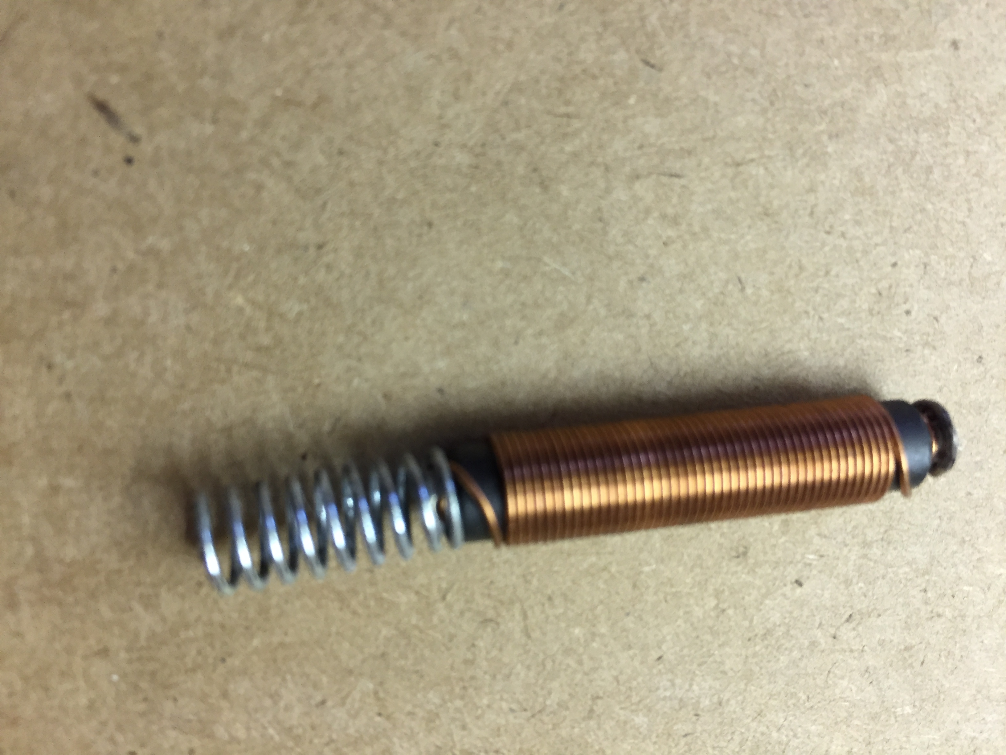

Here are a few pictures of the coil and fuse for reference. I can take measurements of various bits if that helps.
That's a 2A fuse BTW.
The coil seems to be a nail-like core, with a black insulating cover, then coils of copper wire connected to the nail head and spring to electrically connect it through.

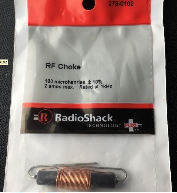

Great pictures of the RF choke coil, I can even count the turns of the coil.  Someday if I can borrow one of those coils I can measure the uHy inductance so a new one can be purchased or made or somebody else could measure it.  Here is an RF choke on eBay that would reduce interference and is rated at 2A but it might have less inductance than the 240Z choke meaning it might not work as well.  It might be small enough to be mounted inside a fuse holder can't tell.
Actually, the black part is the core, typically called a "ferrite core". It isn't a good conductor of electricity, but it is much better at conduction magnetic lines than air.
The metal end rivet looking headed things just to make electrical connections to the wire. I don't know how deep they go, but I can guarantee that they don't go all the way from one end to the other. Think about it... If there was a conductive nail right through the middle of that thing, then the coil on the outside would be dead shorted out and would be superfluous.
