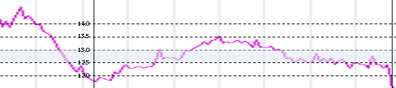

Took a couple of logs tonight...first one was down an entrance ramp. Second one was a flat entrance onto highway and engine was more up at temp.  The setup? F16 155/185
30087302688_79b4e6bff9_o.jpg8918-1 by blodi, on Flickr
42147405690_5e36417ed4_o.jpg8918-2 by blodi, on Flickr

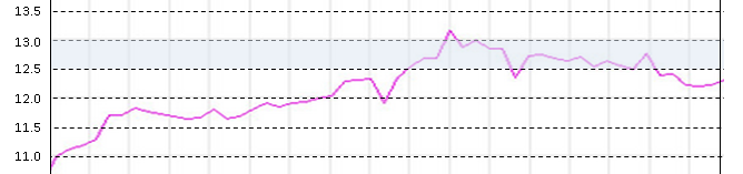

Here is your F16 155/185 flat run from last night.

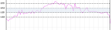

Here is the next previous F16 155/185

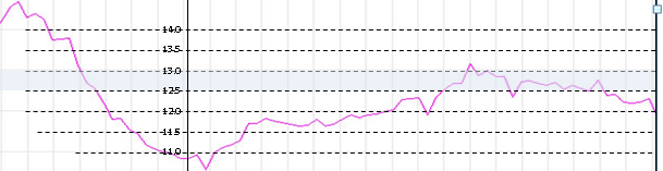

Here is your very first run with F16 155/185 and 34mm choke from last October
My thoughts:
  • There is some variation due to the time being the x axis  rather than rpm  however the same max/min signature is seen.
  • It seems this combination of  155/185 gives nice results with F16 Etube.
  • A main jet in the 165 to 150 range seems to be where to hover.
  • We were unable to change the high rpm tilt/drop off by opening the air corrector. When we tried, it leaned too much elsewhere.
  • We were unable to change the low dip when the accelerator circuit kicks in.
  • Due to the two items above, all of the runs had a lean hump in the middle for which the edges could not be modified to meet nor could we beat down this lean hump.
  • The very low dip into the 10's and 11's when the main circuit kicks in is always present. It is independent of emulsion tubes, acceleration jets, bleed back valve, or fuel level. This gorilla in the room seems to be due to the 45mm carb as it appears in many other 45 applications that are not L28's.  I think the only way to deal with it will be modifying E tube tops.

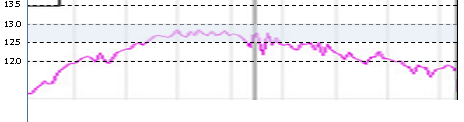

  • Of all the runs, the F16 165/215 seemed to have the least dip at the start of the run. This may be the best compromise. Here it is:

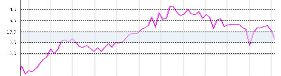

  • And here is your F16 155/185 run from last night where it dips below 11:
