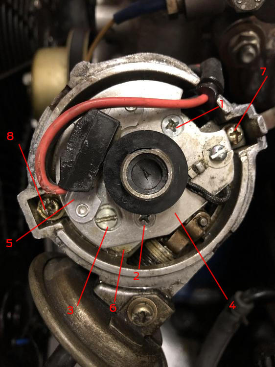

All good points....I'll inspect tonight.  Any idea on the gap setting? I just installed a pertronix like a month ago on another car of mine, but probably didn't save the little clear "feeler gauge" they send with it.
Edited by blodi
Ok. So the sensor to rotor gap is tiny...less than half what it should be. I see no way of adjusting it either on this setup.  The two counter sunk screws hold the pertronix into position and there is nothing slotted to allow adjustment.  I can just use one of the screws and that way angle it to adjust the gap.
Yeah, but the two other countersunk screws prevent the plate from moving at all. Its' fixed in position by those two. I removed one of them and adjusted the gap. I'll see how it runs Friday as I'm bring the car in for a car show here at work.
The screw is actually an eccentric and pushes the pick-up out. Give it a twirl with a flat head screw driver and it will immediately make sense ?
OK, I marked this up so its a bit more clear...
48307421396_bd2acf88a4_b.jpgDizzy by blodi, on Flickr
1 and 2 hold the pertronix plate (4) to the dizzy plate (6) and it cannot move around from there. I can move 3 around a bit, but it can't move 4 at all. 5 is fixed to 4 with rivets. 7 and 8 both did need to be snugged down a bit.  What I did last night is removed 1, adjusted the gap and tightened down 2.  Not sure if it will hold in position with just #2 in place, but it allowed me to open the gap.
